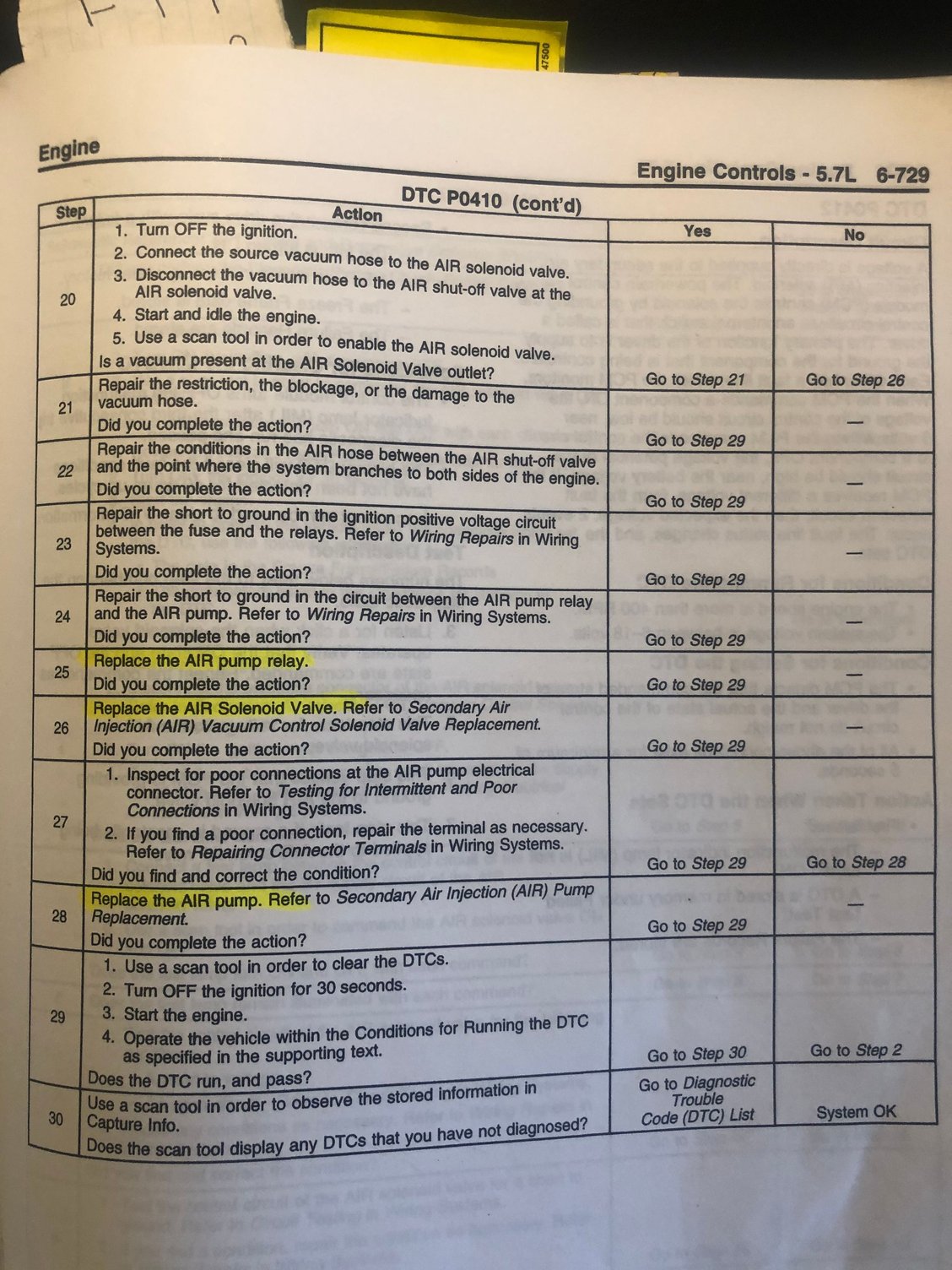

This is out of the FSM for my ‘01...DVOM, bidirectional scan tool,12 volt test light
and a Mityvac (for vacuum testing) is what’s really needed for an accurate diagnosis !!
