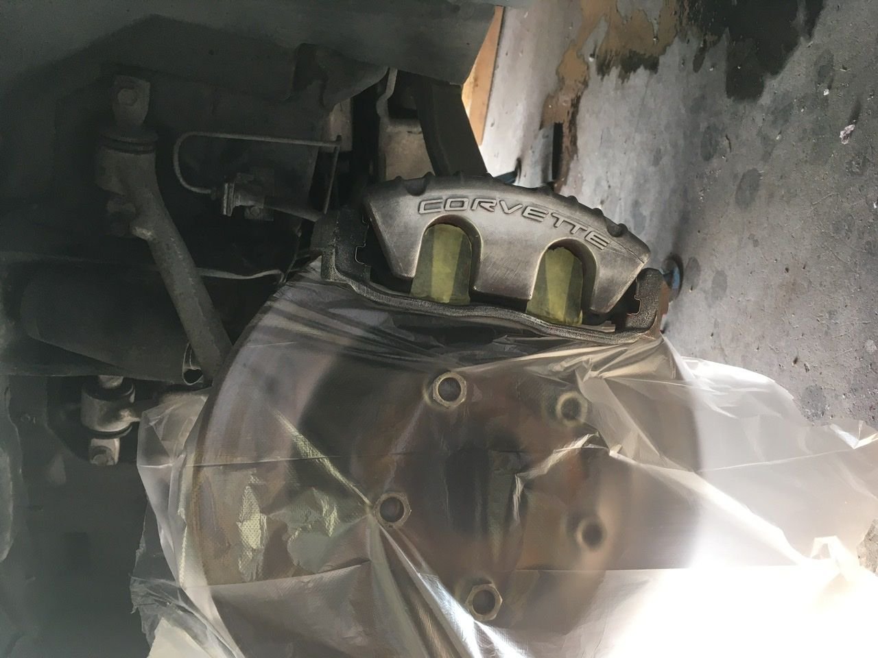

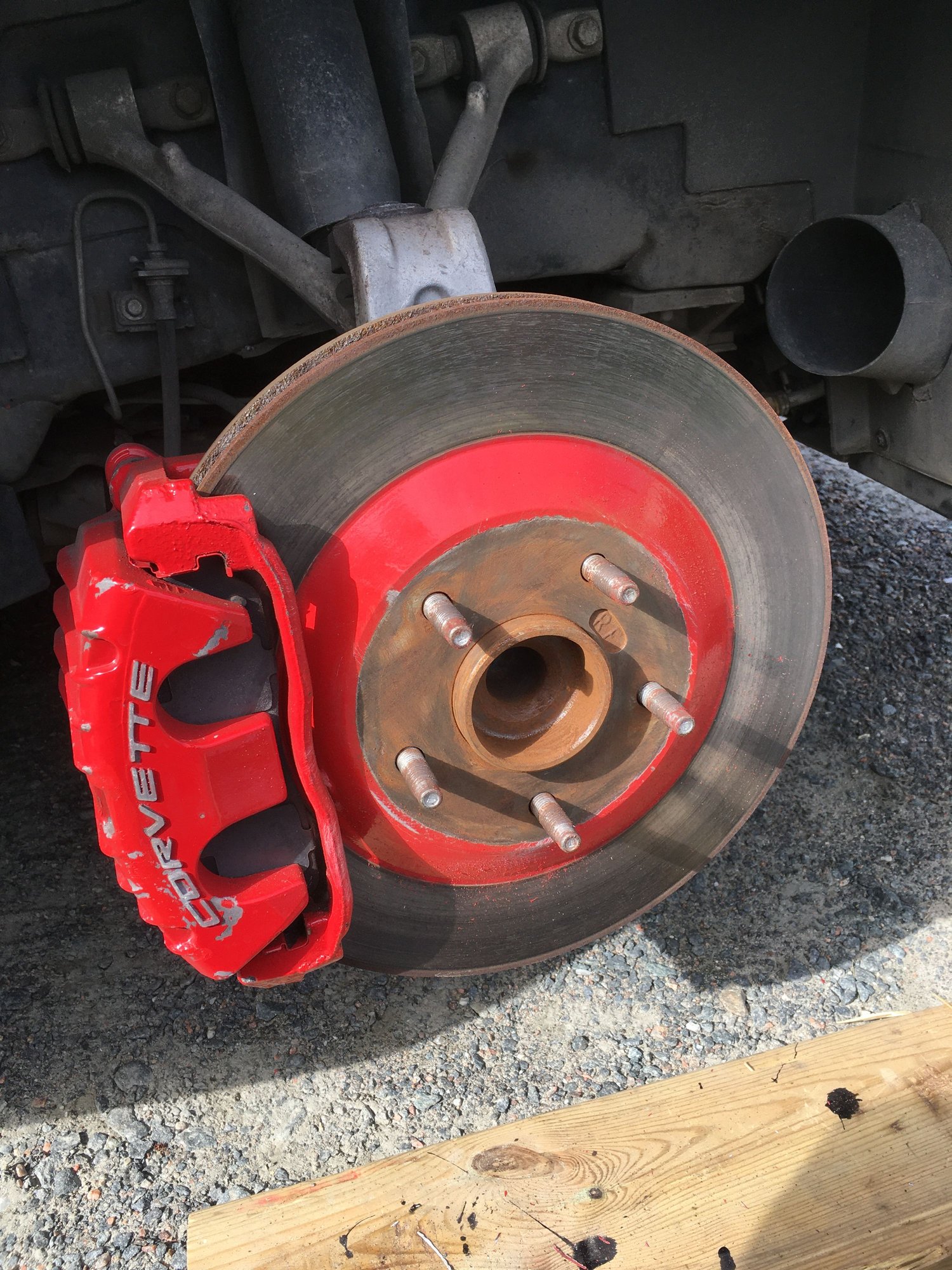

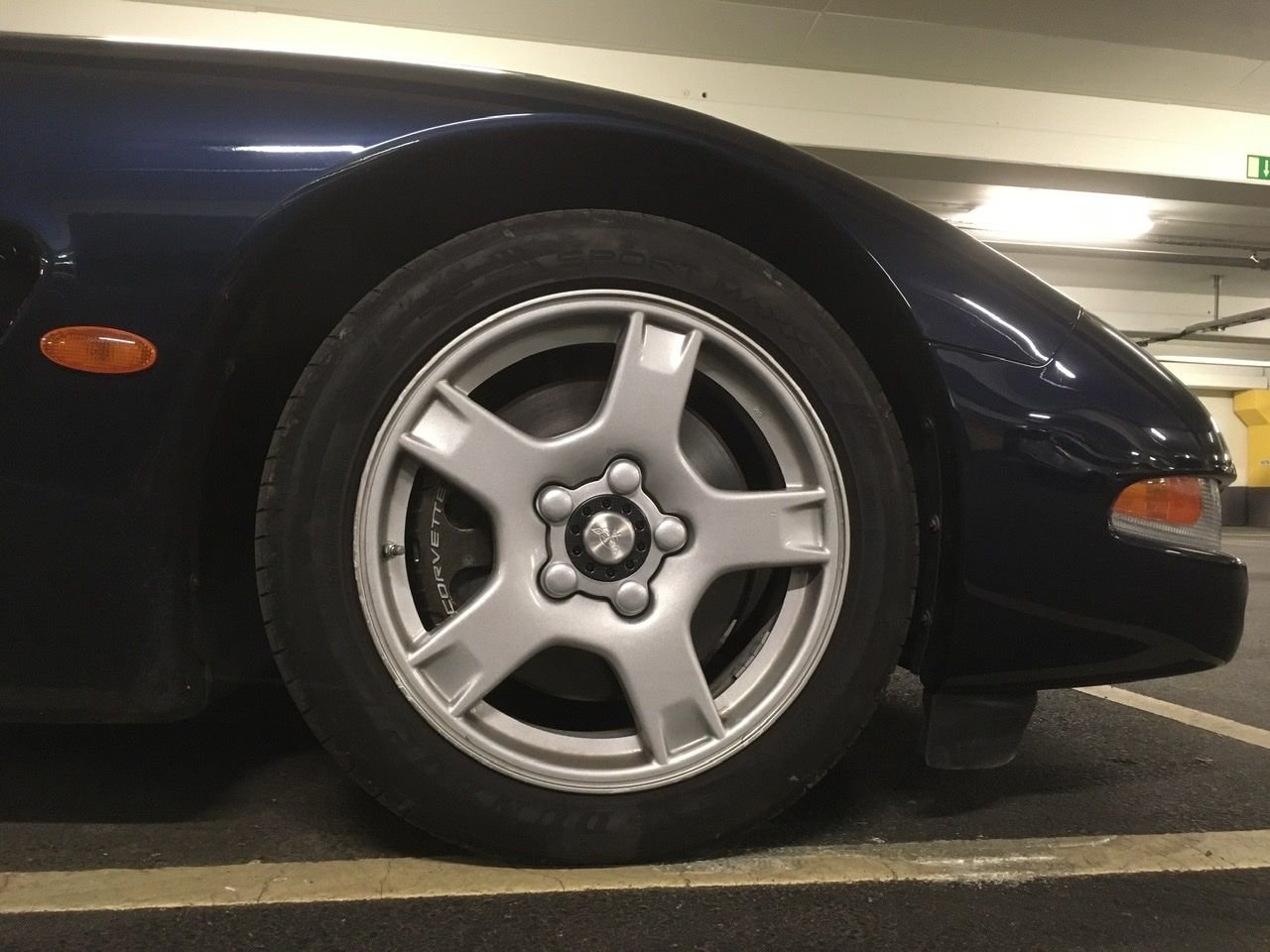

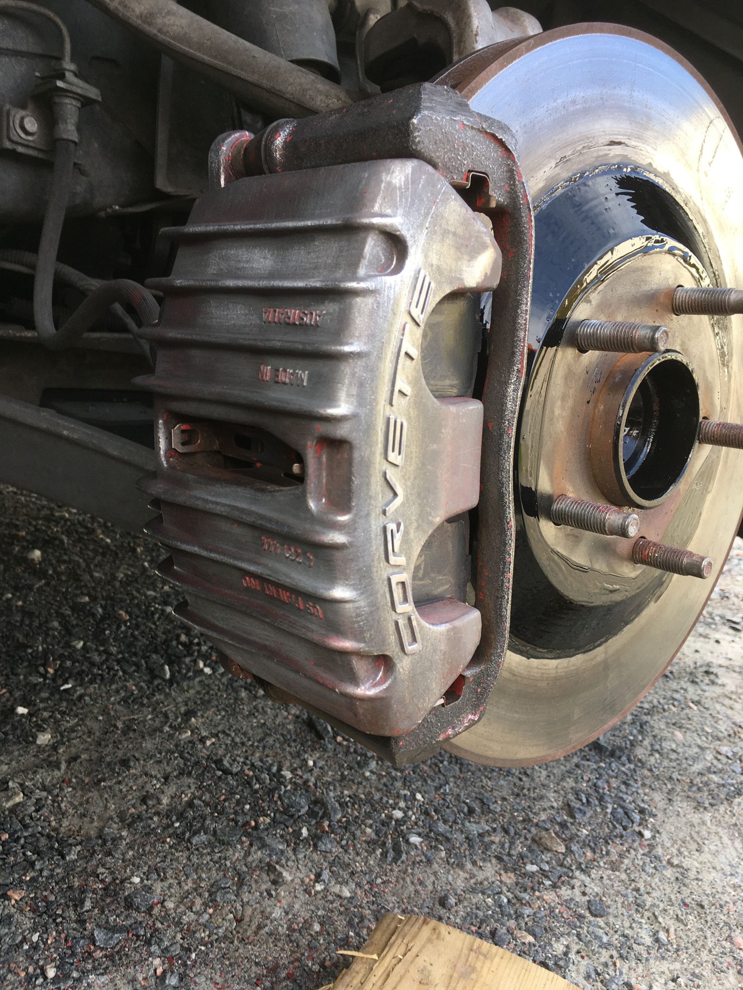

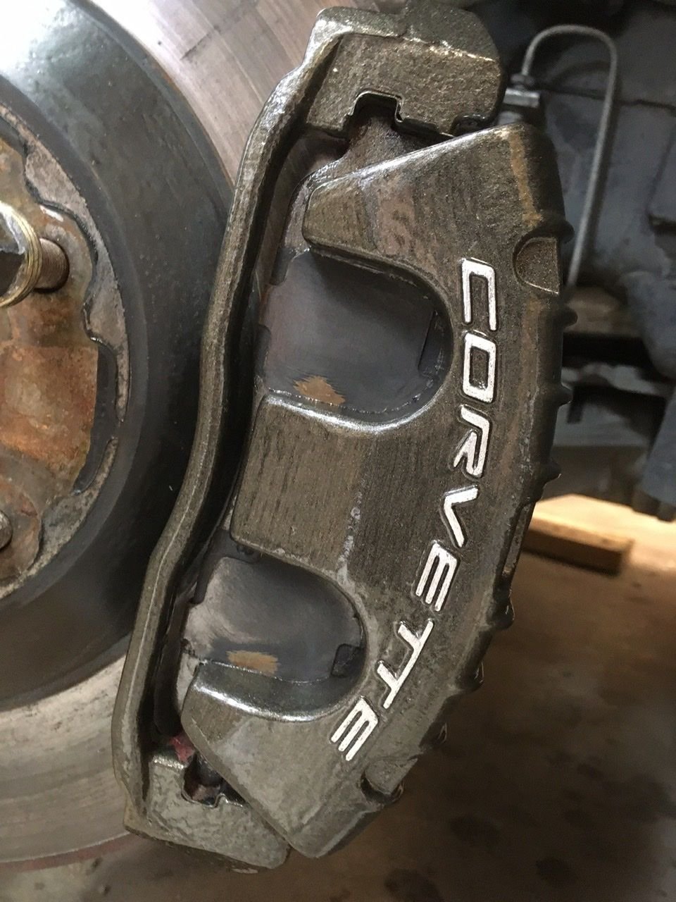

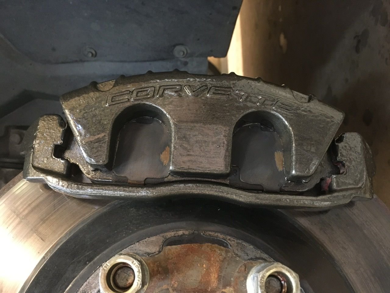

The longest work....take out the previous red paint...
Before
After
then you need to lift the car and clean out everything thoroughly with brake cleaner and brush....the car is lifted because I had one pot of high temp epoxy paint 2 components, so need to paint everything in 2-3h paint pot life time.
Protected
After 2K paint
Once "corvette" cleaned, scraped with utility knife
I use foliatec https://www.foliatec.com/shop/en/rim...er-lacquer-set
