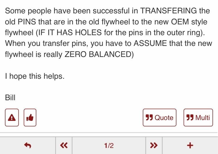

If you don’t like advice from young people, maybe follow the advice of your elders such as Bill Curlee.
Fyi, ALL GM clutch assemblies are zero balanced from the manufacturer whether you buy from gm parts direct or LUK.
This info should have also been included in the video since some of you are looking for the “facts.”
Source: https://www.corvetteforum.com/forums...driveline.html
post #7.
