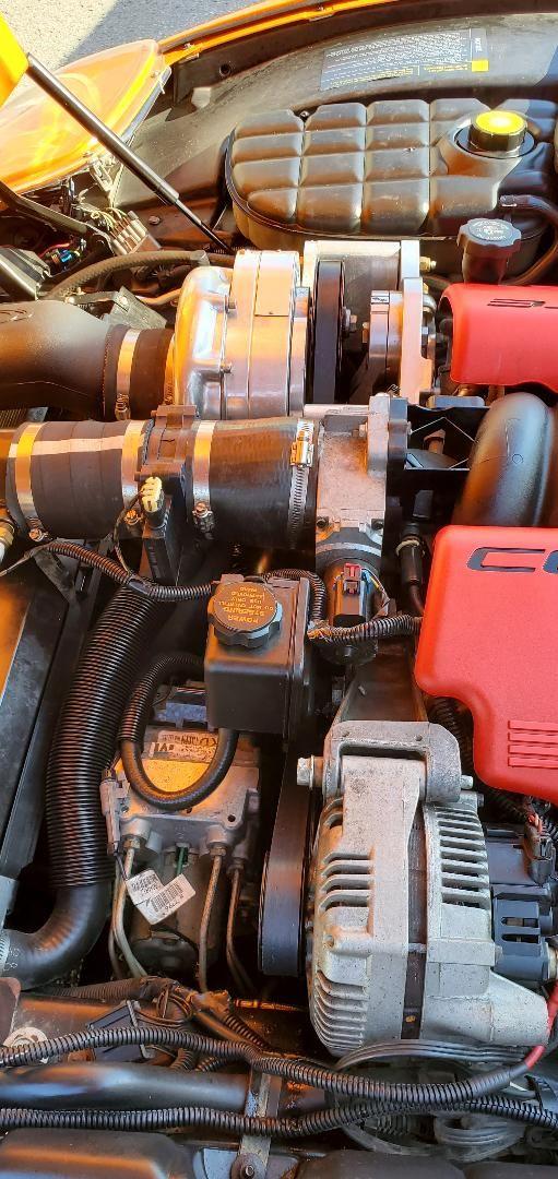

Can someone tell me what this is? My previous 98 doesn't have it, but this one does........The module right in front of the alternator.
Lines come off of the master and to this.......ABS??

It is the ABS module or as it is known EBCM.
Mid year 98 there was a running change that moved it from the rear cradle to in front forward of the alternator.

Yes EBCM controls tcs/abs
