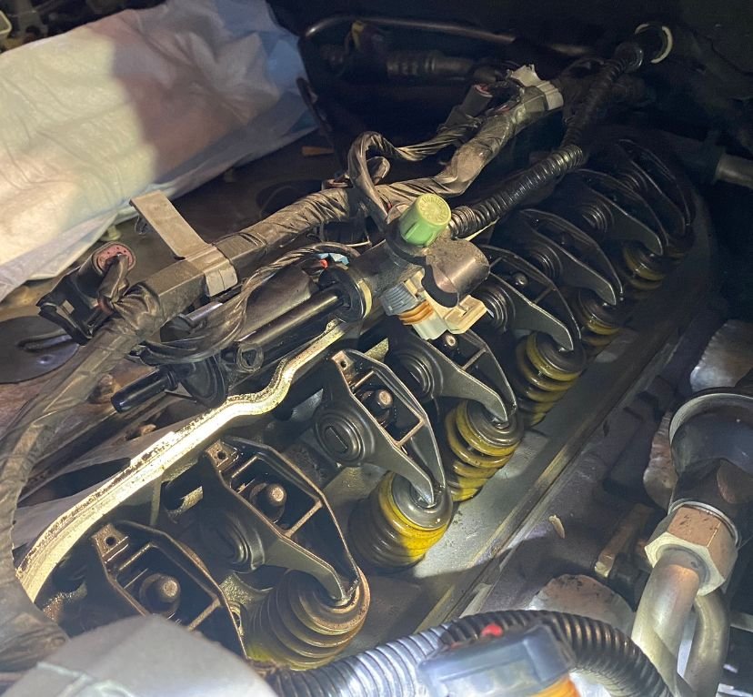

Drivers side intake valve cylinder #3 dropped during some maintenance work, dropped by about 1 inch(intake manifold is off the car) and I can see the rocker arm pressed downward. What’s the best way to go about lifting the intake valve while the head is still attached to the block. Any help would be great!

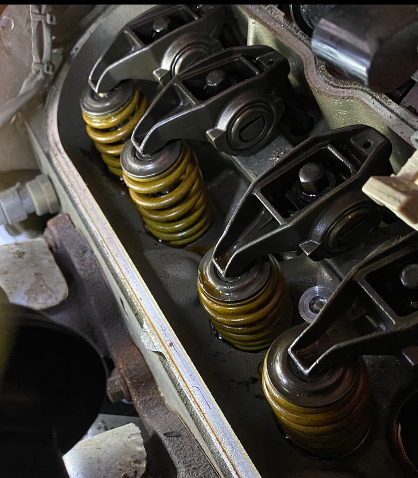

is it possible the intake valve on cylinder #3 is perfectly normal? I noticed all the other intake valves are sealed closed but the intake valve in cylinder #3 is open. I noticed the intake valve to be open after I vacuumed the port during some maintenance work. In the pictures shown you can see the valve spring is compressed by rocker #3 and intake valve is in the open position. Don’t want to bolt on the manifold and fire up the car and possibly have a valve issue.

Why do you think the valve shouldn't be open? That's what valves do, they open and close. If your worried you can turn the engine by hand and watch if the valve opens and then closes. If you continue to turn the engine another valve will open and close. If it's working just start it up, it will be fine.

Looks fine to me. Agree on post that says "that's what valves do".

OIf it was me i would turn the engine, Not crank turn by hand with tool. The valve will move there is nothing wrong here. If there is speedy007 will by you dinner.

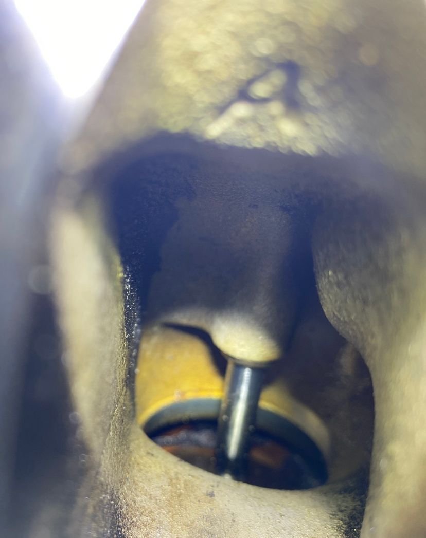

I'll toss this into the mix, "just because". In one of the pictures that "demon" posted, it does look like there's a fair amount of carbot in that valve that's open. Anybody think that maybe a chunk of carbon is stuck on the valve seat, keeping the valve partially open?

I hope so, definitely did freak out after seeing the valve in the open position. I know that valves open and close but I could of swore it was in the closed position prior.
thanks to everyone for the advice. I ended up turning
the engine over by hand and everything was working properly.
