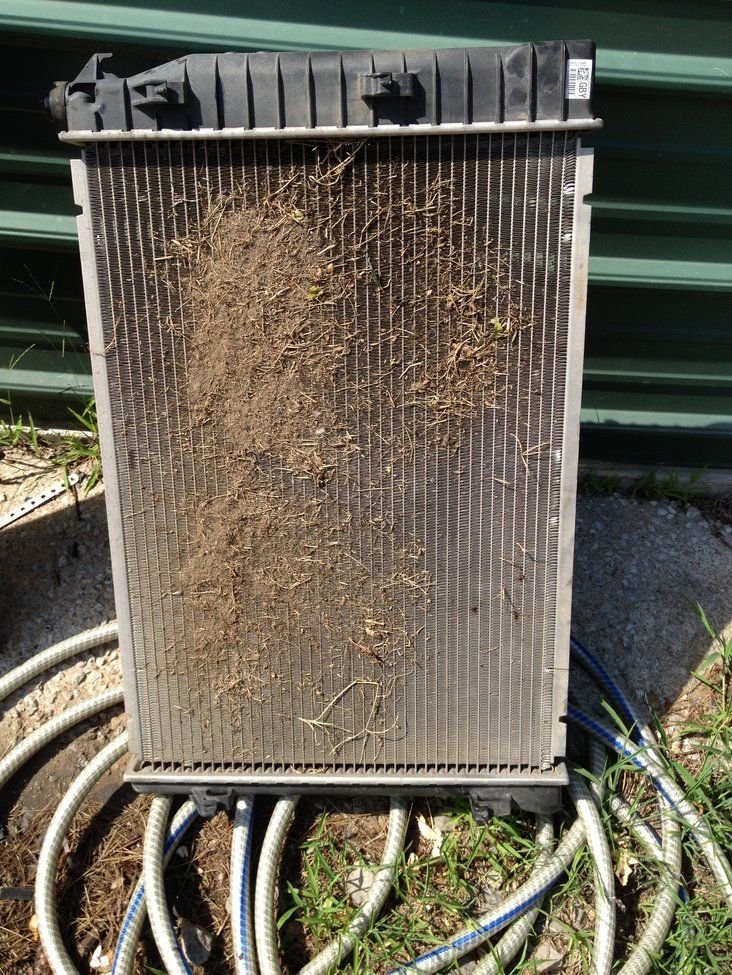

How many miles on the car? I had to have my radiator replaced at ~150K. In my experience, C4's and C5's are bad about clogging up the radiator over time with dirt, rocks, candy wrappers, grass... and reduce the cooling ability.
That's just been my experience with it. Good luck.

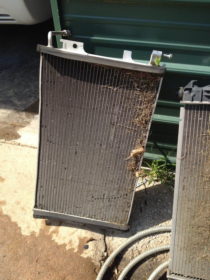

Carlos, one thing to do is check the area in front of the radiator, the area between the radiator and the A/C condenser in particular. This area is known for gathering all sorts of road debris.
Good luck... GUSTO
