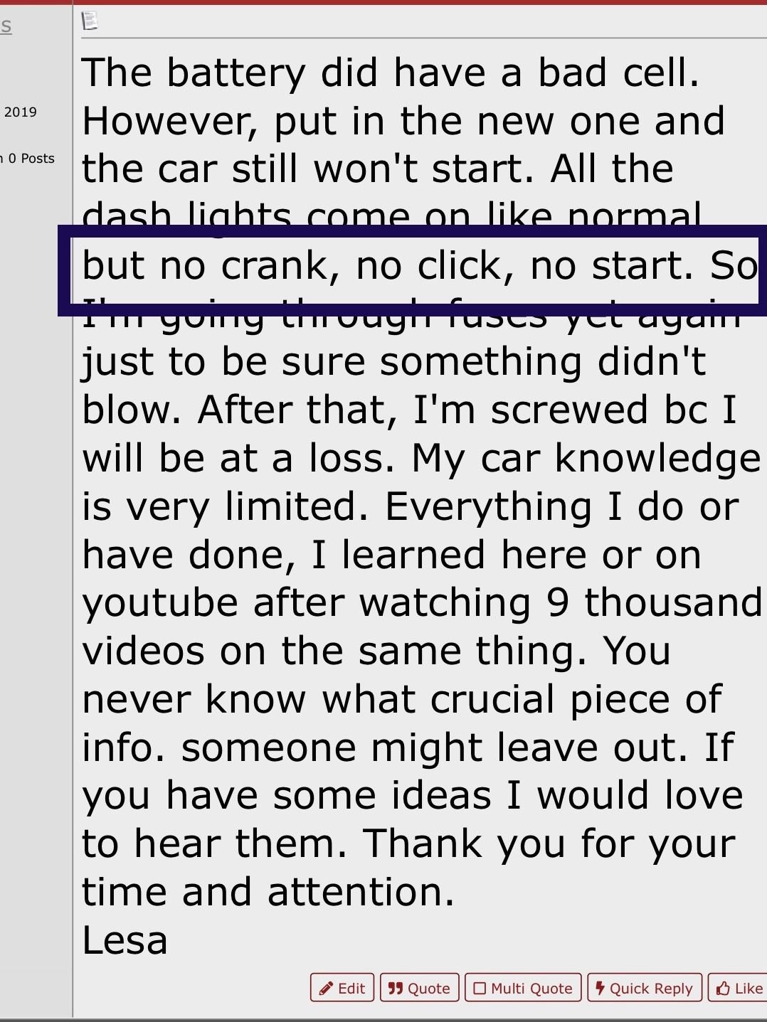

The battery did have a bad cell. However, put in the new one and the car still won't start. All the dash lights come on like normal but no crank, no click, no start. So I'm going through fuses yet again just to be sure something didn't blow. After that, I'm screwed bc I will be at a loss. My car knowledge is very limited. Everything I do or have done, I learned here or on youtube after watching 9 thousand videos on the same thing. You never know what crucial piece of info. someone might leave out. If you have some ideas I would love to hear them. Thank you for your time and attention.

With limited experience and maybe lack of some basic diagnostic equipment this may be a little difficult for you to diagnose...you can try selecting “battery voltage” on the DIC turn the key on and see what it reads...I had a bad ignition switch a few years ago but I knew it must be an ignition switch because I knew I had a fully charged battery...my DIC was reading about 8 volts so I quickly cycled the switch on and off a bunch of times and it started...I cleaned off whatever corrosion may have been on the contacts inside the switch..try that !!...also does your security light on the dash go out when you turn the key on ??

I always advise people to check the TDR "Theft deterant relay" and verify you can hear it click when you turn the key to the start position. The TDR is located above the BCM in the passenger footwell area to the left of the fuse box. It is identifiable by a red and violet wires, and smaller gage yellow and yellow/black stripped wires. The TDR is the relay that sends 12 volts to energize the starter, post after verifying TDR operation or non operation.

MY C5 failed in the Fred Meyer parking lot as well. Must be the store’s fault.
If the TDR is clicking, it’s likely the starter solenoid. Sometimes using a long stick (old broom handle) and a hammer, you can whack the solenoid and it will start.
If the TDR isn’t clicking, you have to trouble shoot back from there.
For instance, the clutch switch if it’s a stick or the neutral safety switch on the shifter if it’s an auto.
Etc etc

Yesterday I had this problem…for me it was pass key sensor after troubleshooting. I looked for DIC for codes. I had DTC B2723. I ended up jumping the TDR and drove it home.

I used thick gauge safety wire and jump the purple and red wire on the back side TDR connector…

For everybody out there, make sure the car is in Park, or neutral when jumping the TDR, as doing this bypasses those safety features.

When trouble shooting mine, I also did the jump thing. And yes, be sure to have the car in park or neutral!
New ignition switch fixed mine
