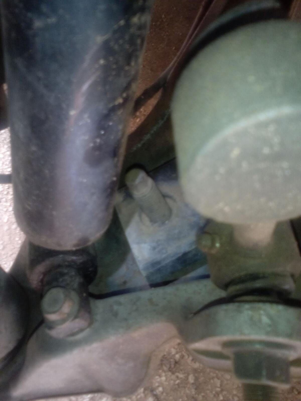

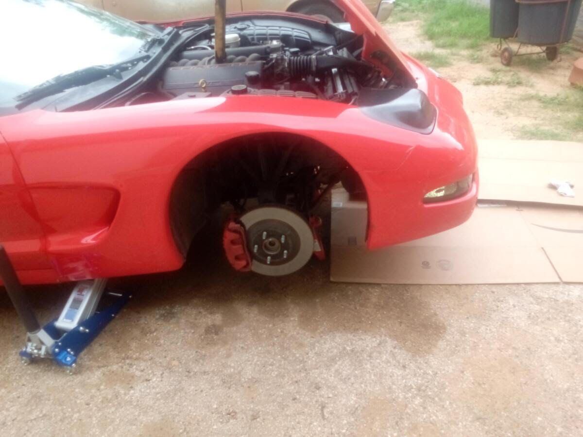

the dude left the njts off the front to get 1.5" of lowering i guess i read you could only adjust 1" on stock bolts without the nut get extra half inch. Yes i know waiting on amazon to ship the hood struts. Thats not normal correct should have nuts the rear end has about 2" of thread and nuts. ANYONE KNOW WHAT SIZE THREAD NUT so i can run up to lowes get some. The bolt measures a half inch thick with threads
