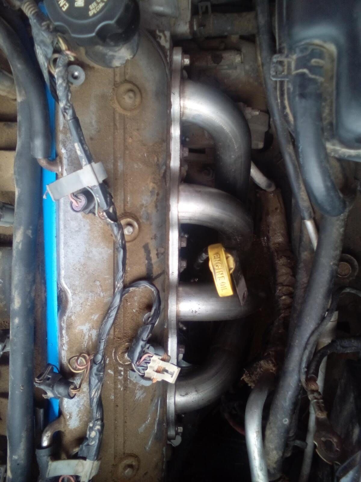

Old May 25, 2021 | 12:50 PM
Justin Raney's Avatar
Justin Raney
Joined: Apr 2021
Posts: 2,191
Likes: 82
Got the drivers side in no problem mine did clear heres the passenger side where i hammered it. Was caught a ways around the round part of header and oil pan. The steering column is really easy to loosen up and the valve covers stayed on I took the plugs out on this side which made things alot easier. Bosch or autolite platinums are good deciding which afforadable plug to use?
Old May 25, 2021 | 02:50 PM
Jeremy_M's Avatar
Jeremy_M
Joined: Aug 2020
Posts: 29
From: NW Georgia
thats about how close mine are to the oil pan, I have had no issues with oil temps.
