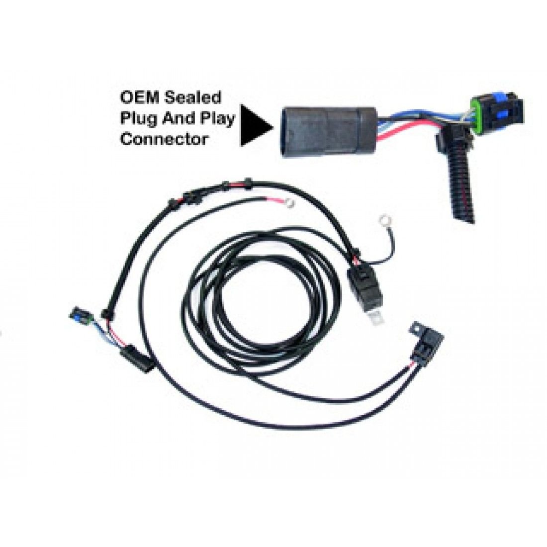

You say you have some sort of “Boostapump” gizmo installed in your fuel system...never heard of it and don’t know how it’s wired but if you jump pins 87 and 30 at the fuel pump relay the pump will operate...my video on checking the relay is enclosed below...maybe it will help !!
Old May 27, 2021 | 03:21 PM
Smoken1's Avatar
Smoken1
Joined: Apr 2013
Posts: 5,042
Likes: 1,157
From: Oregon
Most BAP's are wired in with a "Hot wire kit" that take's 12volts straight off the alternator and bypasses the factory wiring
And these also add another relay and fuse into the mix
Old May 28, 2021 | 08:33 AM
mmartinez's Avatar
mmartinez
Joined: Sep 2008
Posts: 3,138
Likes: 802
From: Espanola New Mexico
Just to clarify, a boost a pump is a small electronic box that is mounted next to the fuel pump, it is activated by a Hobbs switch that is installed on the vacuum line on the brake booster. It boosts or raises the voltage to the fuel pump to provide enough fuel under boost conditions.
