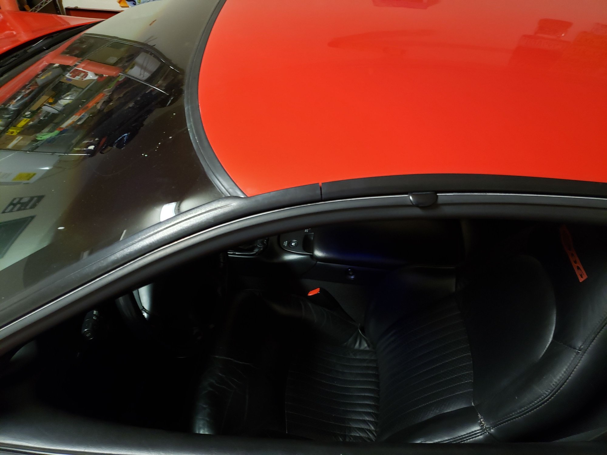

By the way, here's a pic of where the crack is on the molding. It's on both sides.
Crack in windshield side reveal molding.

They dont say if they replace that piece or just remove it. I cant tell in their finished pics if the piece is still cracked where it shows in some of the earlier pictures.
In their pictures its either already broken about where yours(and mine on my car) is or if they cut it to get the rest of the trim out(not realizing it will leak like a sieve after that)...
Anyway, I wouldnt expect a windshield place to have or include those pieces because honestly they are getting VERY hard to come by. Ive got a brand new passenger side and need to find a drivers side also to fix my car.

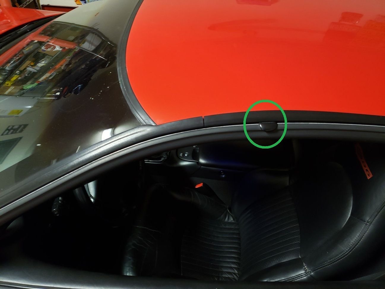

When replacing those pieces make sure you keep the two blowout clips that are attached to them. The new trim pieces don't have them. How do I know? My 03Z had the windshield replaced back in 2008 including replacing the old trim pieces which weren't cracked. The shop threw out the old parts and didn't keep the window blowout clips which did cause issues with the top of the windows popping loose from the weather strip at high speed.

I discovered my 2003 Z06 has a crack on the same area of the reveal on the driver side and I can't find a replacement and at some point every C5 FRC and Z06 reveal will be cracked, then there won't even be used ones on the market. So you'd think someone would make an aftermarket part of this or at least a repair kit to fill in the crack so it matches and won't leak.
