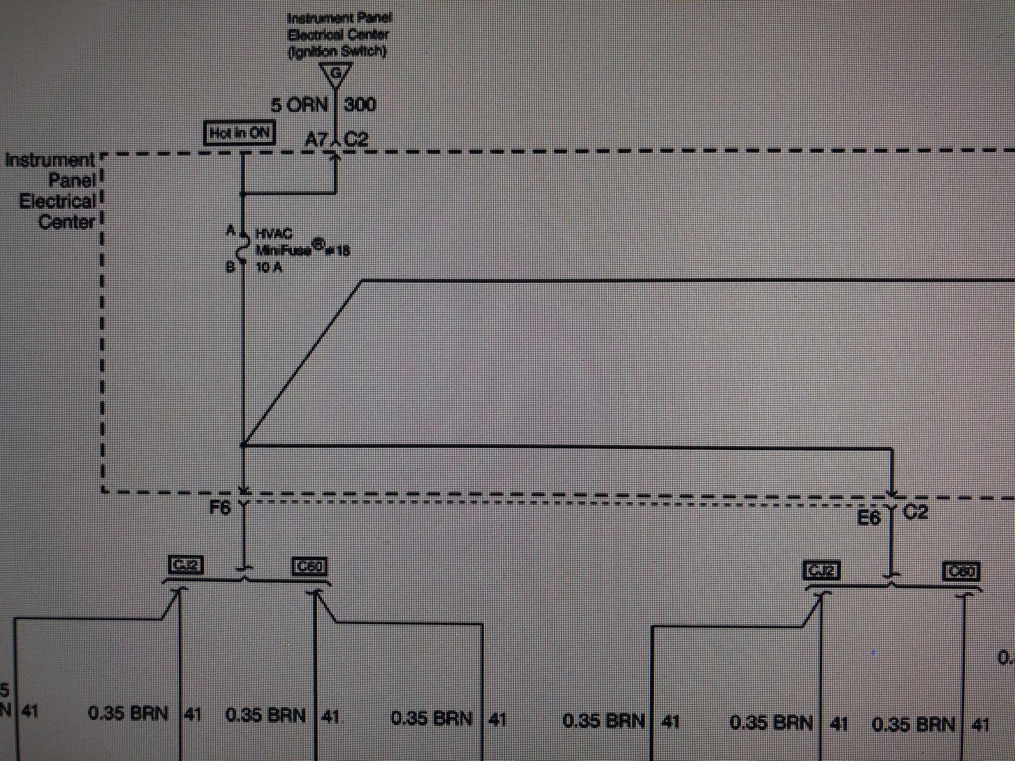

Greetings all, I have a 1997 corvette that has an electrical problem, I am having trouble getting power to my climate control, all grounds have been cleaned and working properly, the under the hood fusebox hvac (10a) has power to it but the inside fusebox fuse number 18 has no power to it. any suggustions would be greatly appreciated..

Fuse 18 in the passenger compartment is only hot in RUN. Are you testing with the key on?

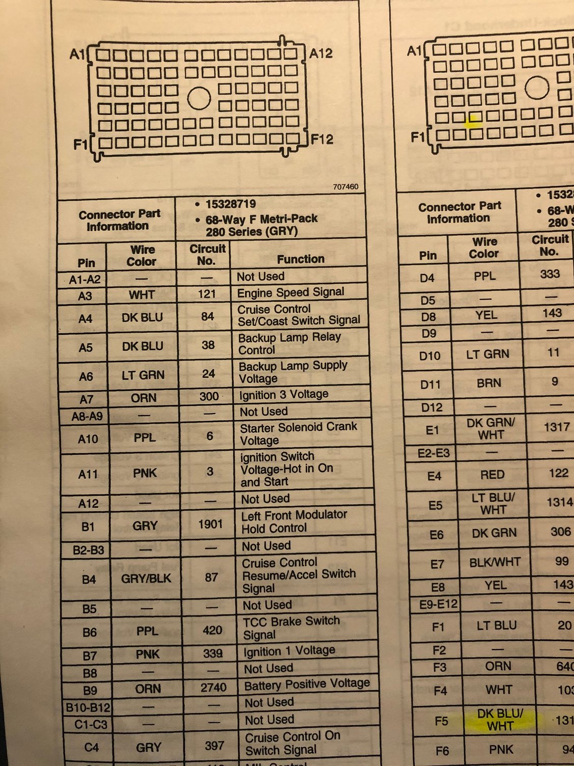

As previously stated this fuse is hot in ON !!...you may have to get inside the fusebox and see if you have power on pin A7 on the C2 connector...your 97 matches up with my ‘01 connector and pin location.

yes I am, can't figure it out, thanks for your responce
