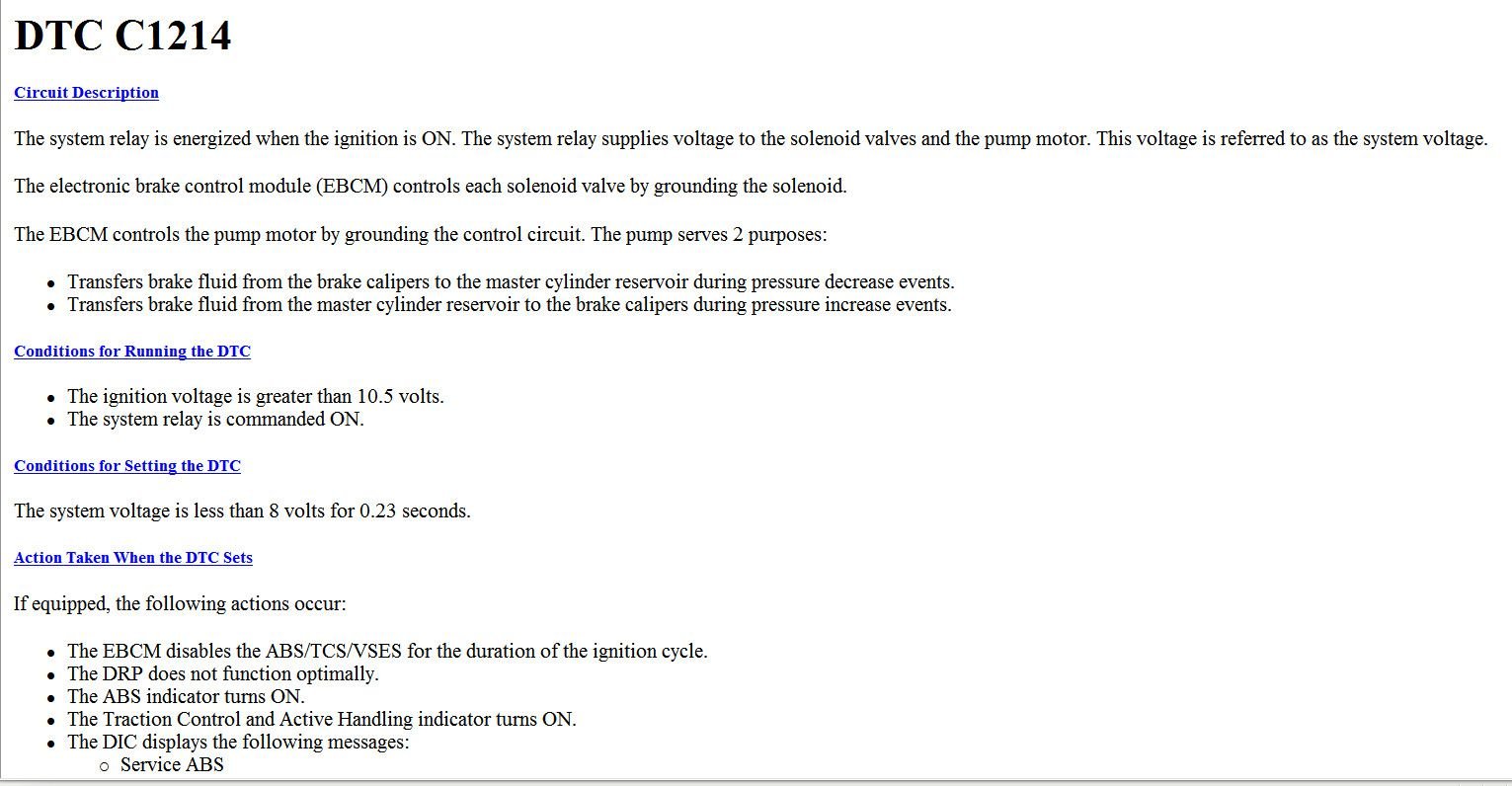

C1214 usually means the EBCM needs to be repaired (01-04 model years only). If you are not mechanically inclined then you will need to have someone remove the module for you and send it somewhere for repair. Most people use ABSFixer although there are a few other places also. You can still drive the car and the brakes will work fine, but without the EBCM you will not have ABS, traction control, or stability control.

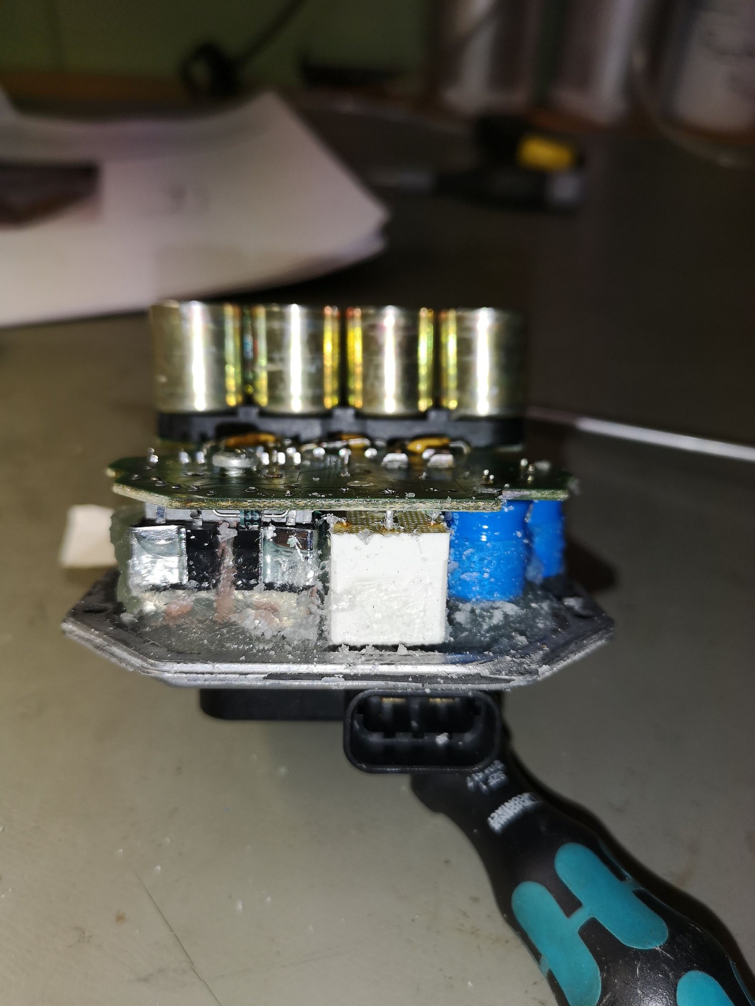

DTC C1214 normally is caused by a defective relay (white relay in the photo) in the ABS electronic part .
With some soldering skills it is easy to replace .
Also shown in ths
