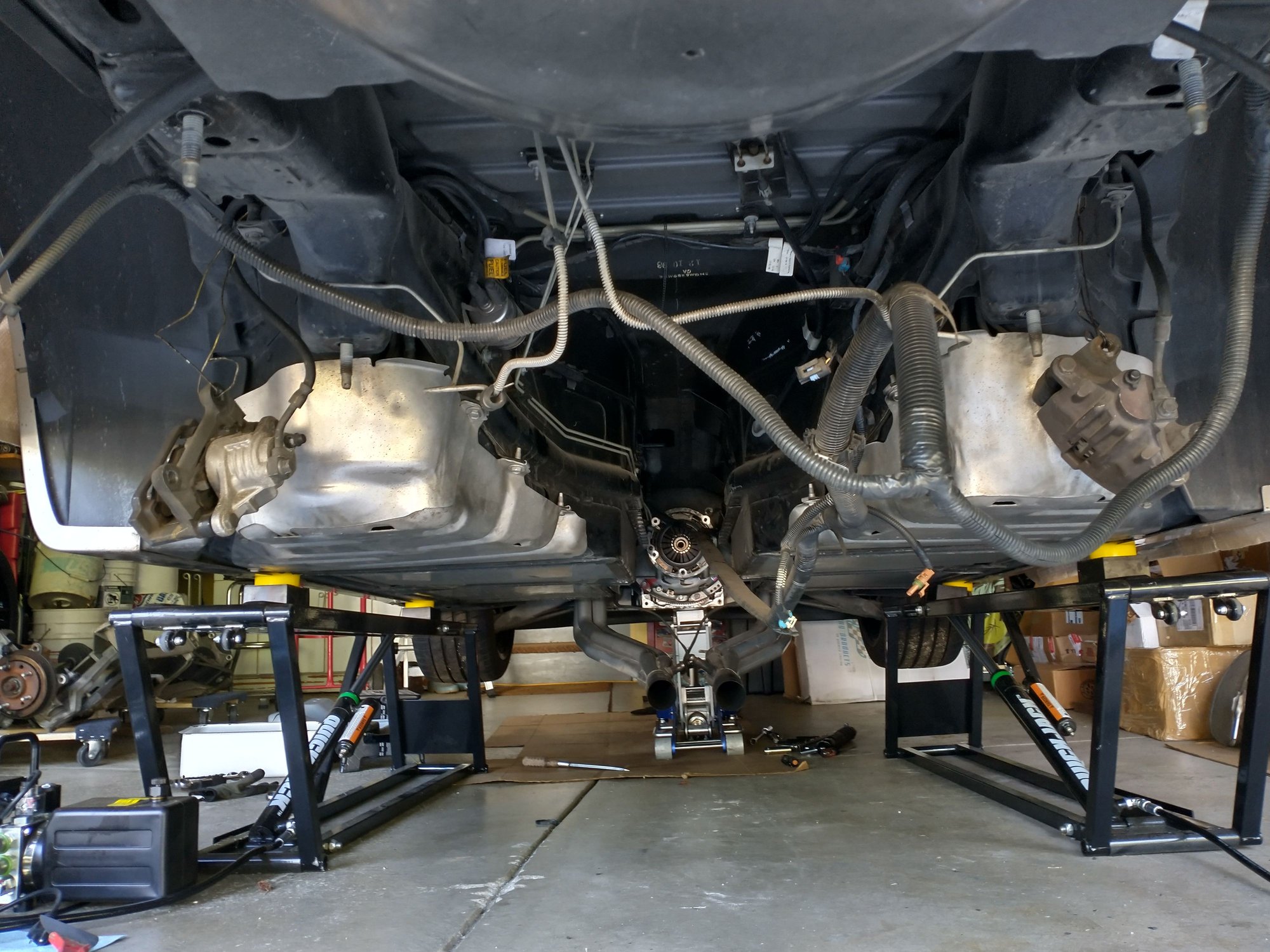

Yes you can, I did it last summer. I already had the car sitting on a set of wheel dollies to make it easier to move around the garage. But since the car was sitting up higher off the ground, that also allowed me to fit the set of thicker rubber blocks between the jacking pucks (bright Yellow) and the QuickJack. Not sure if the job would have been possible without those rubber blocks. I used a floor jack with a wooden adapter to hold the rear sub frame cradle / suspension (watch it will try to rotate and fall off the jack without some type of support setup) and two transmission jacks on the torque tube transmission/differential assembly. BTW, don't let that the assembly rotate when your moving it or you will cover the garage floor with gear lube, unless of course you seal up the differential side plates openings.

Ive had mine out twice in the last month just on esco jack stands which say 11" min height(where I have mine set to) and then I have the tall aluminum jack pucks, I guess are 2", so 13" off the ground. The quick jack 5000 says it will go 21"...
I lower the cradle on a motorcycle jack from northern tool then I transfer it to a 4 wheel movers dolly which I guess is about 6" high. Then I have to pull a shock off the cradle then I can roll the whole cradle out one side of the car. Plenty of clearance. If you dont pull one shock completely yea its way to tight, but pulling one shock makes it pretty easy to pull out one side.

Yes, it can be done on jack stands, the photo below is from a friend of mine doing his clutch job that way. Plus there is a tad bit more room under there to maneuver the creeper under without the QuickJacks in place. If (and that is BIG HUGE IF) I get my garage addition, I plan on buying a MaxJax M6K, but that is another story....

I did my torque tube last summer as well, the quick jacks worked great. When I put everything back together I put the torque tube in by itself and then installed the trans, it made lining everything up easier.
