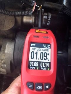

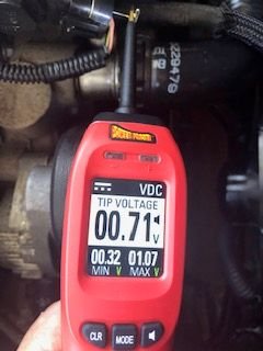

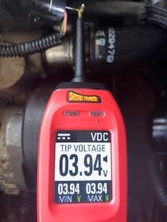

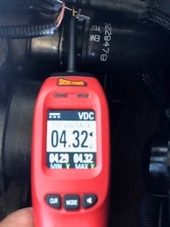

First thing don't worry about a 7% positive fuel trim...+ or - 10% is OK....if you have a DVOM and know how to backprobe a connector I'd check both TPS1 and TPS2 signal circuits on the TPS sensor with the key on...this is what you should see at idle and at WOT...this is with the engine off and you are looking at 4 voltages !!...there is NOT going to be 1 magic fix for this...you have to do some detective work. You can buy these T pins.
TPS1-IDLE
TPS1-WOT
TPS2-IDLE
TPS2-WOT
