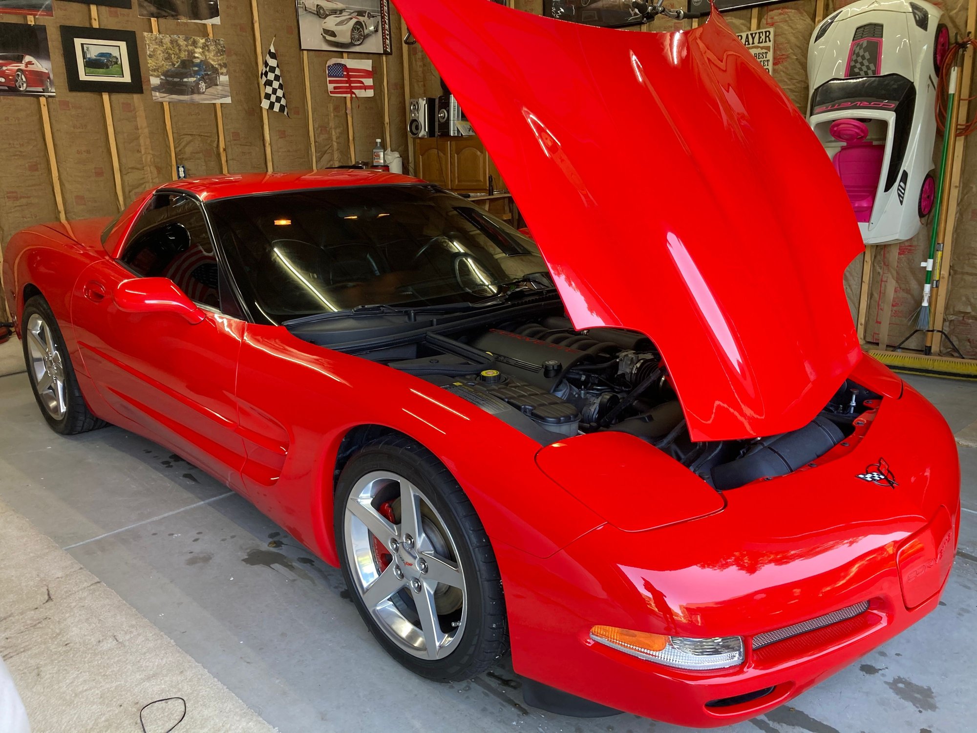

Assuming base C6 wheels: Fronts will fit fine. Rears will need a 3/4 inch hub-centric spacer.
Look great on my car (my opinion, of course).

X2 They look good on my car, too. No issues with ride quality either.

C6 wheels with 1” spacer in rear. 305/35s out back
