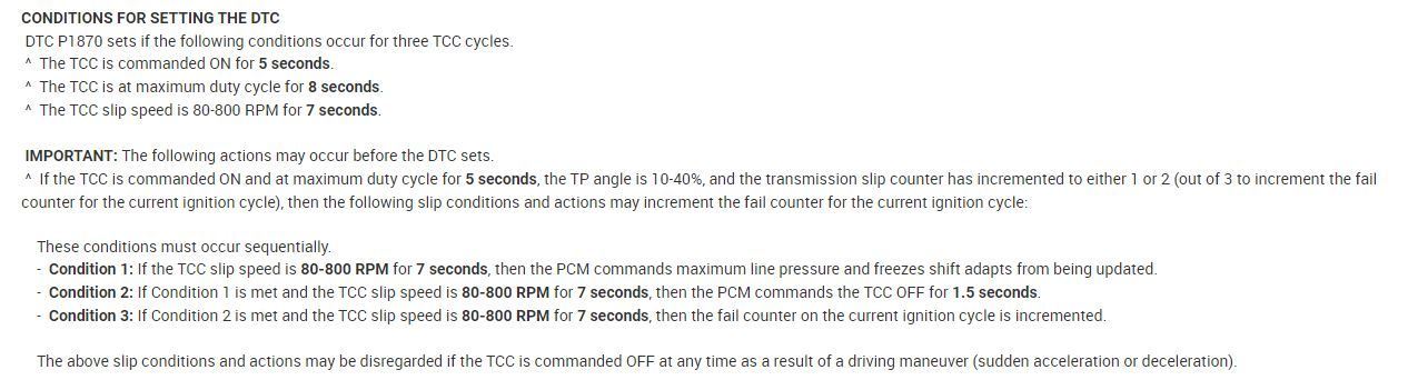

Your reply is most appreciated. Tech found DTC P1870
They did tear down the trans after it continued to deliver the same code and continued to slip. Interesting you did not think the differential has anything to do with the issue. We are in SW Florida.

P1870 appears to show your torque converter blew up. "TCC" = Torque Converter Clutch. Have to find out WHY the TCC blew up. Usually its because some crap went through it. Did they get P1870 on the replacement trans that blew up too?

At any rate, don't pay for 3.15 gears. It should cruise just fine with the PCM programmed for 3.15 gears and the car actually having 3.42 gears. It definitely should not be slipping when cruising with that gear mismatch. Just avoid any wide open throttle runs until you get the PCM programmed for the 3.42 gears. I don't think it would slip, but the shift timing will be wrong and it will likely just hit the rev limiter which might freak someone out that the transmission still has issues.
There could be a PCM or wiring problem if it set the same code again. But then maybe they didn't replace or clean the transmission cooler properly or they tried to re-use the torque converter, which you should never do when rebuilding a transmission. A TCC code and the thing slipping are different faults, but could have been related as in the one failure cascaded into causing the other failure.

I've been running a 3.42 diff in my 2000 C5 A4 for 16 years!! Originally a 3.15, G92 optioned car. In my opinion, it sounds like the lock-up clutch, the TCC, has dumped contaminates thru the entire valvebody and trans. Did the dealer install a new torque converter? They should have, especially for $3,900!!!! It sounds very much like my old 700R4 (The grandfather of the 4L60E) did when the TCC went out. My trans guy said if I put a new/rebuilt tranny in, and kept the old converter, I'd basically be reinstalling the problem, and the new/rebuilt tranny would soon be junk, as whatever junk was still in the converter would soon be flushed into the 2nd tranny. Think of it as rebuilding the engine, when the oil pan is pull of metal shavings, and then pumping the junk thru the replacement engine. The A4 back then didn't have much of a trans filter. It DID have a big magnet in the pan. You shoulda seen that magnet!!!! It looked like it was 4 or 5 inches in diameter, when it was less than half that size. All due to it grabbing all the metal shavings. Please keep us posted, and best of luck........
