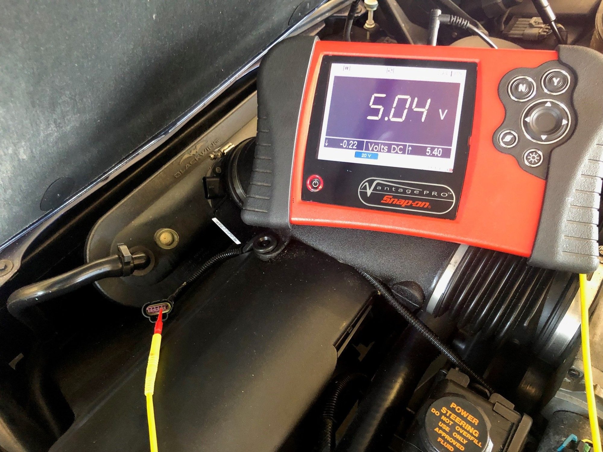

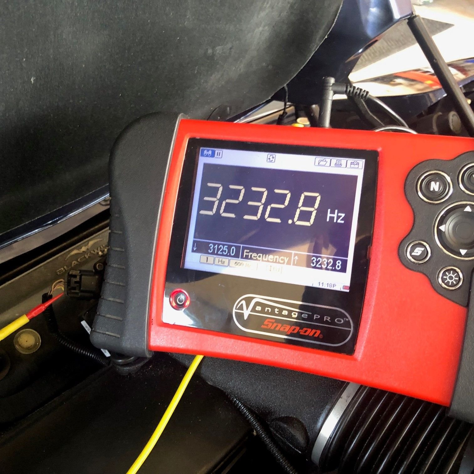

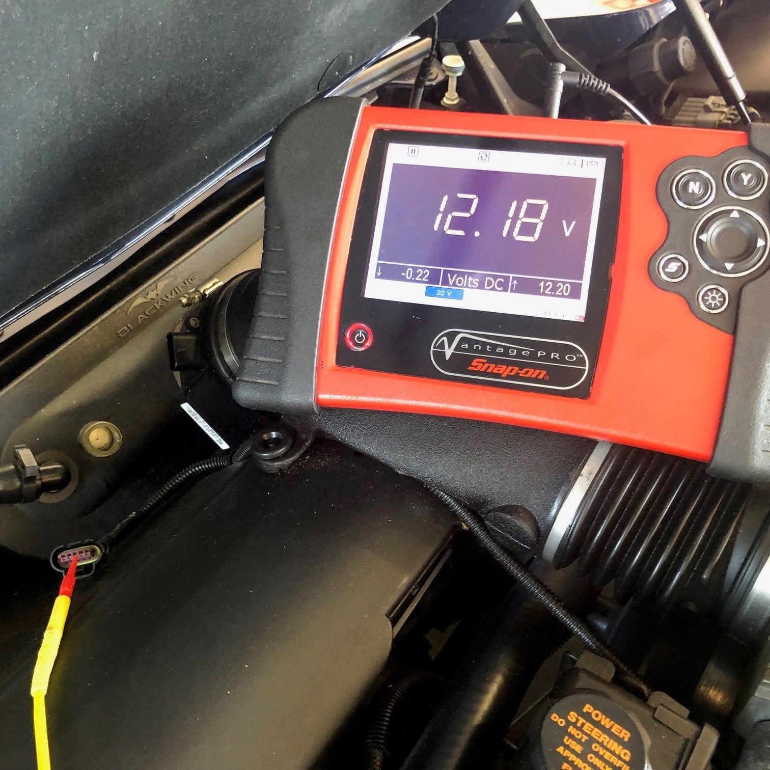

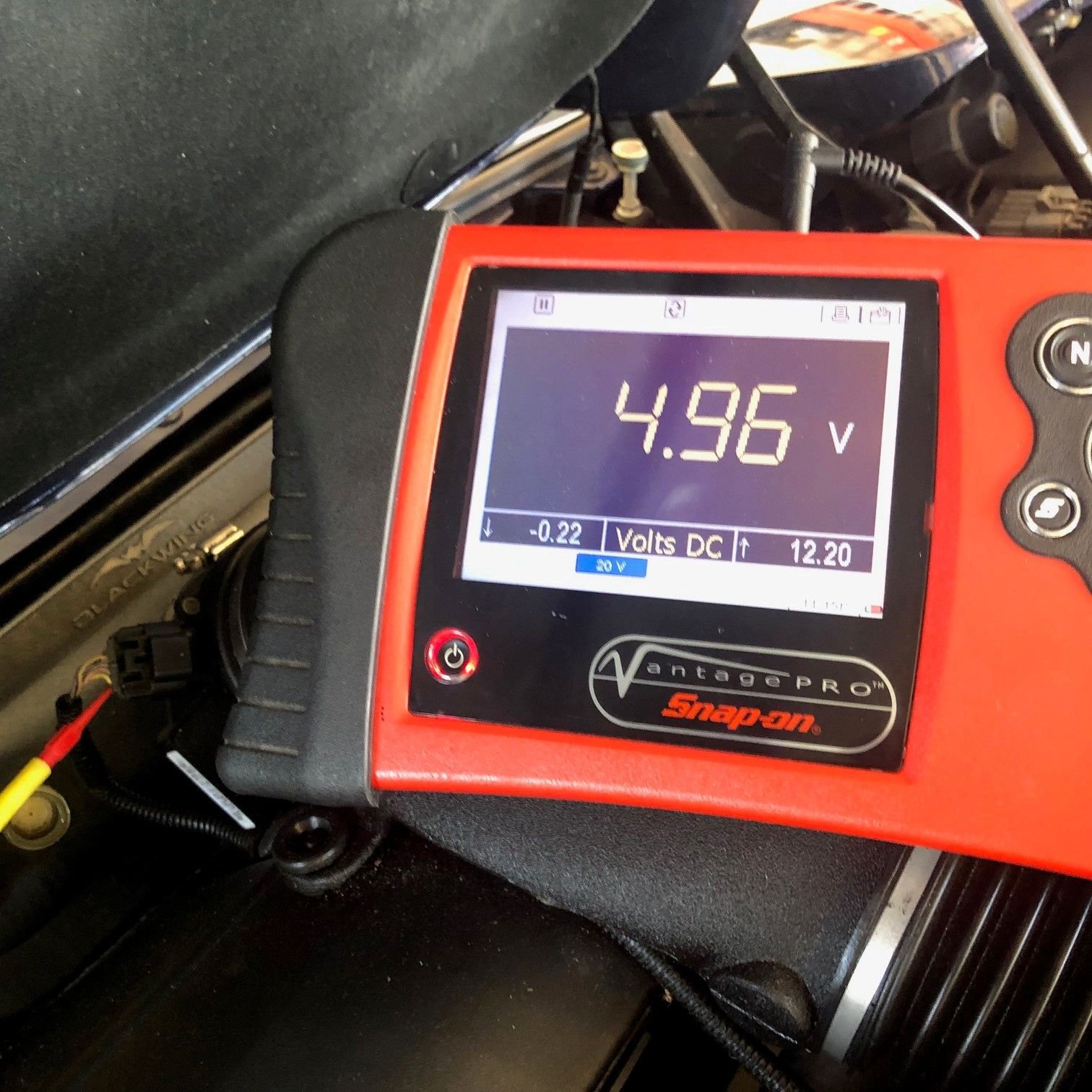

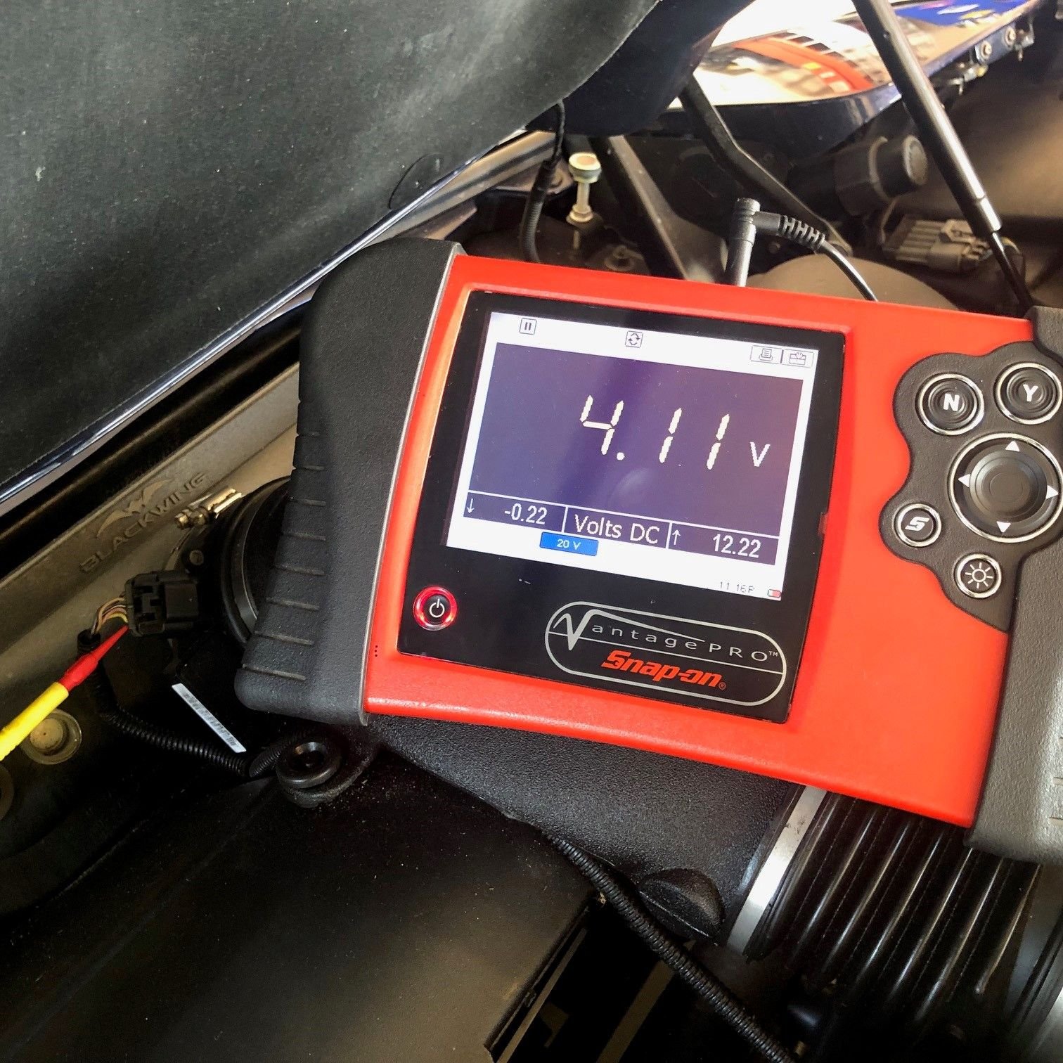

I've used non chlorinated Brake Kleen on MAF sensors many times with no ill effects...where in SW Florida are you located ??...if you want to bring the car by I'd be happy to look at it for you. If you have a DVOM this is what you should see with the MAF connector unplugged and then plugged in... you will "back probe" the connector when it's plugged in...you can use a thin needle and guide it along side of the wire from the back.
MAF unplugged probing pink wire key on...battery voltage
MAF unplugged probing the yellow signal wire with key ON...seeing your 5 volt ref.
MAF unplugged probing the black/white ground wire...should be less than 100mv (less than .1 volt)
MAF connector plugged in probing the yellow signal wire key ON
MAF connector plugged in probing the yellow signal wire at idle. If you rev engine yellow signal wire voltage will decrease as RPM increases.
MAF connector plugged in probing yellow signal wire at idle with a frequency setting if you have one in your DVOM.

Hello All !!
OP stopped by this afternoon and the only current DTC was P0102…unplugged the MAF connector and power, ground, and 5 volt ref. were OK…plugged connector back in and hooked up the scan tool…MAF grams/second at 2.46 (should be roughly the liter displacement of the engine (about 6.0 to 6.5 grams/second…observed the MAF frequency and at a big fat 0 !!…should be around 3000 Hz at idle…also verified with graphing multimeter and reading the same…verified BAD MAF !!…OP said OEM MAF is on a 2 month back order…OP decided to go with an aftermarket with a good warranty…he said the code cleared and the car runs great but he still sees a slight hesitation at 40-50 MPH when accelerating slowly…OP will be swinging by tomorrow so we will have the scan tool or scope hooked up and go for a ride to see what we can see…maybe TPS signal dropping out or maybe fuel delivery issue…will look at fuel trims…I did a quick relative compression test as I always like to do (plugs are not removed and no compression gauge used but just the starter current is observed while cranking to interpret a compression) and one cylinder was at 85%…all other cylinders were at 100%…looks like if the highest compared to the lowest is within 70% so it should be OK !!
