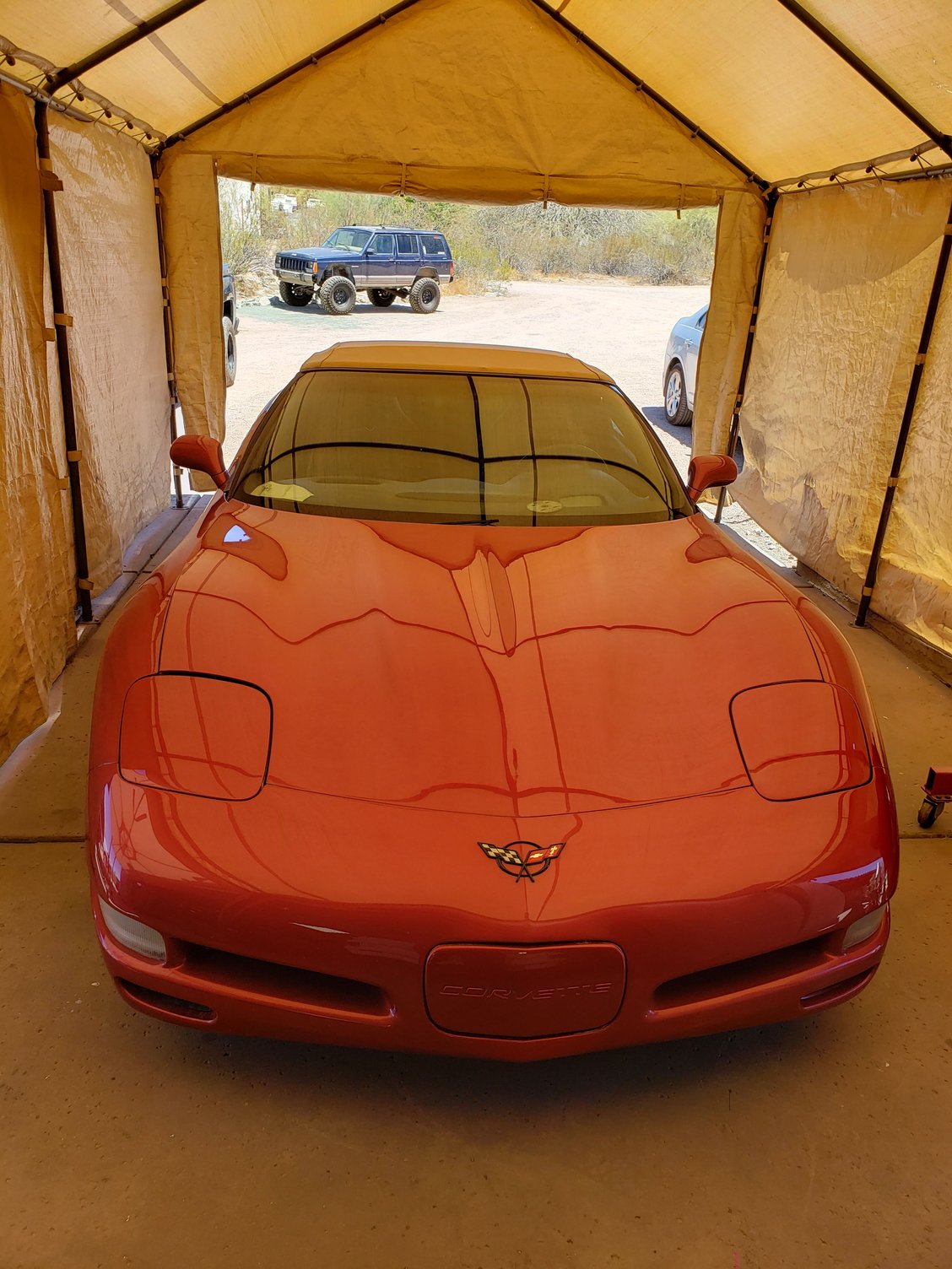

Well the 2000 is comming along, however I have no interior power. We have checked all the electrical and found no problems. Thinking it is most likely is a dead BCM. It there any other things I should be checking?
2000 we have to finish the interior and do the final buff
