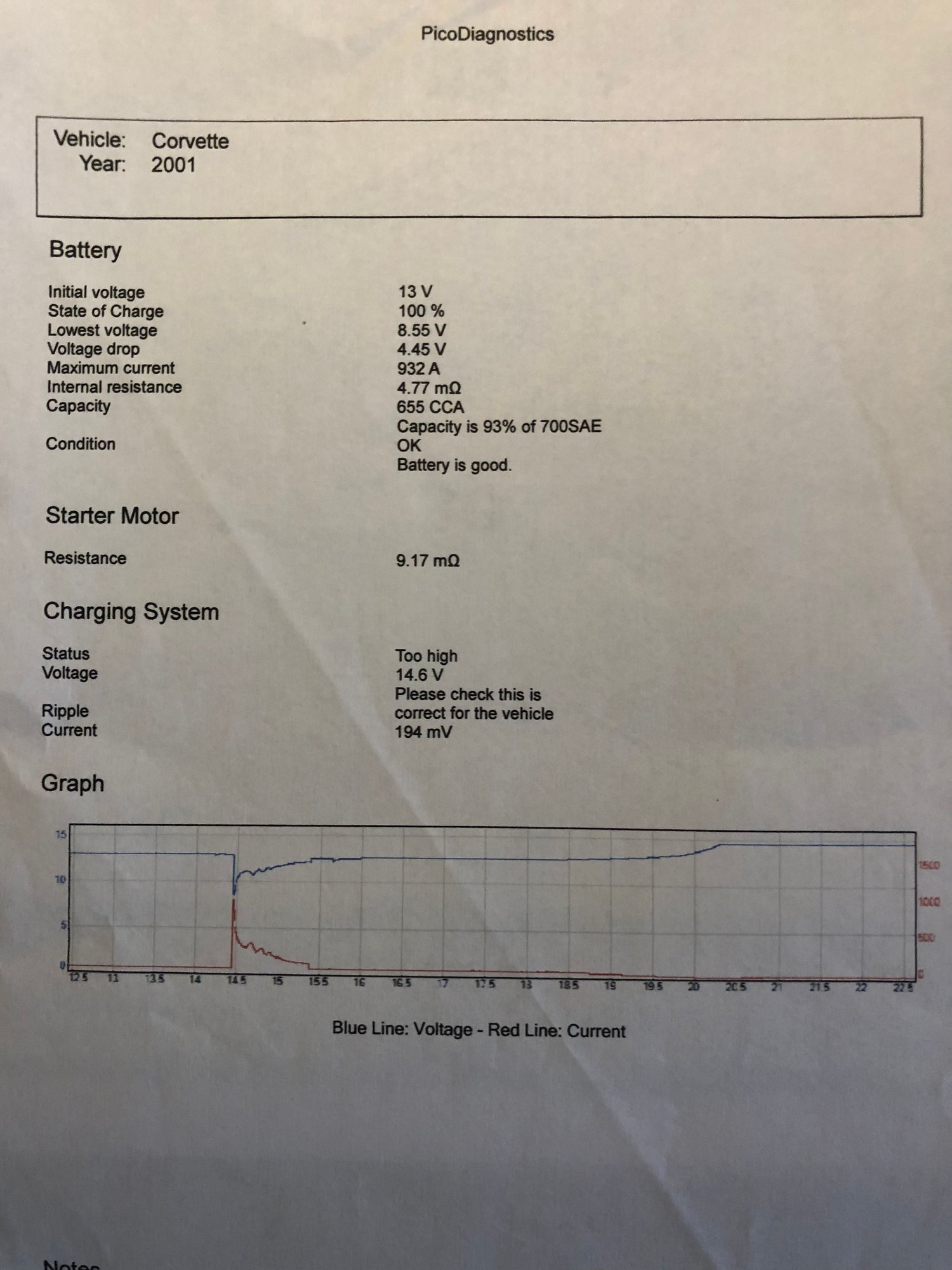

Battery was at 12.0V without the car on or running. I haven't had a chance to check while cranking or running yet. I've gone out and the car has started up just fine for the last 2 days now in the driveway. I haven't driven it yet to see if any problems come up while it's running. No codes, everything is working fine. The keyfob stopped working with the car so I re-synced it and all is well with it now to. I'll look up the P0654 code. Thanks for everyone's input so far.
At 12.0 volts your battery is basically “dead” !!…I would highly recommend taking the battery to get load tested…I do a “starting and charging” system test on EVERY Corvette I look at…copy of test I print out is below…these cars are very picky when it comes to battery voltage…you may have just enough to start it but the various modules and sensors need good voltage to operate correctly !!…if you have a tender I’d get the battery up to 12.6 (12.66 fully charged) and see what the voltage drops down to over a day or two !!

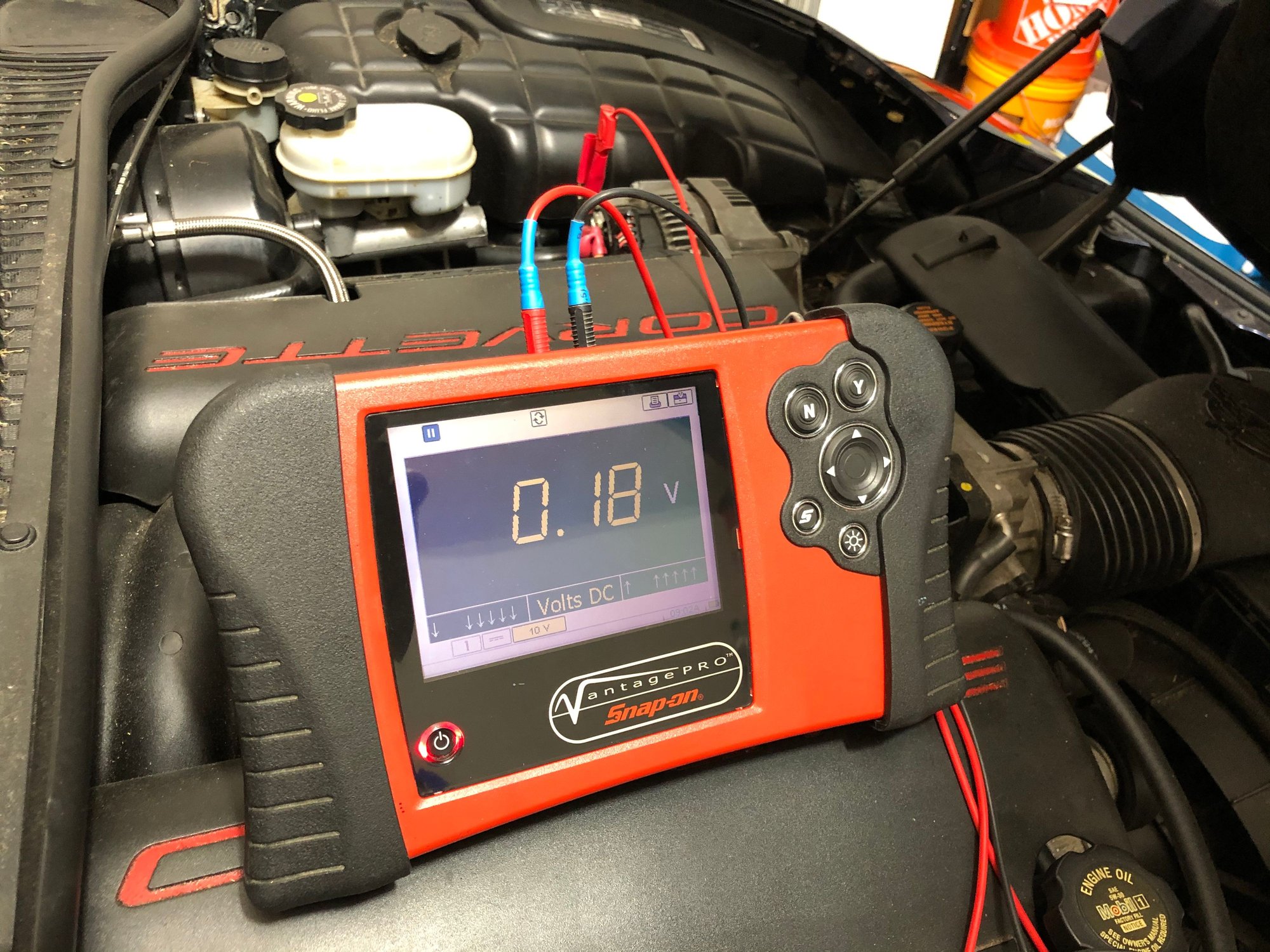

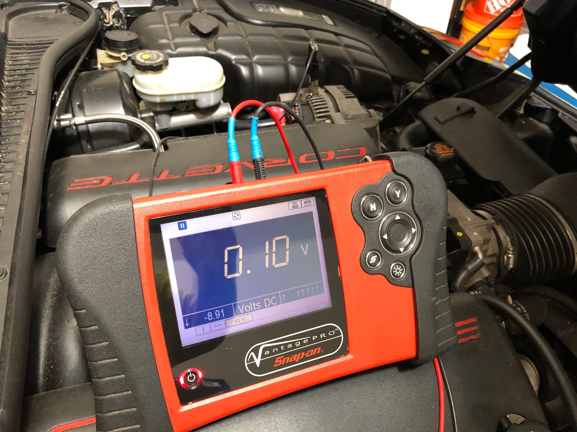

From: Cape Coral, Florida
It is also a good idea to perform a voltage drop check on the positive and negative side of the charging circuit…to check run the engine at idle with as much load you can put on it..to check positive side of charging by selecting a low voltage scale like 1 or 2 volts if your DVOM has that and connect red lead to alternator B+ stud and black lead to battery POSITIVE…to check ground side connect red lead to battery negative and red lead to a clean spot on the alternator housing…numbers should be .2 to .3 volts !!..I have .18 on positive and .10 on ground side !!…I’d also see how much your battery voltage drops overnight…write down the voltage before and then in the morning…hope you don’t have a parasitic drain !!…your battery was sitting at 12.0 volts you had said.
