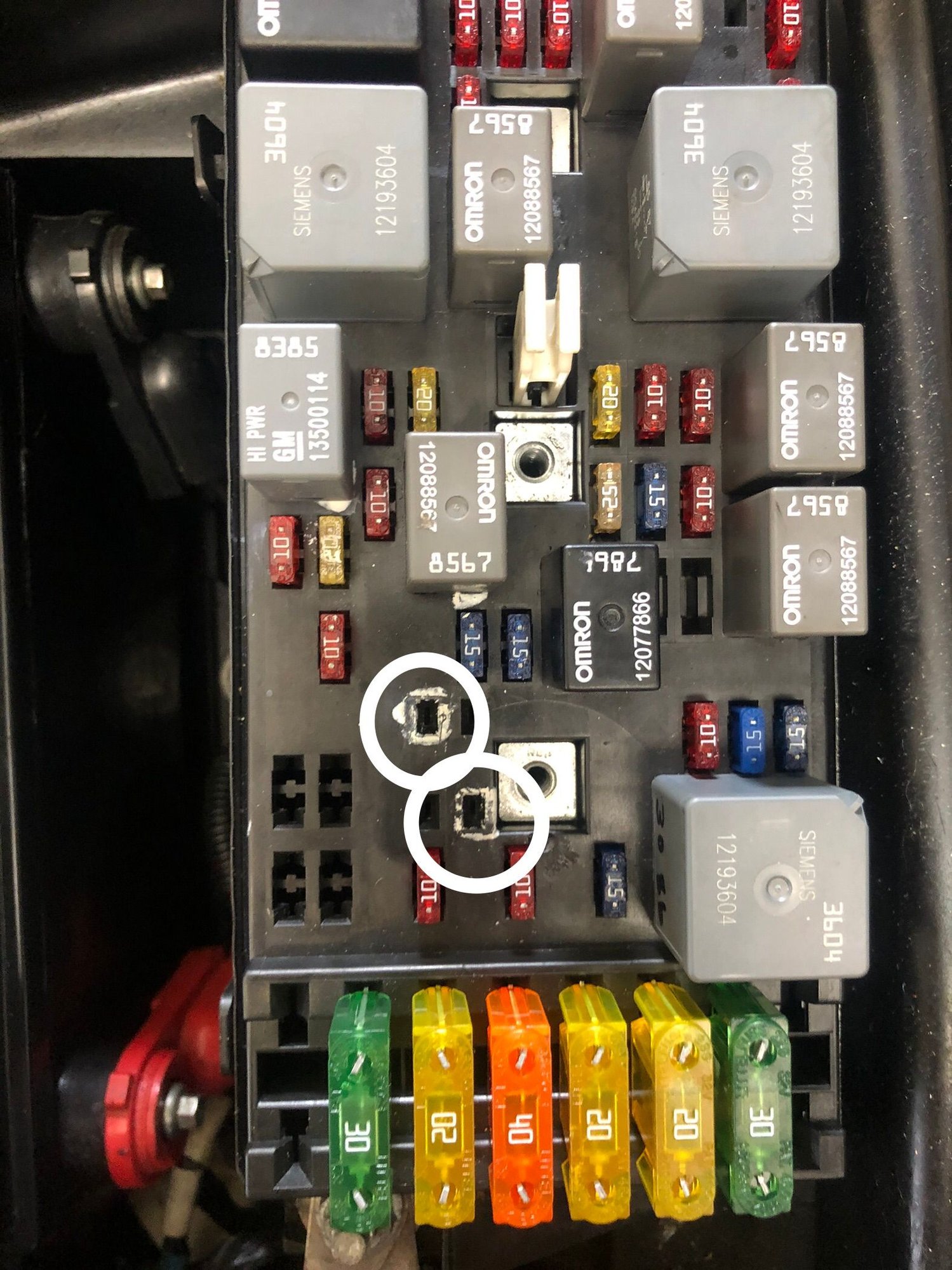

My 2002 C5 has AC issues - the light on the console blinks a few times and then goes off. Check the fuses and they look fine (tested with MultiMeter Ohms), I’m thinking it may be an easy test to use one of those bottles of AC Fixit (or whatever they are called) from the auto store and see if that fixes it long enough to sell it - would you recommend this or is this taboo?
I have read a bunch of threads on this forum about AC issues and figured I would check the compressor connections also while I’m checking

I’d check for any AC related DTC’s if you have a scan tool or if not check through the DIC…some AC related DTC’s can keep your AC from working until you clear them…can just be low on refrigerant too and in that case you will have to find that leak and recharge !!…you can remove the AC Clutch relay and jump pins 87 and 30 (circled in white) with the key on….if you can hear the AC clutch engage (click) the load side of that circuit is fine !!
