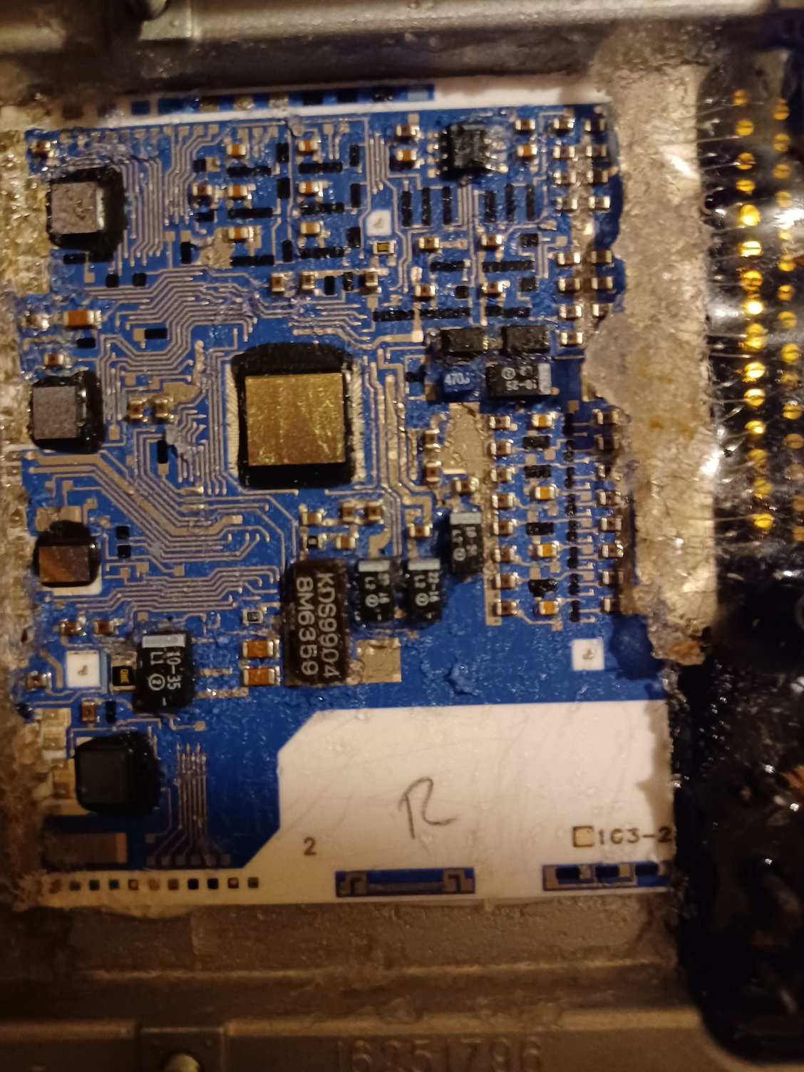

this is a Cadillac ebcm that I pulled the potting material from. Same stuff on the corvette module. Stuff is like jello. You can probe the logic board underneath and it's not too difficult to pull it out. Have not pulled it from those small wires on the sides, but the board is cleared of it. Some residue there yet, would take a little extra work to clean it off. But as you can see it comes right out.
Are you saying the Cadillac unit will interface with the C5 unit? Or saying C5 unit w/C1255 code can now be repaired? Thank you.

Are you saying the Cadillac unit will interface with the C5 unit? Or saying C5 unit w/C1255 code can bow be repaired? Thank you.
I have looked over just about every module out there that is like the early corvette module (98-2000), there are some close but still would not work. The only module that would work is the corvette module. The top board that serves power to the logic board is the same except there are some modules that are missing the capacitor between the two bpmv relays. So most of those can be swapped to fix issues on that top board.
What I am saying is that potting material is like jello. You can probe the circuits underneath it without removing it. If there is something under there that is bad, it can be peeled away to repair. Those ICs are not going anywhere though. As for replacing the potting material, there are options out there to re-pot the board. So I am saying it is possible to do some repairs of that board. Don't know of anyone doing it, but researching it, it looks to be possible. Depends on what fails on the board.
