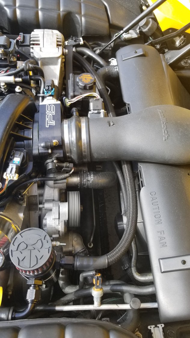

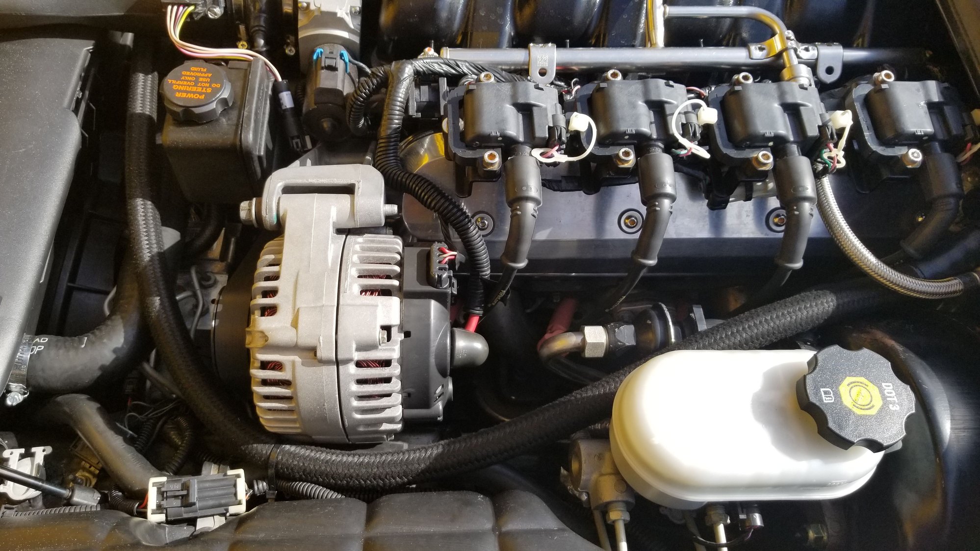

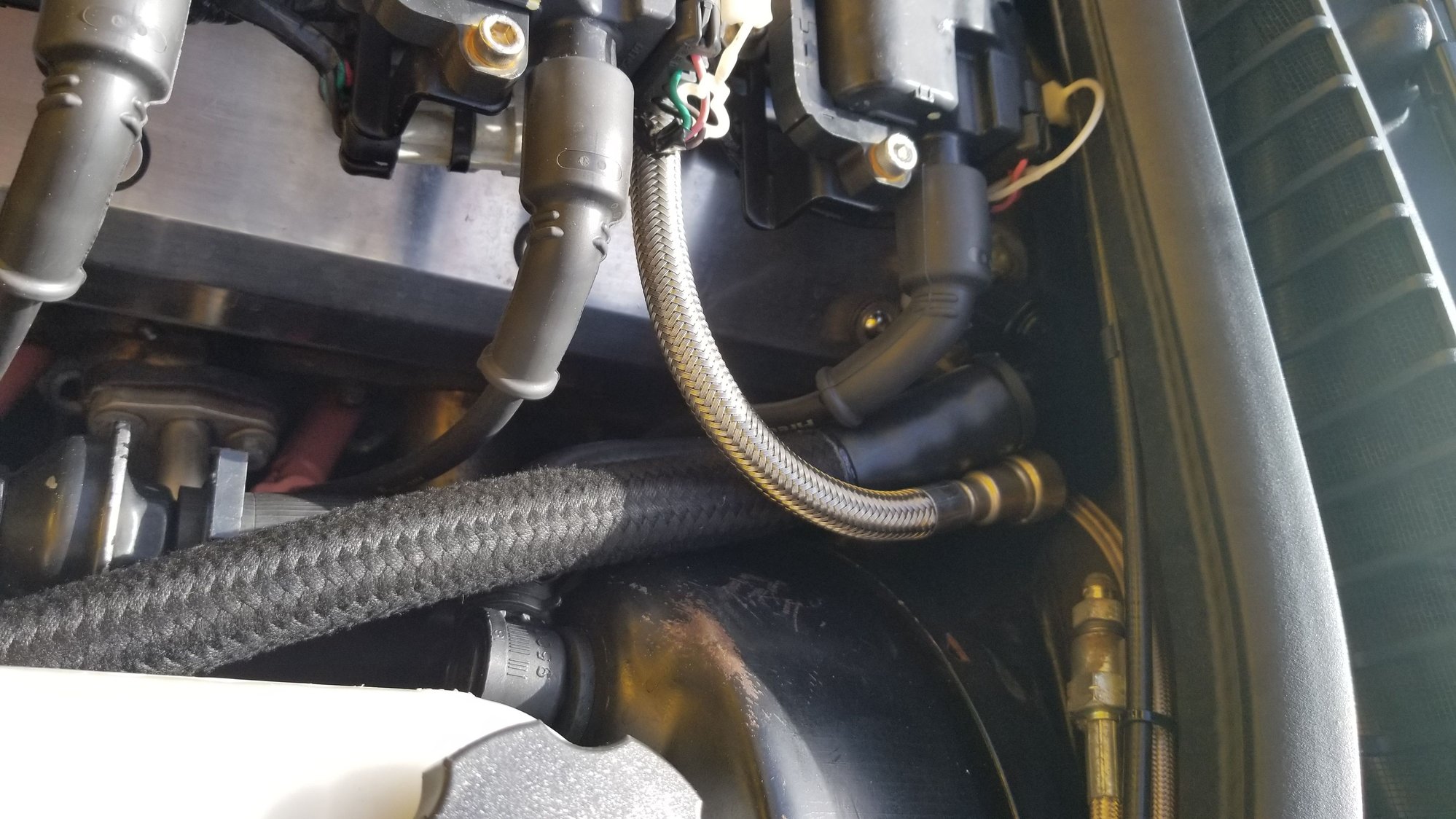

I would second the Mighty Mouse catch can. You need to be drawing air out of the crankcase from the valley plate, and pulling fresh air into the valve covers. Are the covers factory with the baffles inside? If not, baffles will help control oil flow around the vents during cornering.
Here is my setup. The vacuum comes from the intake behind the throttle body to the side of the can. It pulls the air out of the valley plate from the fitting on the front of the can. The fresh air inlet to the valve cover comes off the side of the throttle body. The nice thing about the Mighty Mouse can is that is has a check valve under the filter so you can eliminate the PCV valve (per their instructions). If the system over pressurizes for some reason it will vent our the filter.
