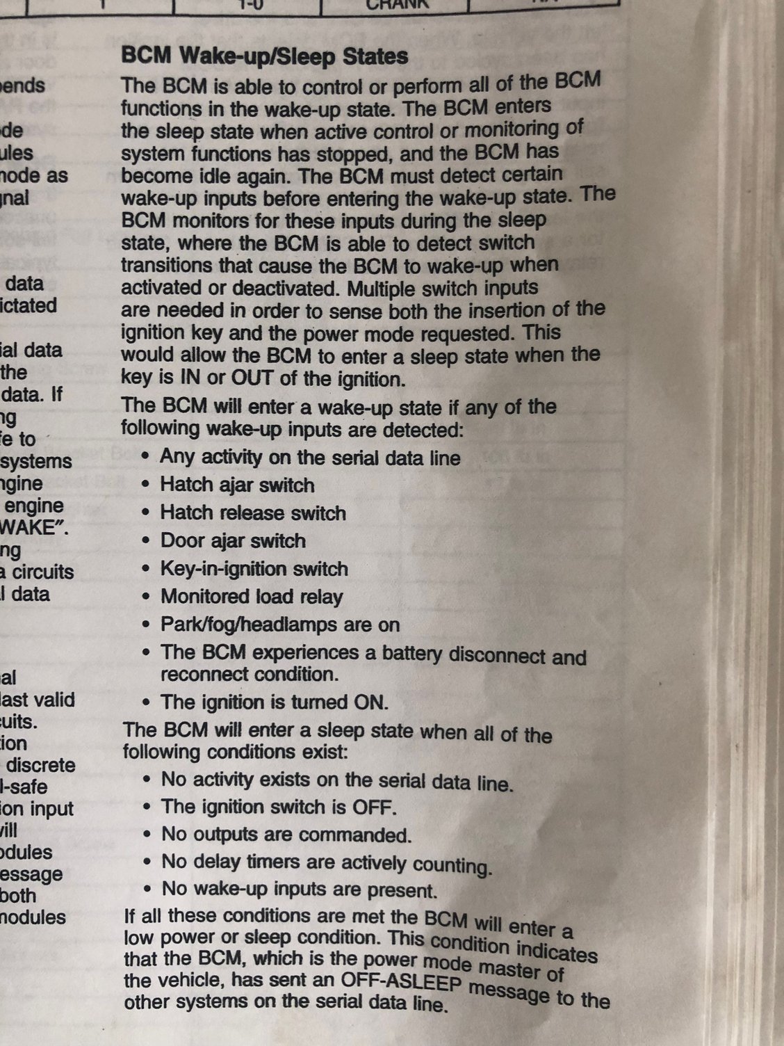

Hope this helps !!…from the 2001 FSM. It is a good idea to enter ALL pertinent info in your profile…model year, mods, tune etc…this helps up help you !!

Great information on BCM operation C5 Diag.
