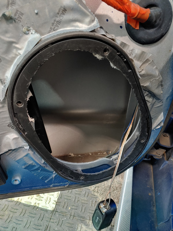

Yes you can use it just for power.
Cut the bose wires if you want to but
You don't have to cut the bose wires since as I understand you're wanting to run an aftermarket stereo which has rca outputs.
You have to run new wires to the speakers and not use the bose wiring if you're going with new amplifiers
Here I ran some 18 gauge speaker wire
