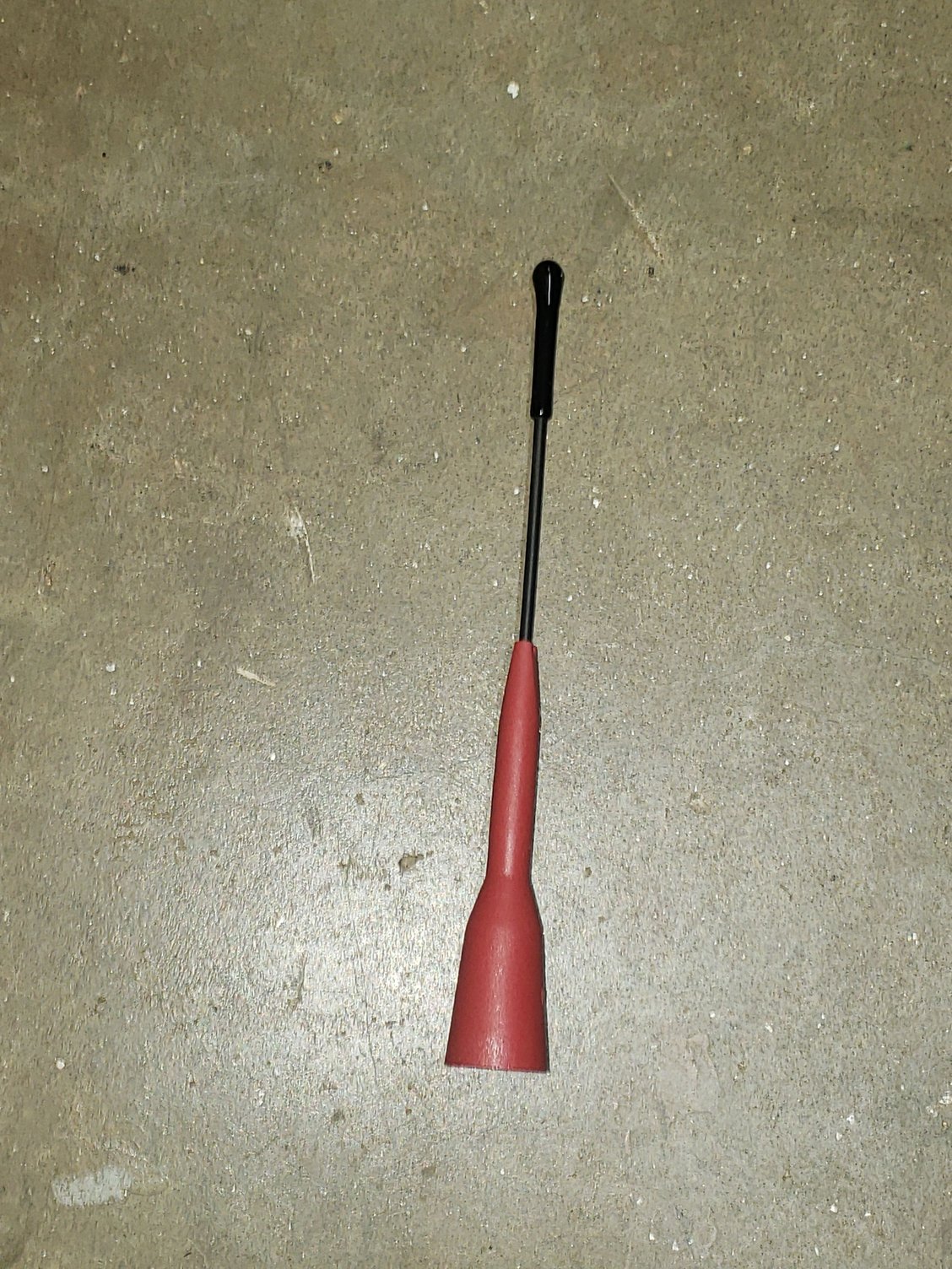

Found back probes in my tool box

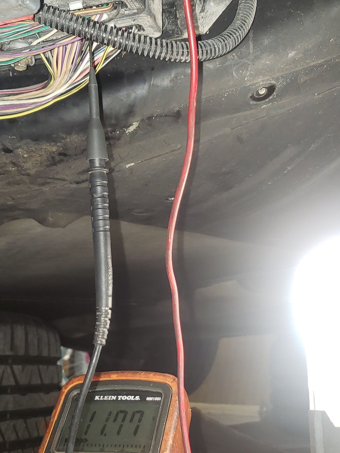

COM to pin 46 and POS to battery voltage underhood
11.78 volts with key on and engine off.

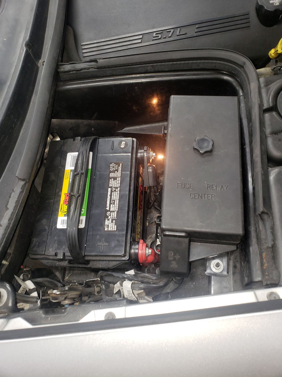

Okay so I moved back up to the test bulb i wired into the underhood fuse box last week. I must have had too many beers when I put that in cause I had it on the wrong pin. Corrected that issue and now my check engine light is located by the battery. Hate me if you want but I'm not going back into the dash and opening the instrument cluster. This is its home and I'm fine with that.

seems like it will though. Right? My bulb here is in the circuit correctly and the PCM driver detects the correct voltage when it runs dtc P0650. I have no codes on the PCM. Just a new location for the bulb.
