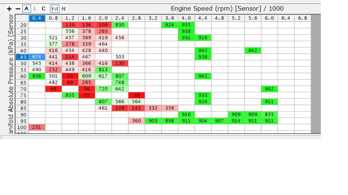

Old Jul 6, 2021 | 05:28 PM
Timz06's Avatar
Timz06
Joined: Sep 2001
Posts: 4,267
Likes: 6
From: Cumming Ga
Seems ok up top lean on the bottom end, what do you think?

That’s something I really don’t graph RPM vs MAP…I always check MAP KOEO just to make sure it’s not skewed !!…and looking at those fuel trims…skewed MAP will affect MAF reading…you should normally see the displacement of the engine as grams/second so a 5.7 liter you should see anywhere from 5.7-6.2 grams/second or so !!

I was displaying that table so I could use it to adjust the ve table. I am getting atmospheric pressure before starting -is KOEO key on engine off? Low map would indicate WOT.
