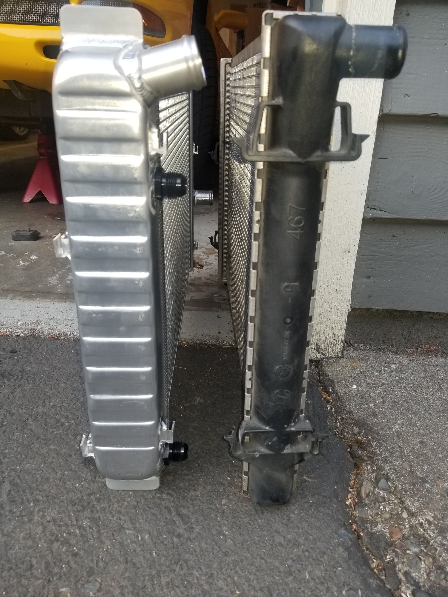

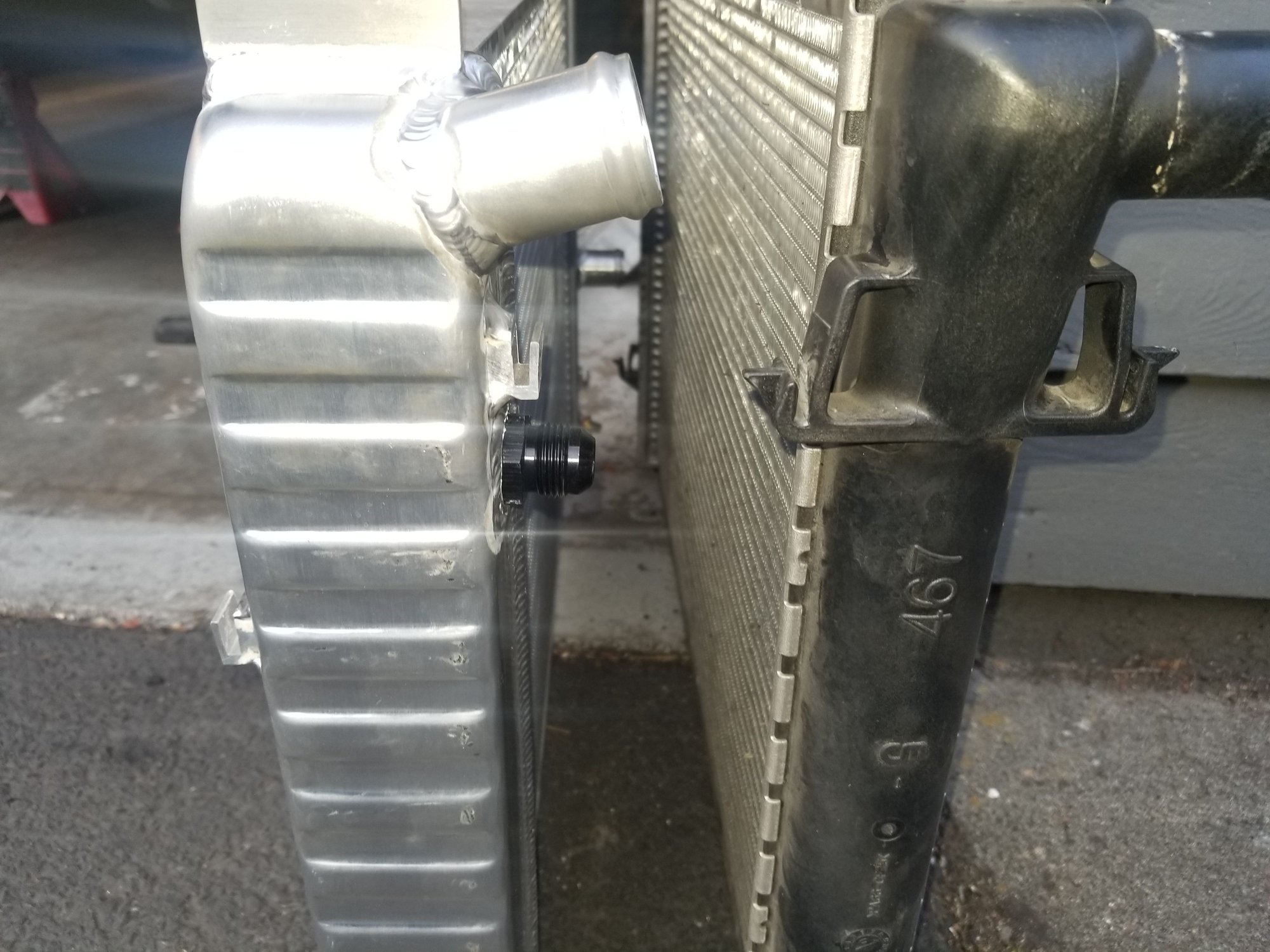

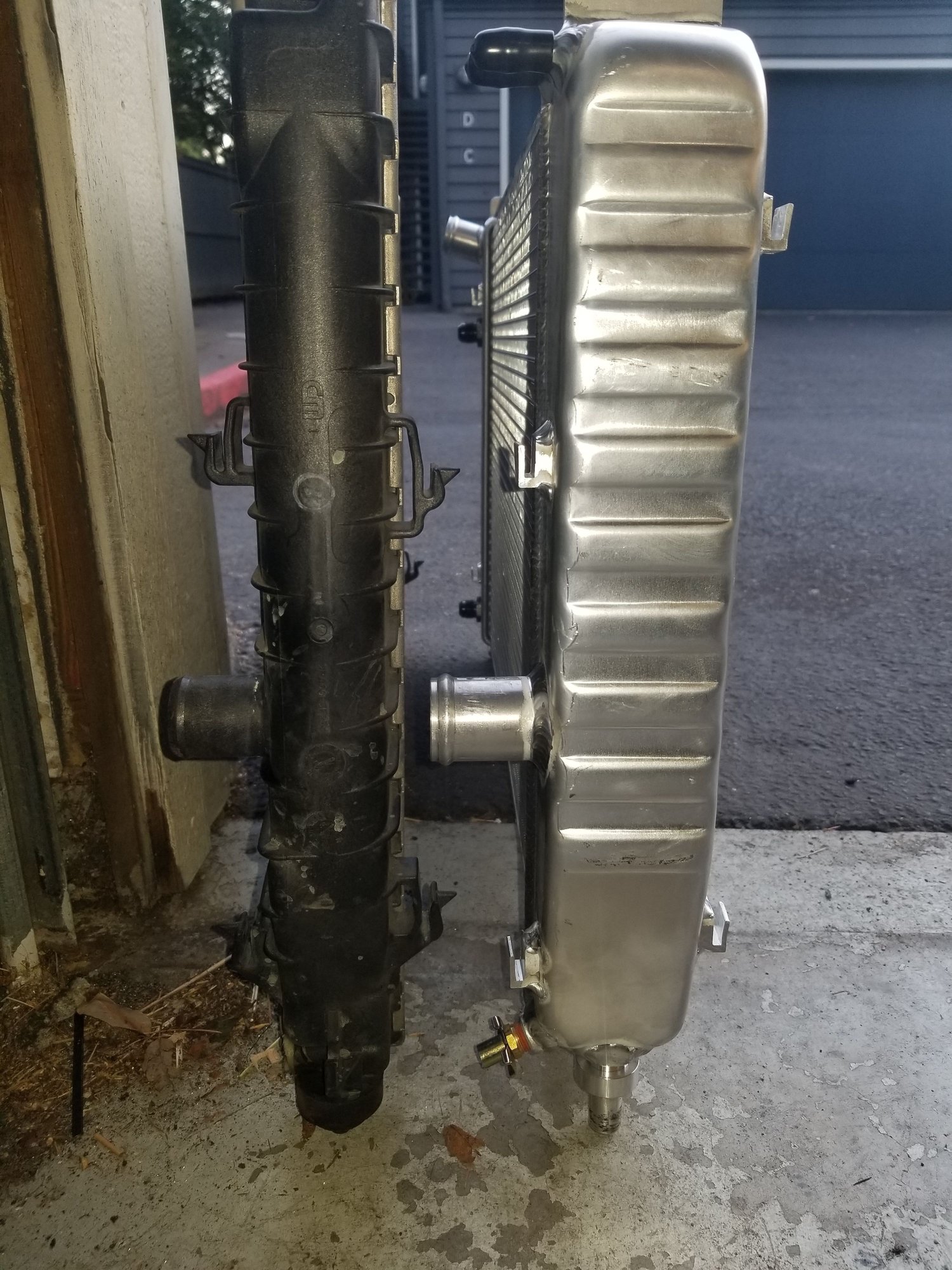

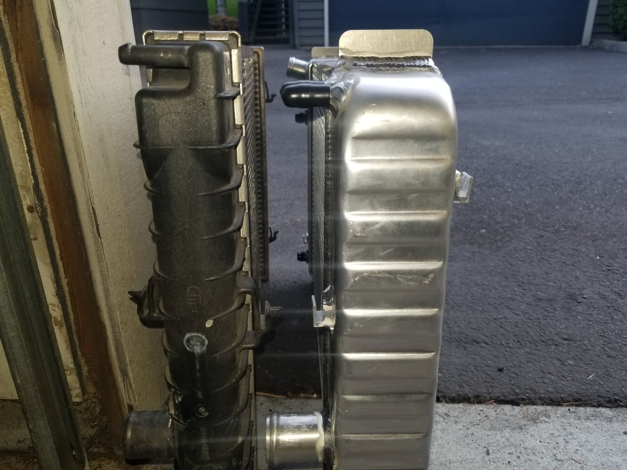

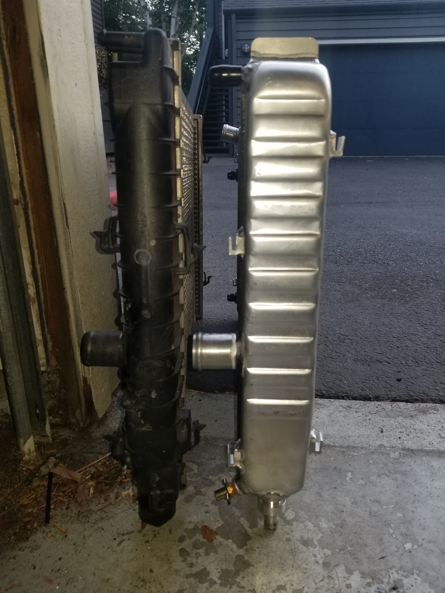

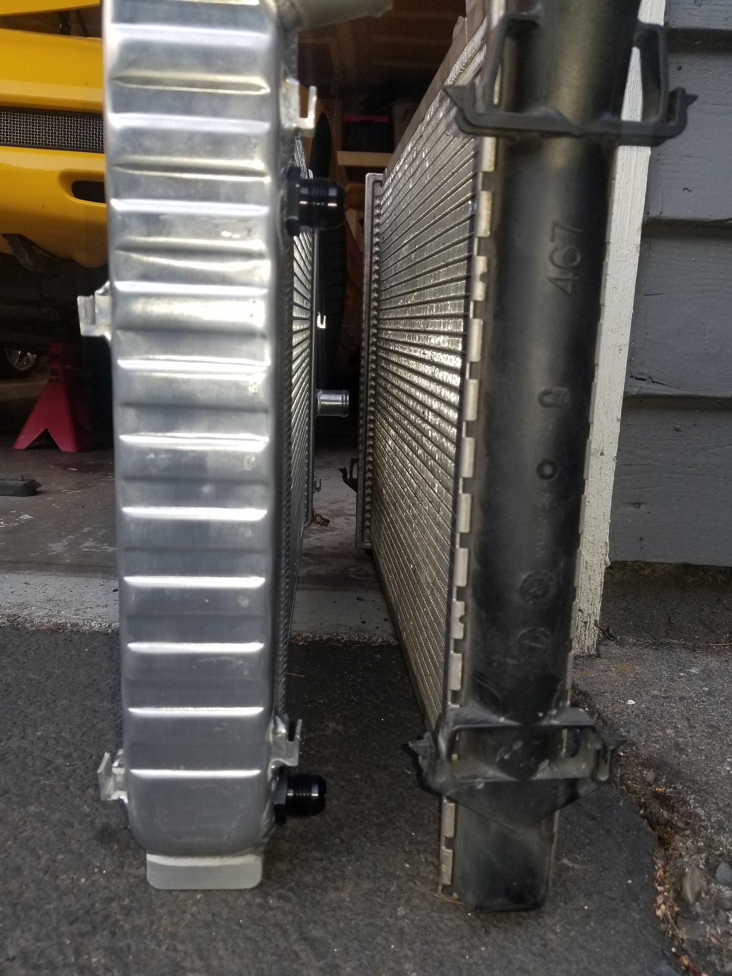

I have seen a lot of people on the forum, and Youtube, install the Dewitts Direct-Fit Radiator without any issues. However, I cannot for the life of me get it correctly installed in my 2004 z06. It seems the tabs that hold the ac condenser are in the wrong locations. I have installed a Dewitts Radiator in my 69 Camaro without issue, but that's a much easier vehicle to work on. I ordered the 32-1139097E direct-fit radiator and 32-894C oil cooler kit after speaking to Dewitt's sales rep. It has has the following stamping on the bottom: 32-1139097E, 382856-1, 4/21 JN, which tells me it should be the correct version.
I have an email and call into Dewitts, but am I overlooking something? Dewitts is a great brand and I have had nothing but success with their products, which tells me this might be a user error. Has anyone else had this issue where the Dewitt's tab mounts do not line up with the locations of the original tabs, or not being able to align the fans and condenser? With the new radiator in the car, I cannot get the fans and ac condenser back on the tabs and lined up. I have attached pictures for reference.
Any help would be great.

I just installed the same radiator in my '03 Z06 this past weekend and the condenser fit perfect. When I get home I'll check the mounting tab locations vs yours.

OK just looked at my old original radiator and it looks just like your original, the part number on the Dewitts matches your radiator, it is also marked 4/21 like yours. It's hard to photograph because my car is back together but I can see the difference between my Dewitts radiator and where your condenser mounting tabs are on your Dewitts.
100% your Dewitts radiator was made wrong. Send it back.
Yep, send it back
