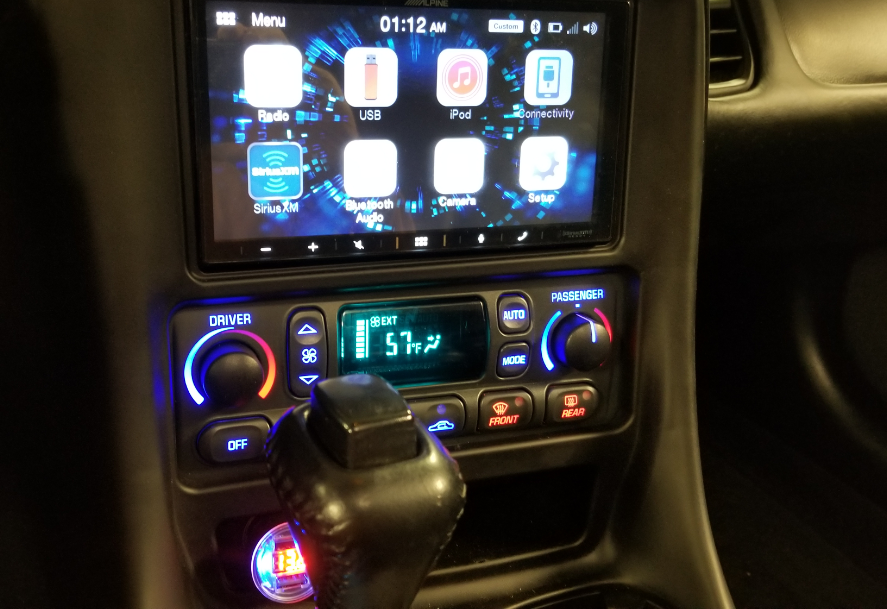

Same here. I had a dead board and half my lights didn't work. Did the full upgrade to the color scheme I wanted and it looks fantastic. Good customer service too, he gave me a call to discuss the repair.
