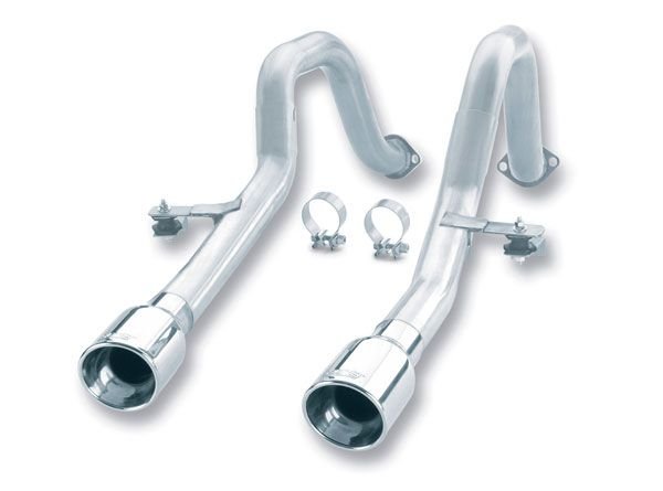

The Borla straight pipe kit mounts off the upper sway bar bolt. It looks about the same place those pipe hangers are. You would need to make a bracket for them, but it wouldnt be too difficult.

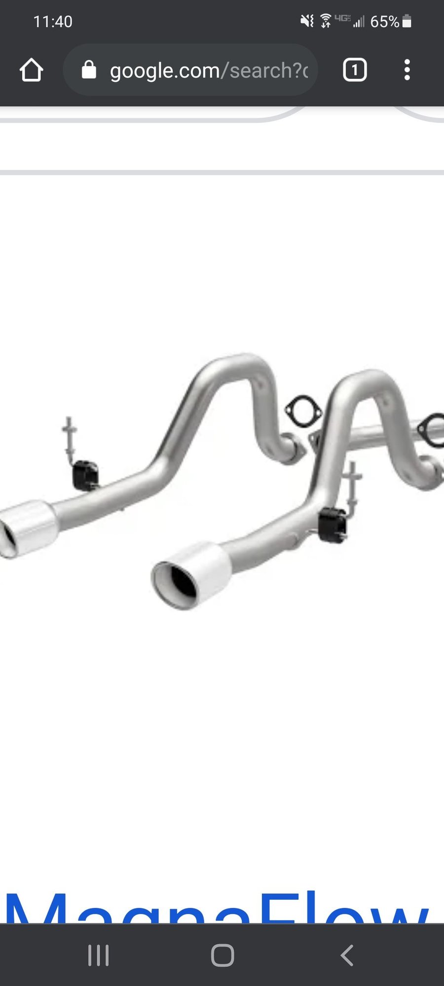

Thank you. I noticed the borla mounts to the sway bar brackets. It seems like magnaflow had one like this but never came across the mounts for it

It appears magnaflow uses some type of j hook bolt and run of the mill rubber hanger

If its a good deal buy them. It seems like it would be pretty simple to fab a bracket either way.
