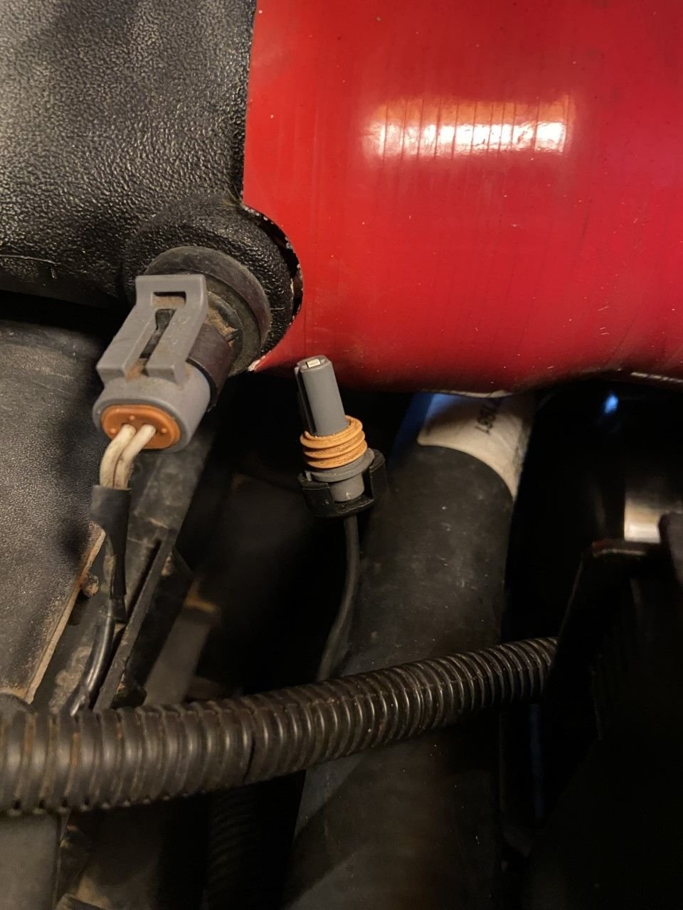

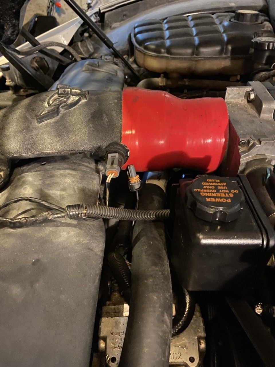

Hello, I hope someone can identify a mystery sensor plug for me. I removed the smog system and installed long tube headers on my base 2000 coupe, so I might have unplugged it during the process, but I didn't notice it until afterwards. It exits the harness at the same place as the EBCM wires. Thanks

What are the wire colors ????

The wire is black

If it’s a single black wire I can’t think of one off the top of my head !!…will have to look.

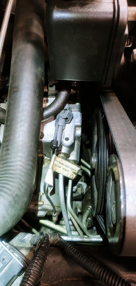

Look at your "ABS pump" or BPMV. The connector should be connected to the back side of it as seen here on mine. Odds are yours had fallen down to the sides or back of the pump.
