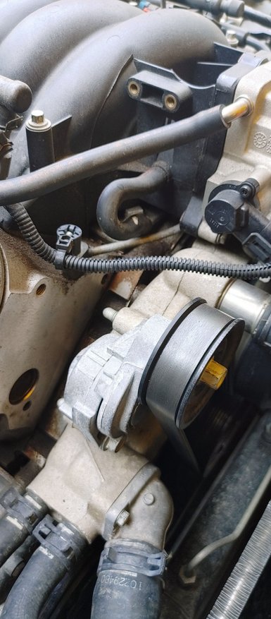

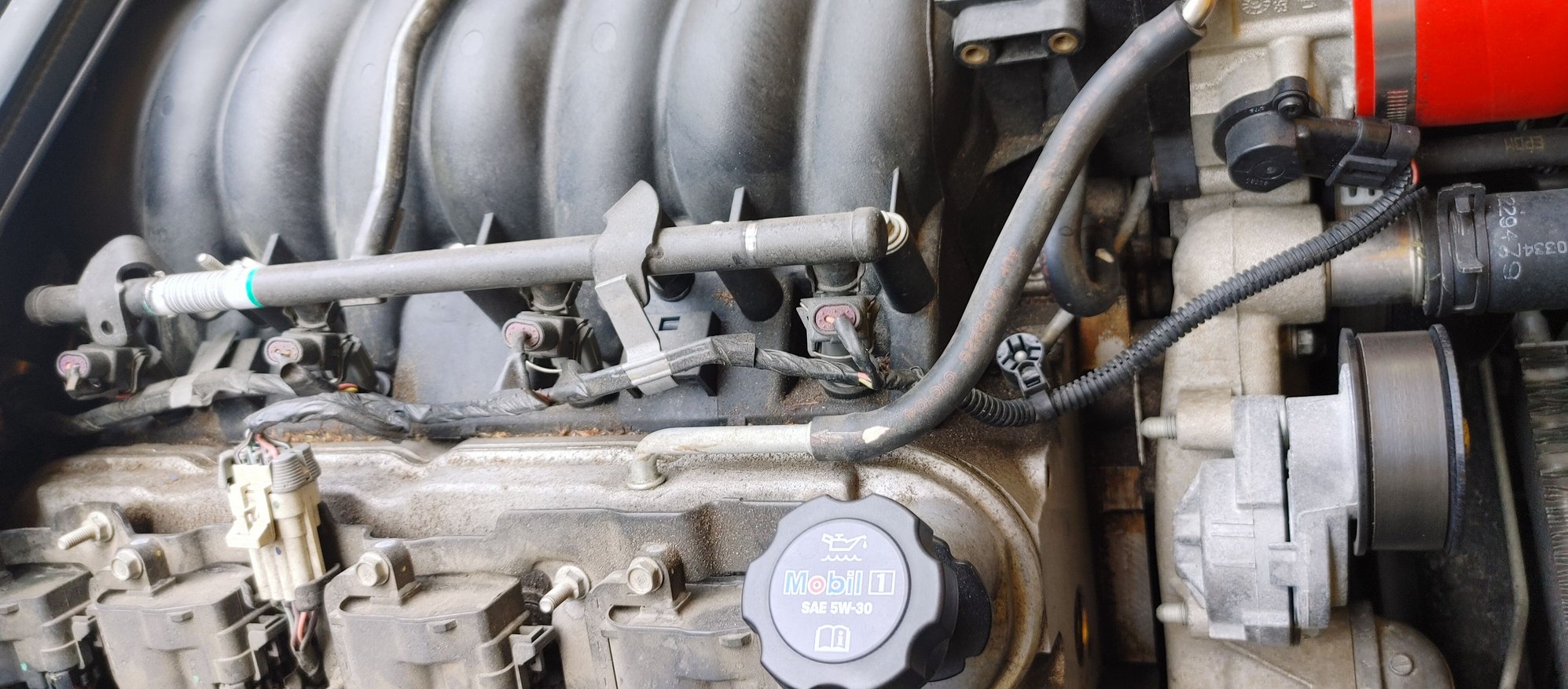

Owned my 2004 Z06 for a few weeks and absolutely love the car - Has CAI, Headers and hi-flow cats - not sure of other mods. Car threw a P0172 and a P0175 -started to dig a bit and noticed I dont see a PCV anywhere? Have been reading a bunch of things online and got confused - I see that the LS6 does not have hose to the left (driver) side valve cover- its capped but I thought there should be an inline PCV. where is the PCV Valve? Thanks in advance.

your car has the correct pcv configuration. the metering orifice is a plastic box attached to the valley cover and can only be seen by removing the intake and valley cover. Very unlikely to be associated with the p0172,0175 codes.
These codes indicate a rich condition. You can throw hundreds of $ worth of parts at the car , or try some simple fixes. First if you have a blocked air intake path like a clogged filter, that is your first check. If you have, say an aftermarket K&N filter, people very often over oil them and F U the MAF sensor. The first thing I would do is CAREFULLY clean the MAF filaments. (search this forum) . The MAF is right behind the filter air box in the air intake path. If a dirty MAF is not the cause, then you will need a scan tool to look at MAF and MAP performance, O2 sensor performance. Then you will need to have a fuel rail pressure gauge to make sure you don’t have too much fuel pressure (unlikely). Bad wiring to the MAF or IAT is a possibility, but you would have additional circuit high or circuit low codes as well. When you take out the MAF for cleaning, just be careful with the electrical connector.
thanks for the reply - tthat explains wy I could not locate the PCV - the CAI intake is the Vararam - I will check the filter and MAF

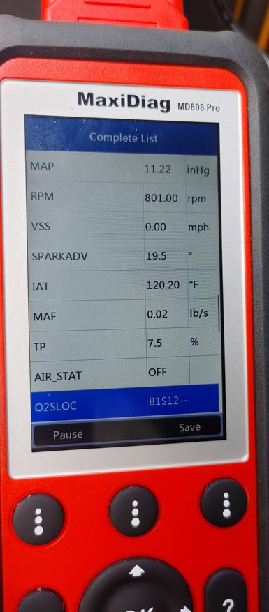

So you have a scan tool. GREAT!!! use that first before taking anything apart.
1.Check to see if you are in open or closed loop.
2. With the engine at idle, check the MAF reading in grams/sec. The number should be close to 5.7, the displacement of the engine. If it is much higher, then you may be in for replacing theMAF. A dirty MAF may under report air delivery. so if high it is usually an electronic failure of theMAF. A dirty throttle body could be sticking open, but this would show up as a high idle. Idle speeds are different auto vs 6sp.
The PCM sets injector pulse width initially based on air flow measured by the MAF. (unless you have had a “tune”). The O2 sensors then sense the amount of oxygen after combustion and correct fuel delivery based on trying to achieve 14.7 to one air to fuel ratio. So,
3. is to look at fuel trims If everything is hunky-dory, short terms will be oscilllating around 0 long terms 5 or less. For your codes, the 02 sensors are telling the system to pull fuel delivery.
4. O2 sensors could be wonky, but since you have both banks rich, this is not likely. One bank failing, for sure, but 2 independent components failing at the same time not likely. So you’re quest is probably going to be on the air intake side.
5. Since you aren’t reporting misfires, we can rule out ignition, spark plugs, wires etc. for the time being.
6. for a short time, take out the air filter and see if the MAF number changes at idle.
I’m on my second glass of Jameson, so I’m running a bit rich at the moment. My mode is to first try to fix no parts needed.
haha.... Not sure how deep you are in the Jameson by now but.....
The MAF is registering low... . 02. When I removed the Map, it was dirty. I cleaned it and reinstalled. Will scan again later. I myself started on some Johnnie Walker and need to stop wrenching 🤪. Anyway, thanks for the reply... Will post my findings tomorrow. Cheers

When you get back to your scanner, see if it will data-log. If so, you can test the MAF by capturing the MAF reading as a function of RPM. Record the MAF at 1000, 1500,2000,2500 and 3000 RPM. Then plot it on graph paper or EXCEL. If the MAF is working correctly, the plot should be a straight line.
See if you can change the MAF units to g/s, grams/second on your scan tool

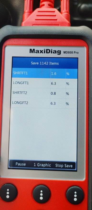

ok... Clear head... So I can not change the maf units. I did notice the maf is showing similar readings as before the cleaning. The short fuel trim is oscillating between 0.8 and 6. There is no misfires and car pulls nicely.

In post 3 your scan tool reports .02lb/s. I googled a conversion and got 9.07 g/s. your TPS (throttle position) is 7%, basically fully closed, so your g/s for your engine should be approx 5.7 So I think your MAF may be reading way high, which would explain the rich conditions setting the rich codes. However today’s fuel trims, while not perfect, should not be tossing 0172,0175. Also, independent of me do a conversion from lb/s to g/s to see if my google agrees with your google (internet trust issue w/me)
Time to clear these codes drive a bit and see if they come back
Can your scan tool report readiness monitors? if so, see if they all report ready. This may be called a mode 6 report on your tool. The readiness monitors replaced the tail pipe sniffers for inspections. Here in NC you can have 1 DTC code with all readiness monitors saying OK provided no check engine light.
My 2002 Z has always reported high MAF flow at idle. The Z06’s don’t have the honeycomb screen, so this could be normal. At idle, mine reads about 6.8 g/s and fuel trims spot on. Be careful if you decide to replace your MAF. There are a lot of knock-offs and both ebay and the big A sell “genuine” AC Delco that are frauds.
thanks again for the info.... So I cleared the code but the light came back. My scan tool does have readiness monitors and all are reading OK except the evap. It's says "Inc". Anyway, the MAF was replaced at some point, it's a Delphi unit. Anyway, I'm gonna order a new MAF and see if that helps.... Not sure where else to go. Car is running good but I can smell it's running rich at times. One question though, is there anyway to tell if the car had a tune using the scanner? Thanks again. Mark

Typically, the unscreened Z06 MAF sensor does not work well with a Vararam unless it's tuned. Where is the MAF sensor installed, near the throttle body or near the filter housing?
The readiness monitors reset every time you clear the DTC codes so that'd be why you have an incomplete monitor. Not a big deal unless you drive it a few times and it never sets. Typically though, they will either set or stay incomplete and eventually throw a code.
That scan tool is only showing 2 decimal places for the flow so that could possibly represent a number between 0.011 to 0.02 or 0.015 to 0.0249 depending on how it handles rounding. Point is that I wouldn't read too much into that number. The required resolution is simply not there.
