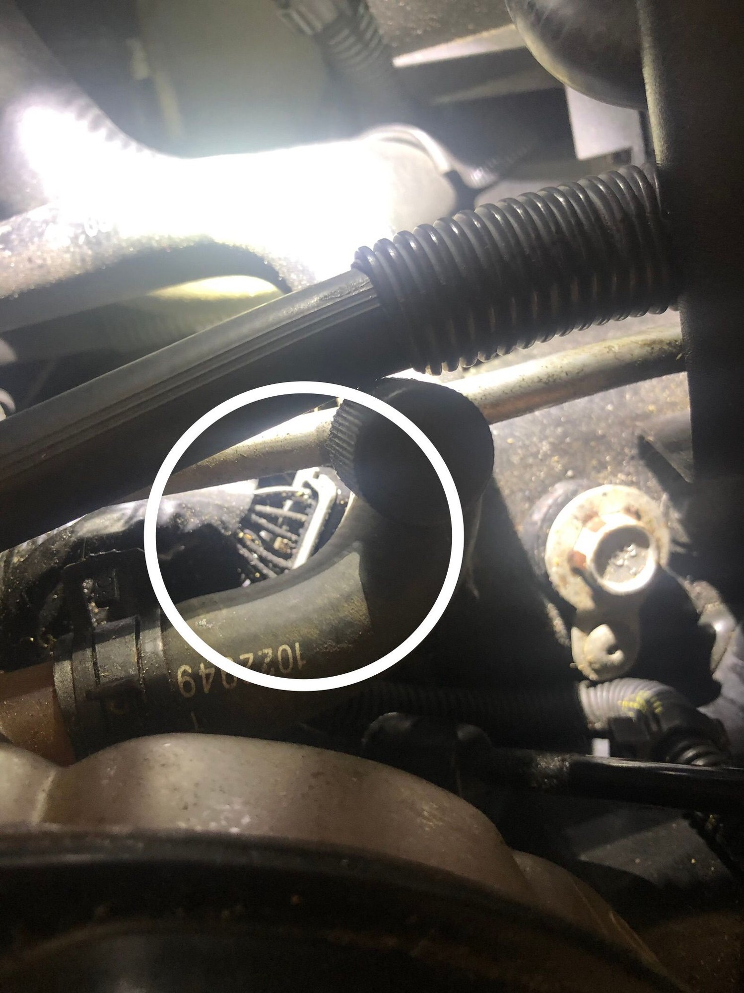

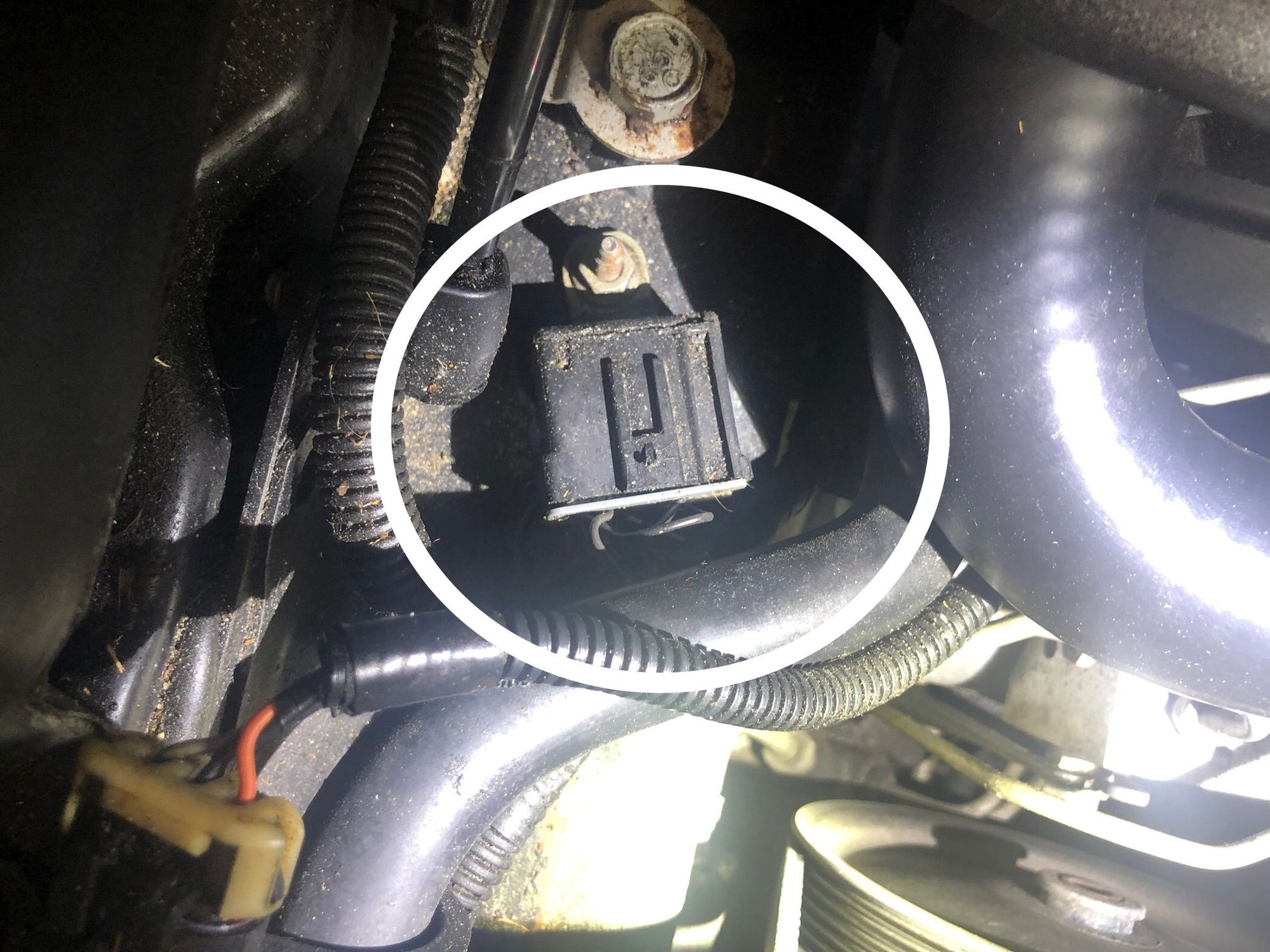

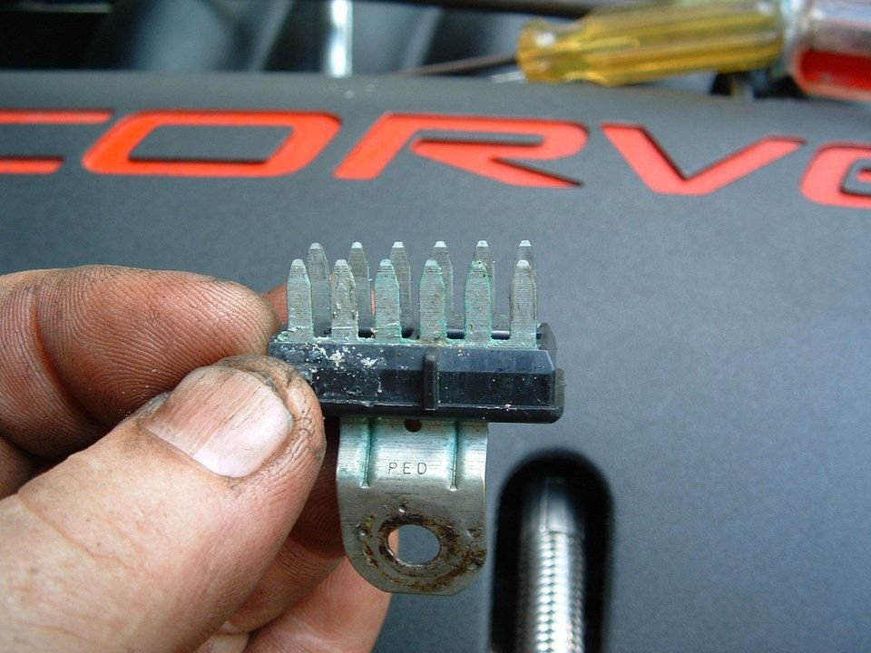

We just had someone today with some dim headlight bulbs…remove G101 and G102 which are behind the headlight buckets…pop the “comb” (pictured) from both grounds…clean comb with sandpaper and connector with contact cleaner and reinstall !!…try that !!

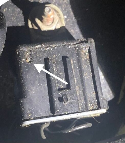

I remember popping off that comb you had to pinch this area on both sides (arrow) to remove it !!

Well that fixed it!
There was zero corrosion on either comb.
What was suspect was the contact with the ground stud...
I cleaned up the contact surfaces and that did it!
