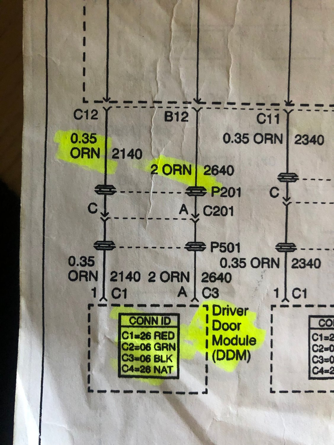

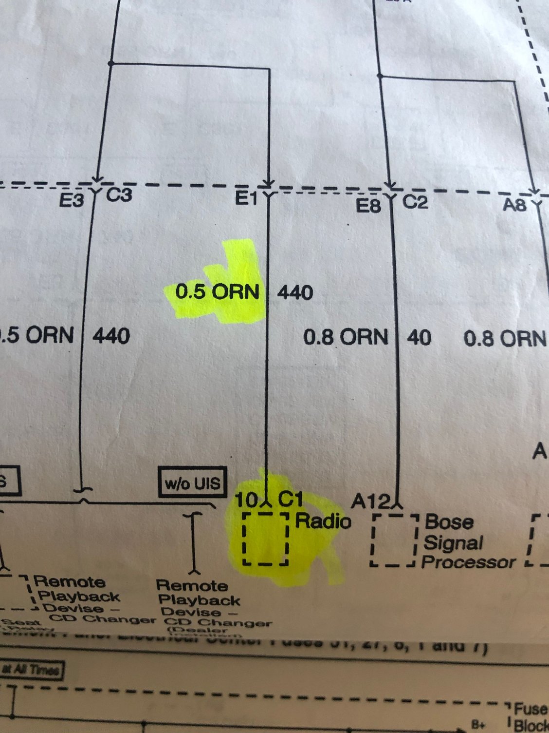

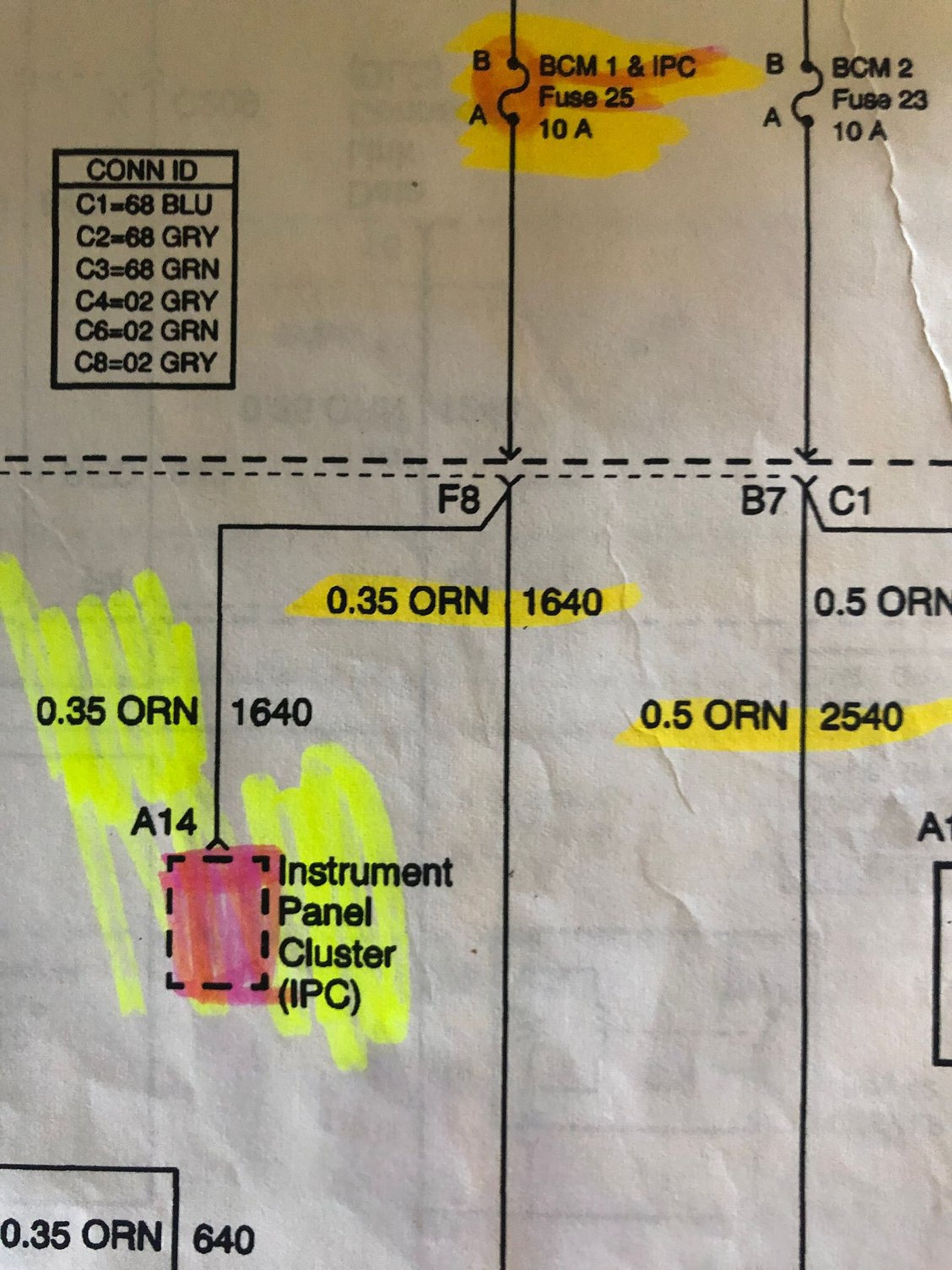

When you see a bunch of unrelated components fail like yours...think ignition switch !!...I just looked at my 2001 FSM wiring and one of the feed wires from the ignition switch (it's the orange wire) feeds all the circuits you're having trouble with...if you know your way around a DVOM I can show you how to confirm it's bad when it happens !!...and stick with an OEM switch. I replaced mine about 2 years ago. We must have had another member with the same issue since I had all those components highlighted…LOL !!
