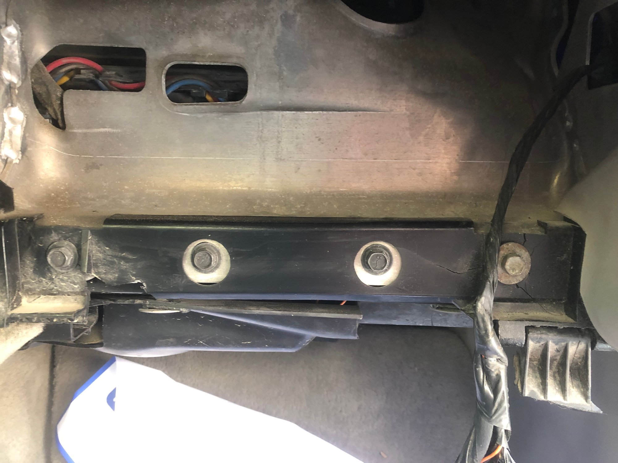

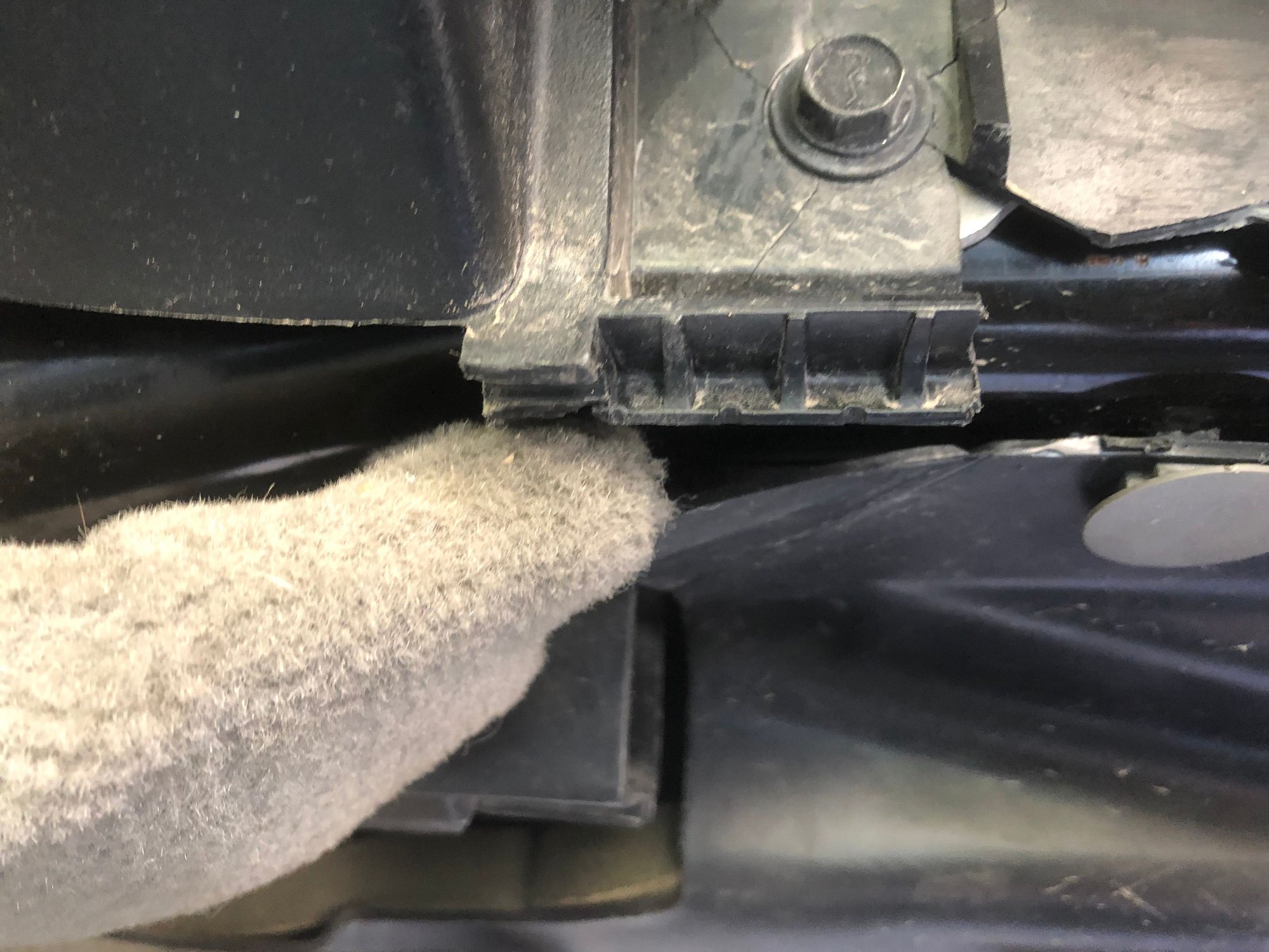

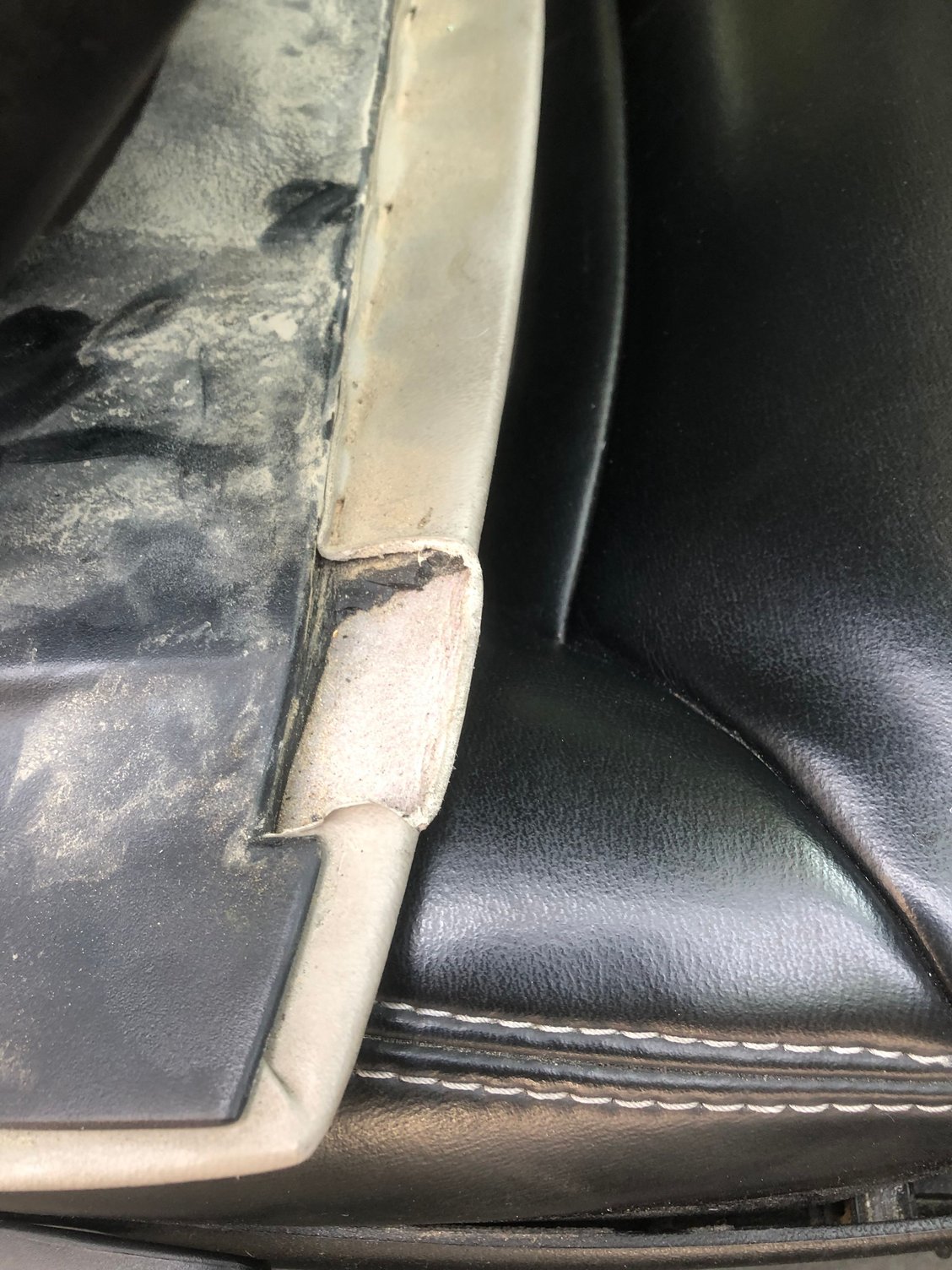

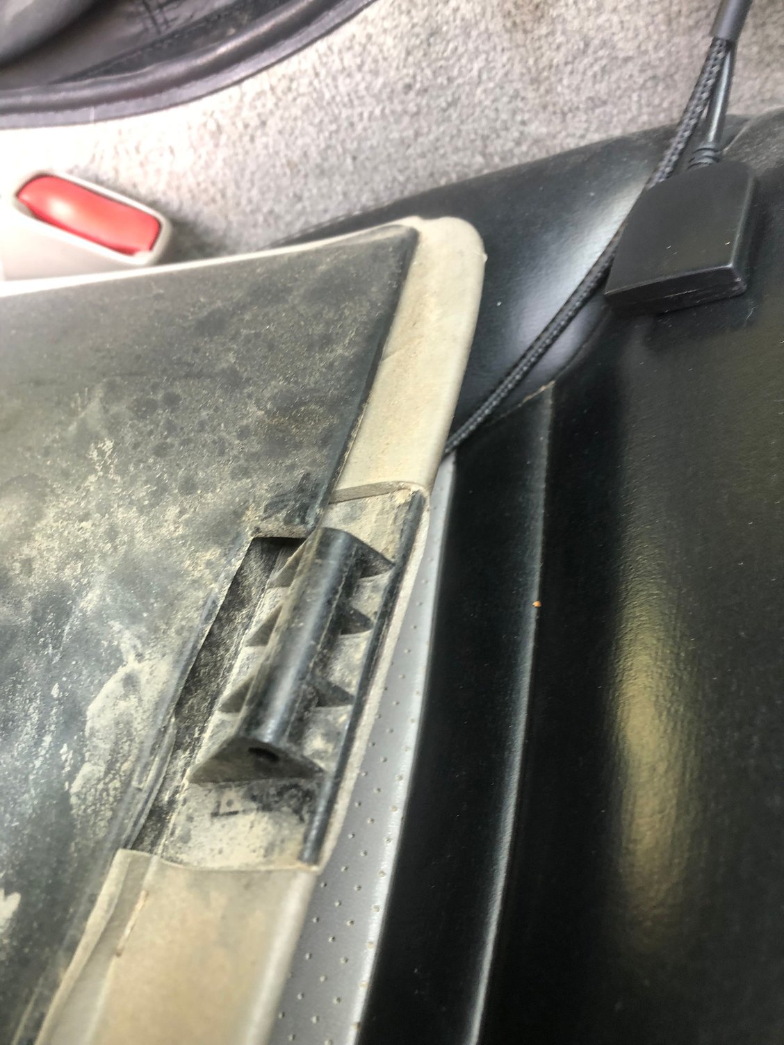

As the whole compartment is messed up - with latch missing, hinges broken apart and - what is looking worse - hinges fitment broken at the frame, need advise / list of PNs to look for to replace.
Assuming it should be the whole assembly (black is 10327000 ?) + frame (?) + pins (10280060 ?) + latch (10328822 ?) + lock cylinder (12534394 ?).
Should I keep anything else in mind ?
Photos:
Thanks !

I would suggest you contact vettenuts, they are a corvette salvage yard, as finding new replacement pieces may be hard to do.

This assembly is a pretty common failure point on these cars. It doesn't need to be removed very often, but if care is not taken the plastic framework is fragile and it can break. I discovered the glove-box framework on my 4 year old (at the time) C5 was broken also. All of my pieces were still there, just broken, so I was able to fabricate an aluminum reinforcement to keep mine functional.

I’m pretty sure that a latch kit and front cover is available from vendors. My 03 GB was a total mess outside of the latch and cover. Sagging when open due to missing the left side, cover side hinge. I was also missing several pieces of the mounting sections. I bought a plastic welding kit from Amazon that included plastic welding rods and metal mesh. Tack weld pieces back in place and used lots of mesh to reinforce the mounting areas and where needed elsewhere, then fill in the tack areas. Watch a few vids on how to use the welder. Since I didn’t have a left side hinge, I drilled two small holes through the GB cover and used a series of zip ties to secure the remaining part of the hinge. The holes are so small and low on the cover they are unnoticeable. Tip: I only had the right side hinge with pin. My right side hinge tapped out from left to right. One side of the pin is knurled fatter than the other.
