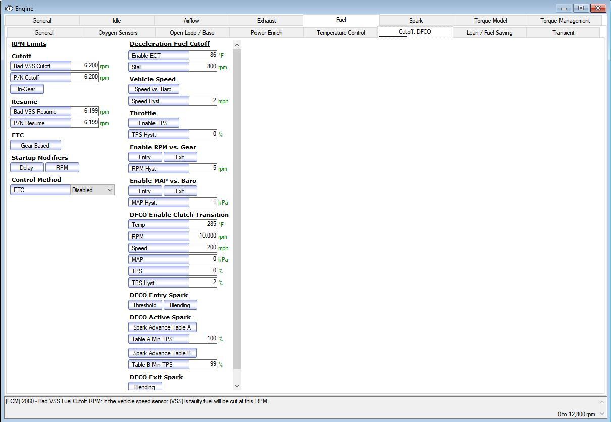

If you get HP Tuners this is where you can change your RPM limiter. If you have a cam and what not they may have increased your limiter to take advantage of the top end power gains but this is where you would check and make any changes you wanted to.
