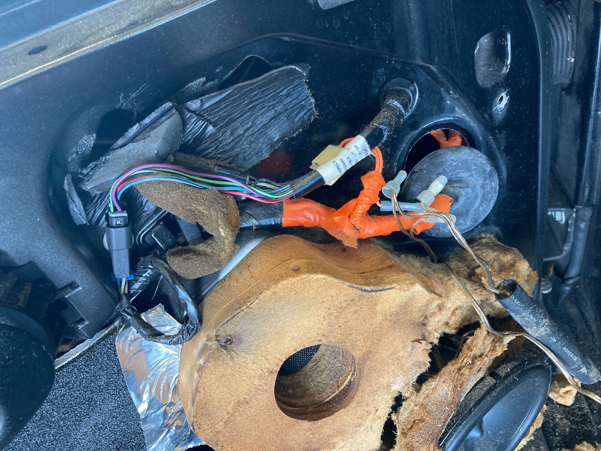

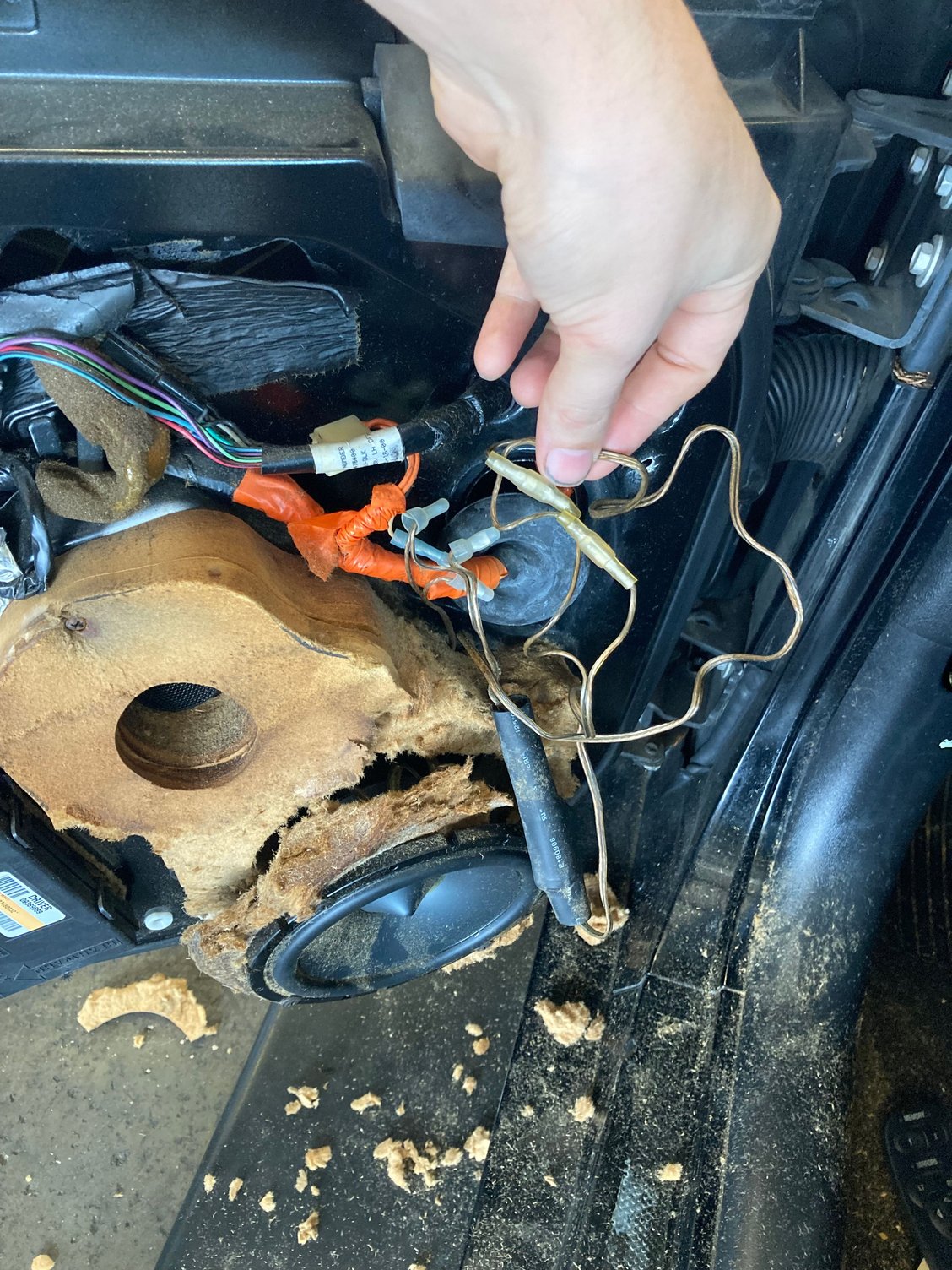

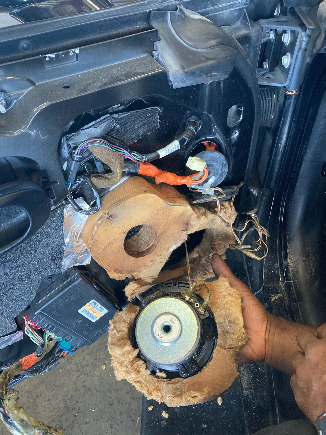

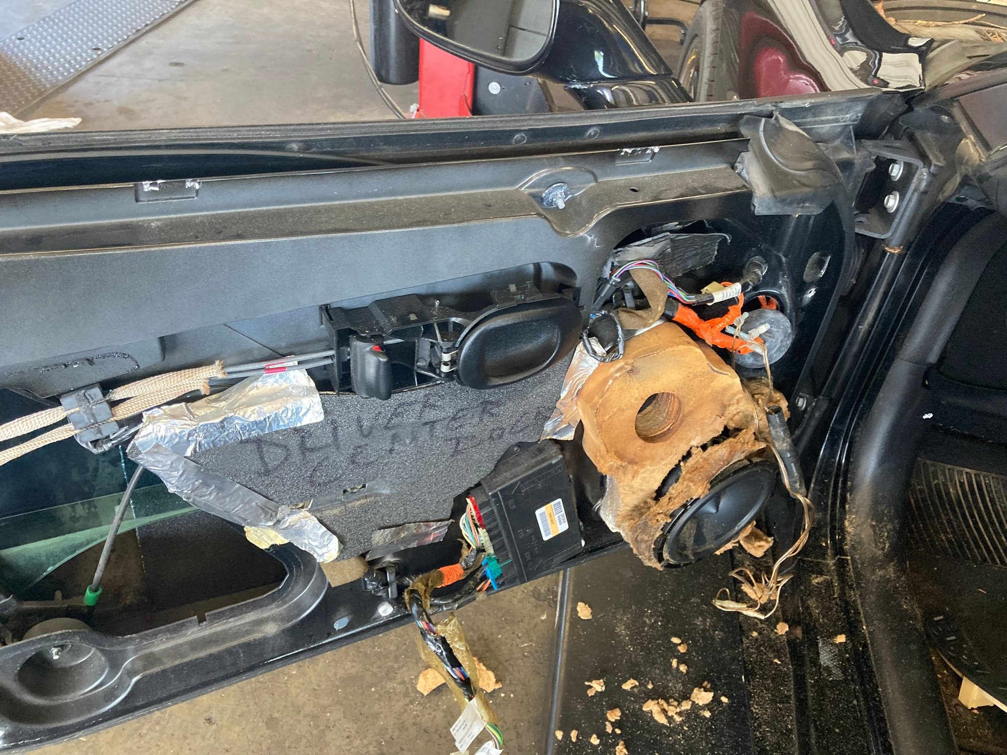

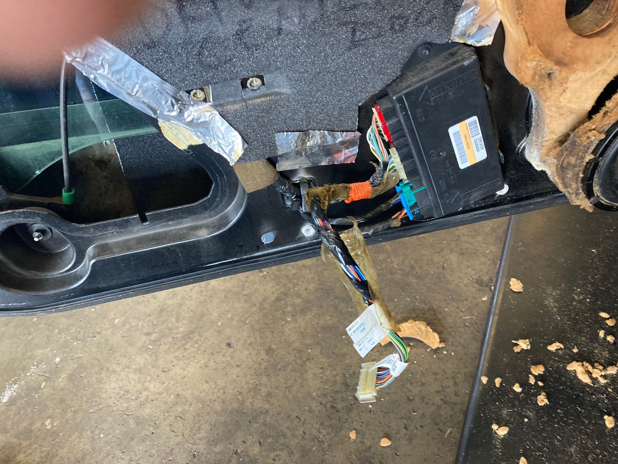

Just an update for you guys...
I just got the RR Wheel Speed sensor replaced - No more TCS errors.
If I just slightly bump the wires in the door accordion the whole door panel will turn off.
This is what my door panel looked like when they opened it.
Could this result in a voltage drain if the door panel is malfunctioning constantly?

They could not make heads or tails out of what wire the twist connectors go into. So I am taking it to a car audio specialist on monday. To make sure all of the wiring is fixed once and for all.
As you can see the MDF speaker plates expanded big time for some reason. Those speaker mounting plates were originally 1/2 MDF or 5/8 MDF.
They will install new speaker mounting plates too on monday.
As far as C1235, the wire was badly frayed and cut since it had fell off the clip and rubbed up against the wheel severing the connection to the right rear speed sensor.
