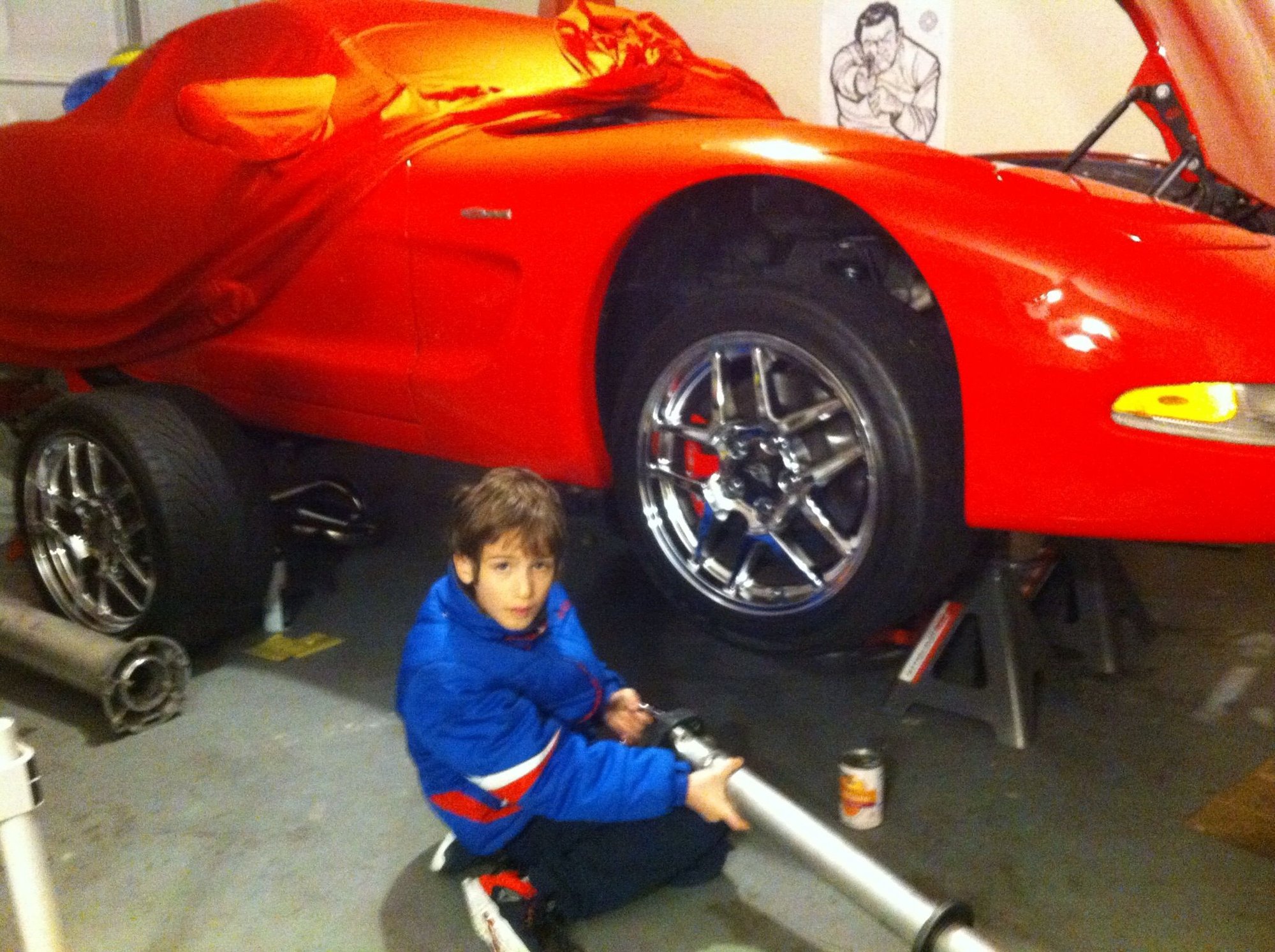

My TT was bent, killed the pilot bearing. I bought a like-new prop shaft from a member here. Also installed a new input (splined) shaft, new bearings and new GM couplers. I had around $1860 in parts spent.
Along with a new twin disc clutch, Elite tunnel plate, master/slave cylinder, bleeder, and full transmission rebuild and upgrade, both axles, both rear hubs, ball joints, I had over $6k in parts.
Labor was free. I had my kid do all the work.
