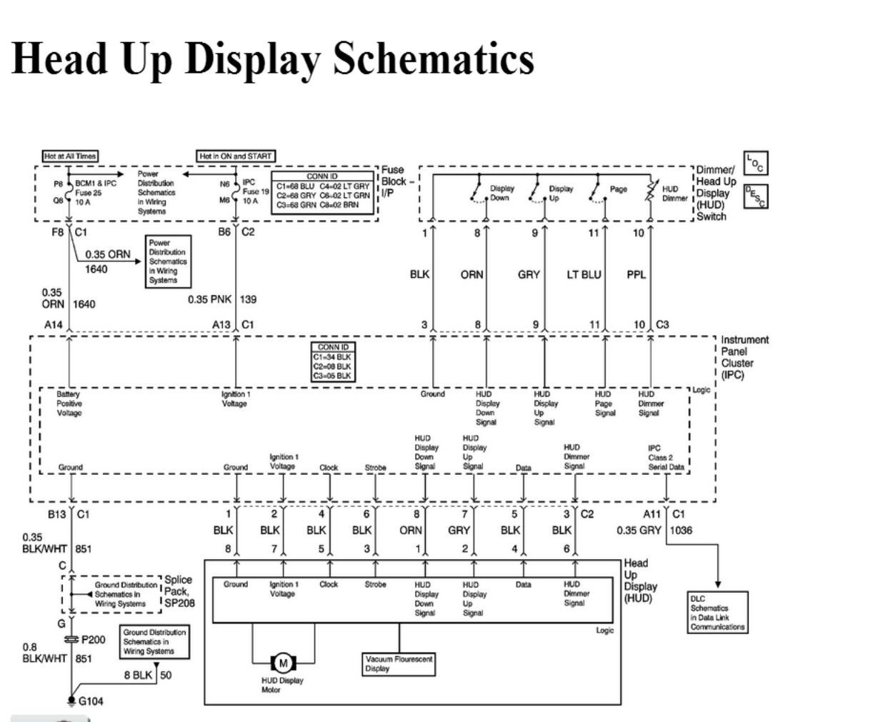

I just got my 2002 c5 and the HUD doesn't work. The owner's manual says to check the fuse but it doesn't tell me which one it is nor does the fuse box cover. Any help?
Old Aug 17, 2021 | 04:30 AM
oelarse's Avatar
oelarse
Joined: Jul 2011
Posts: 996
Likes: 306
From: Southern Norway , Europe
There is no single fuse for the headup display.The cluster is feeding the HUD with everything .
Here is the schematic

Thanks for the reply. Maybe you'll know something else about the HUD. When I look down on it through the windshield I can see two microswitches and the mirror that I'm guessing has to move into place? It never moves for one and it looks like there may be some debris inside. What's the best way to get into it? Is this a disassemble the whole dash kinda day or is there an easier way?
