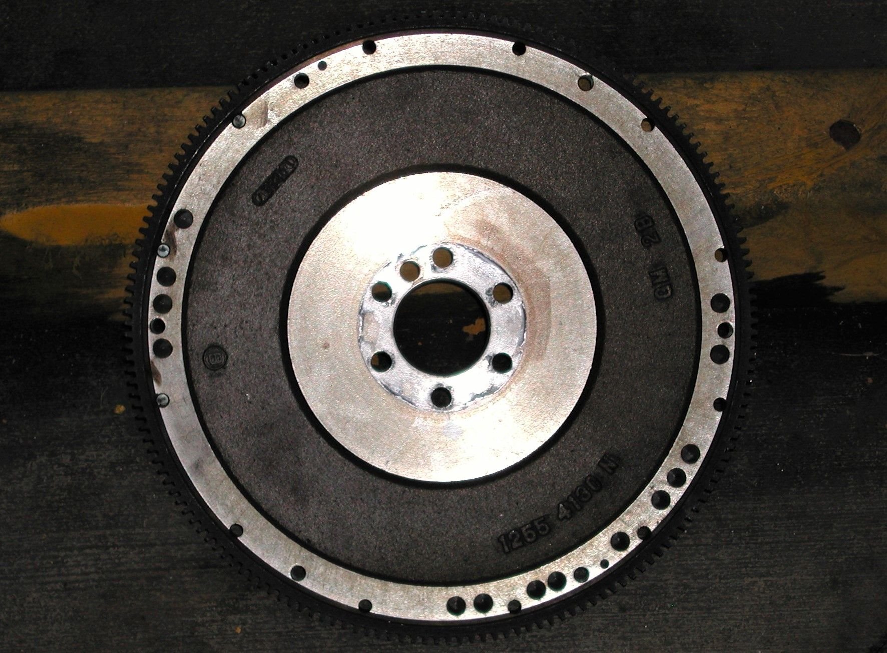

First time I changed the clutch using a zero balance assembly the engine was vibrating horribly above 2800rpm...
Fortunately I had kept the OEM Flywheel and after multiple exchanges with GM it was agreed that some engines from 2001 until mid 2002 were "assembly balanced" (costly process) and that there was two way to solve the issue after replacement:
-1) Match balanced the new flywheel to the OEM flywheel that came with the engine.
-2) take the engine apart and have the crankshaft zero balanced.
Below is the OEM Flywheel of my 2002 ZO6, one of the engine that was balanced using the flywheel...as you cam see, there are weights (tungsten I guess...) around the flywheel and holes.
Long story short, the 2002 ZO6 Flywheel in my engine in the picture below was out off balance by 37 grams...New flywheel was match balanced (meaning the new flywheel was offset of 37 grams exactly in the same location versus the central fixation bolts) and engine went back to normal, no more vibration.
