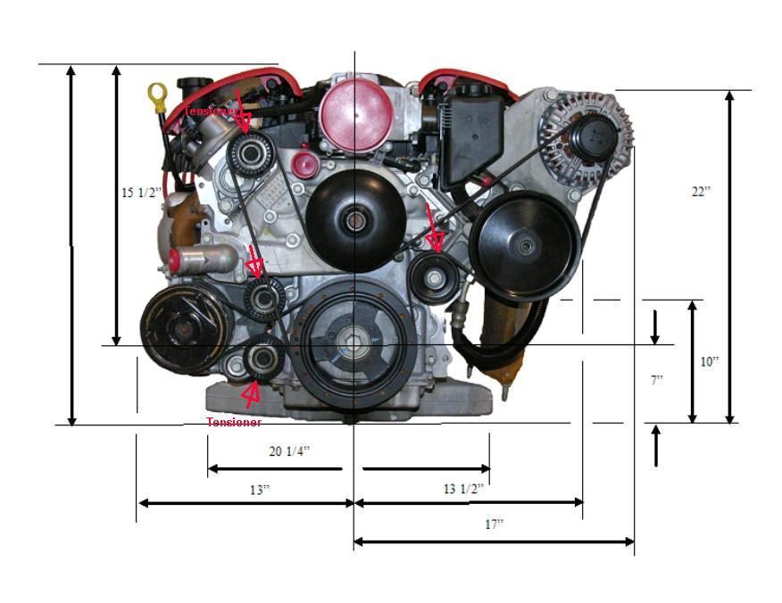

My alternator i believe is making a noise but still charges fine looks to be the original 99 alternator. I read the sticky above but will the replacement autozone alternator cause any codes or will it function just fine as it should? I noticed these have a big pressed pulley type vs the f-body ls1 bolt on pulley design. Also can you run i believe what i read the 145 amp 02-04 alternator direct fit and replacement? I read some guys other thread about balancer wobble. Any idea if a bad balancer with old rubber would make whats sounds like a marble tensioner or pulley that may sound like the alternator area but end up being a balancer? I guess ill try removing the belt to see if the noise goes away. With the belt off would there not be enough tension to cause the balancer wobble issue or help diagnose the problem?

You can buy just the de-coupler pulley if that is whats making the noise
https://www.rockauto.com/en/catalog/...or+pulley,2448
It also maybe just the idler pulley below it

It does sound to be around the alternator side or just inside of it isnt a normal squeak like i had from my old 98 ls1 camaro from 2009-2014 The tensioner would make a squeak had replaced it and i think maybe regreased or the idler pulley by pulling the seal. Sounds more of a marble wobbling type of noise at low 700 prm-1000 then goes away when revved 2-3k. Any idea if a 3/8ths hose by ear would actually work and locate the noise spot on? Mine has that big old pulley type of pressed on pulley does sound on the drivers side of engine but could be coming from center or balancer down under the alternator. Man thats a nasty pulley so its pressed on and off? 76$ any idea if you did need a replacement autozone has a 102amp duralast for 168$+13$ core and looks to have the nut style stud pulley similar to f-bodys unless the pictures arent correct. I can maybe get a 10 second video tomorrow with it running only does it at lower rpms sometimes and can only hear it with the hood up.

I took the belt off to free spin some pulleys and the alternator pulley is lacking grease as well as tensioner. I checked with a 3/8th hose and the noise is coming from around the alternator pulley bearing opening. I had regreased the tensioner pulley that had no grease and there is no noise from it with a hose or anything on that side of engine just right on the alt pulley you can hear the noise. I ordered a new old stock continental 49908 for 29.75$ off ebay this morning so hopefully does the trick. I was able to regrease the nsk tensioner bearing as it had no grease.
Are these correct before ordering Gates/AC delco 38008 tensioner pulley and dayco 89007 idler pulley for the main belt drive? Rock auto has the dayco tensioner for 11.81$ on sale More Information for DAYCO 89337 (rockauto.com) vs amazon for 43$. Is it better to purchase the whole tensioner? Does look to be a different design from stock.
