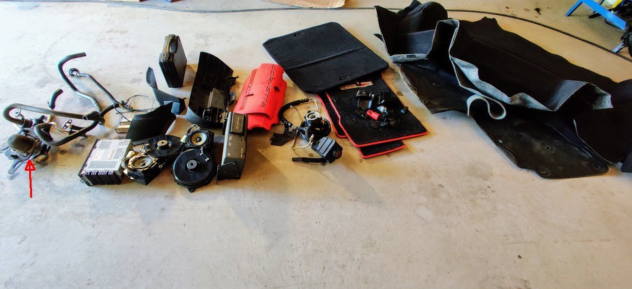

You will get the check engine light every now and then if you don't change the tune.It doesn't trigger a "reduced engine power", but I found it so annoying that I had the excuse to purchase HP Tuners
https://www.corvetteforum.com/forums...-hptuners.html
I removed all the parts to the left in this picture:
...and saved some weight as well: https://www.z06.eu/2020/07/adding-lightness.html

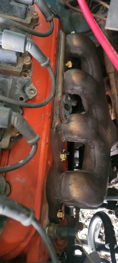

Go to your local herdware store and get some 1inch x 1/8 inch flat steel stock and make a pair. Use the gasket as a teplate if you need to
