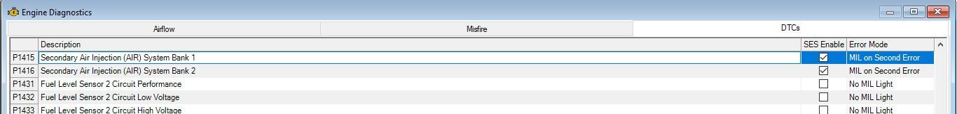

If the PCM determines that the HO2S voltages for both banks did not respond as expected during the tests,DTC P0410 sets. If only one sensor responded, the PCM sets either a DTC P1415 or P1416 to indicate onwhich bank the AIR system is inoperative.
I think you need to disable the P0410 and these two alarms with HP Tuner or EFI Live to to avoid these alarms if you remove the AIR system
