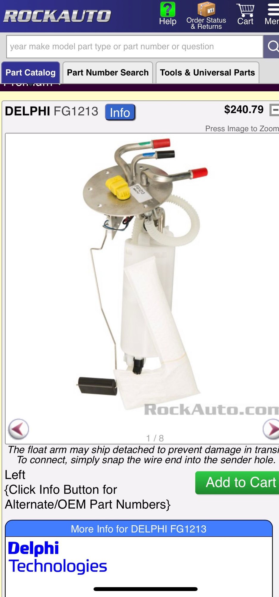

Did the dealership diagnose it as a bad pump ??…the pump is easy to replace so any good shop can do it !!…Delphi pump from Rock Auto.

Is there a different pump for the crossover? I ask because the various websites show 2 module kits--passenger and driver side.
Do both get replaced if one is bad? The tanks are drained so it would make sense to do...is that a good protocol?
But Rock Auto only shows one pump. So I'm really confused.
Sticky point: Delphi is no longer part of GM? But doesn't it make parts for GM? If so then it's same as OEM, right?

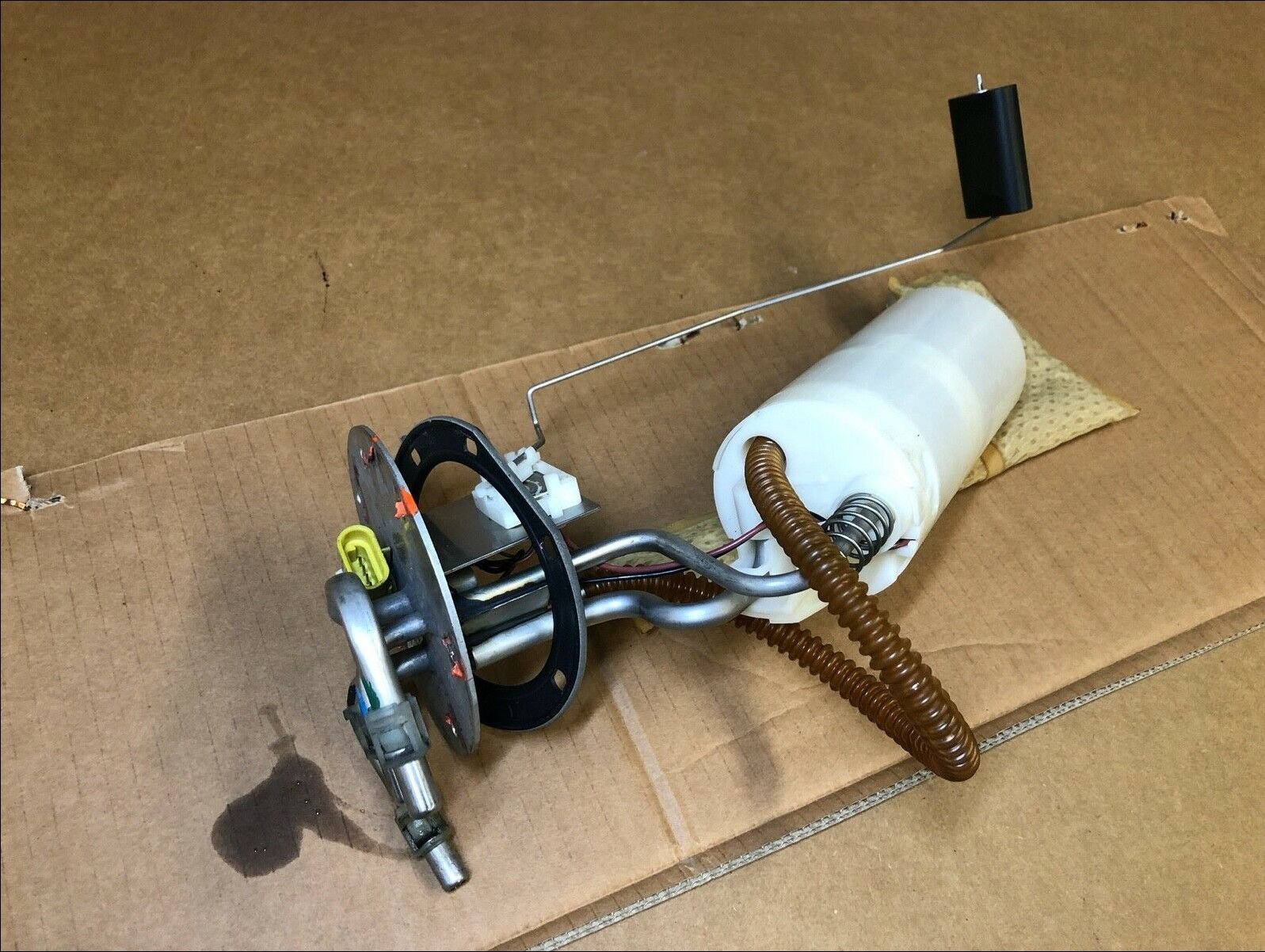

The upper photo show the siphron pump located in the passenger tank tha C5 Diag mention
The lower photo show the electrical pump i driverside tank
Electric driverside tank pump

Thanks for the info. Discovered the updated pn is 19421093 and because of your help I was able to find one at Coulter Buick-GM in Tempe AZ.
In meantime I get message that dealership is going with a Delphi FG 1213 which they are getting from NAPA.
This is after all the B.S. about using aftermarket parts or suppliers. Now, while I waited and they scratched their behinds trying to find a discontinued part...they want to charge me over $933 for an item I could have bought two weeks ago for under $400 delivered overnight. Some dealerships in Hawaii have no conscience!
