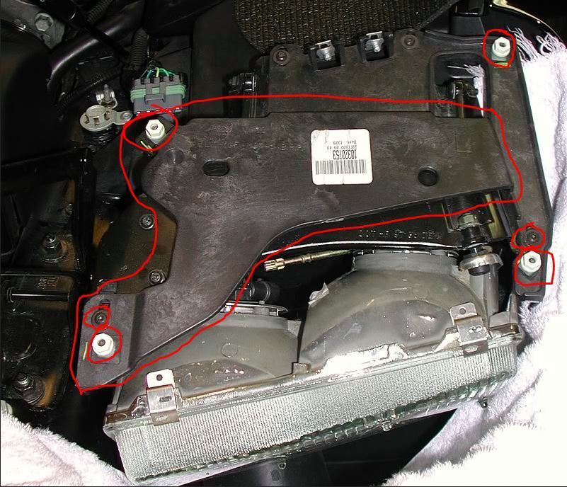

Yes, take off the panel. Then you will see this (see image below). Whole top black piece can be adjusted to all sides. White adjusters are for height alignment. It is easy job, just takes some time with couple of retries.

If I remember it correctly, you have to unscrew from sides the big black shroud covering headlight and its sides. Then pull it carefully out, because on top of it there is some piece of metal that fits to the panel that you are trying to adjust. After that you can finally unscrew that panel, 3 spots I think ( you will see it easily ), then pull it off.

That metal tab previously mentioned is attached under towards the front of the cover panel. Once you have the black plastic headlight bezel and the screws removed, the cover should slide slightly up from the back end, then forward to loosen it.
