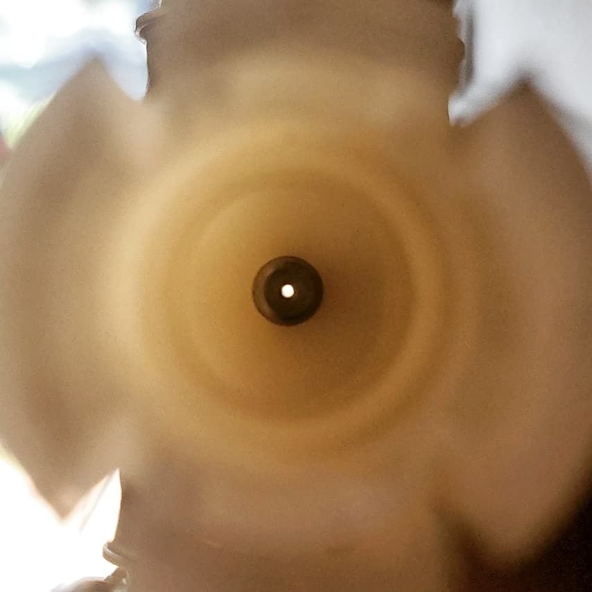

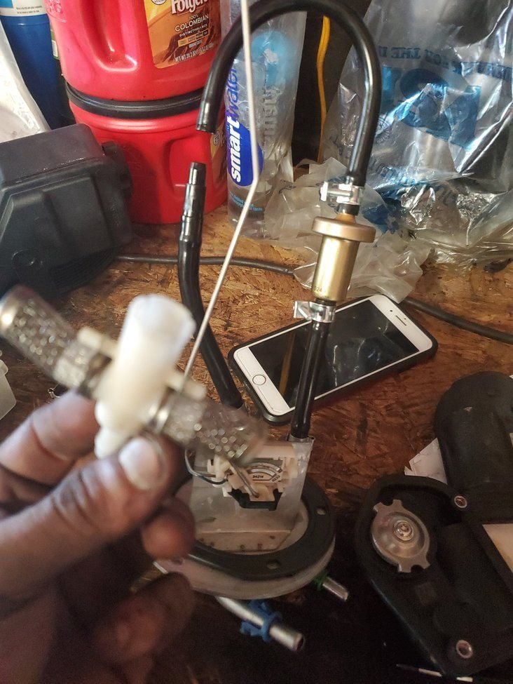

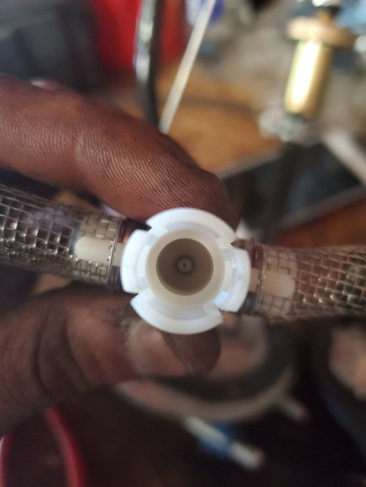

You should check this part of the siphron pump and see if it is clogged .
The second photo show a clogged part and the third photo show the part cleaned
thank you for that I will definitely have a look at it while I have everything apart. The first order of business is trying to find a new pump right now

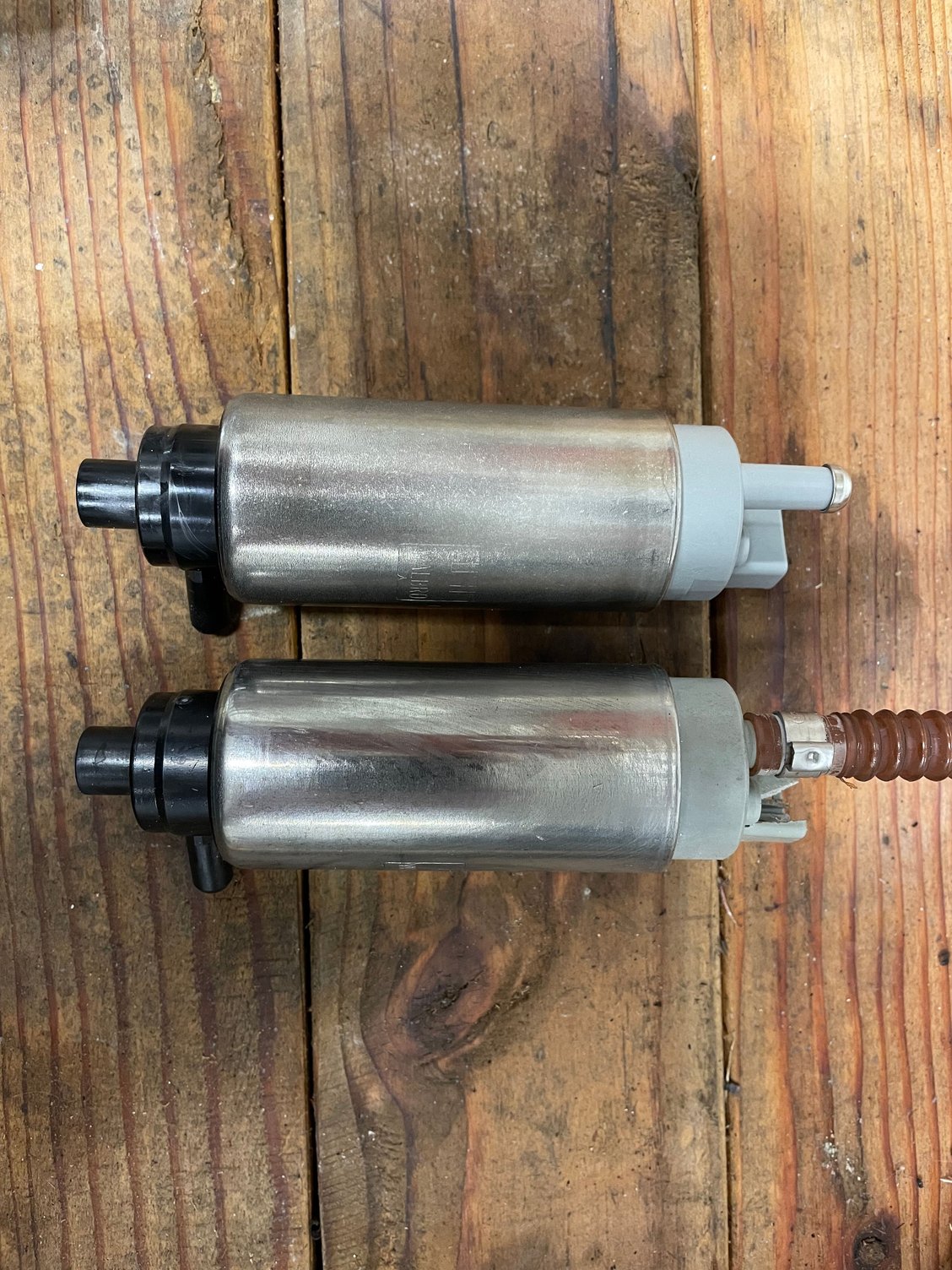

I received my replacement parts today. The GRJ-420P Had the fuel bucket, fuel sock, strainer, etc. included. The GRJ-420 only includes the pump.
I suspect this is why Racetronix is no longer able to build the kit as all of the parts are no longer available. They indicated to me they were looking for a "new source" for those parts, and no ETA on when they would start building new kits.
At this point am going to salvage everything from my original assembly and just replace the pump.
I called to check on a new fuel sock those have been discontinued I have found one that is old stock on a dealer shelf and it is $120. I will probably end up reusing the old fuel sock since the car has low miles.
The attached photo is the new pump next to the old pump.
