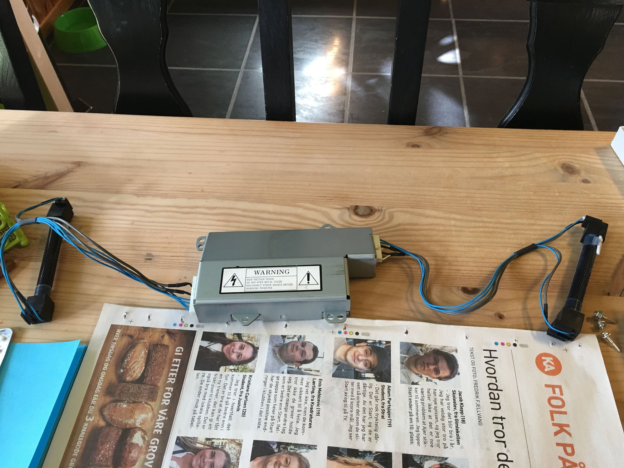

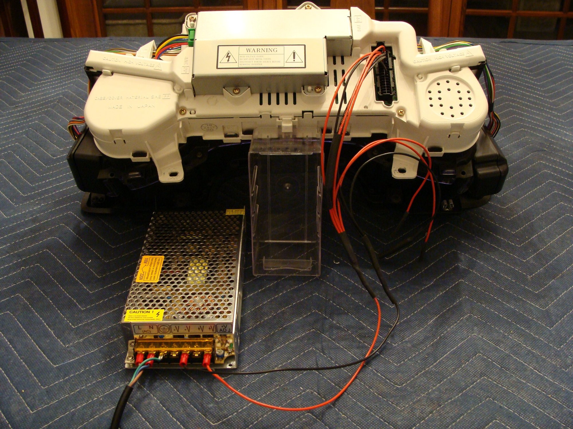

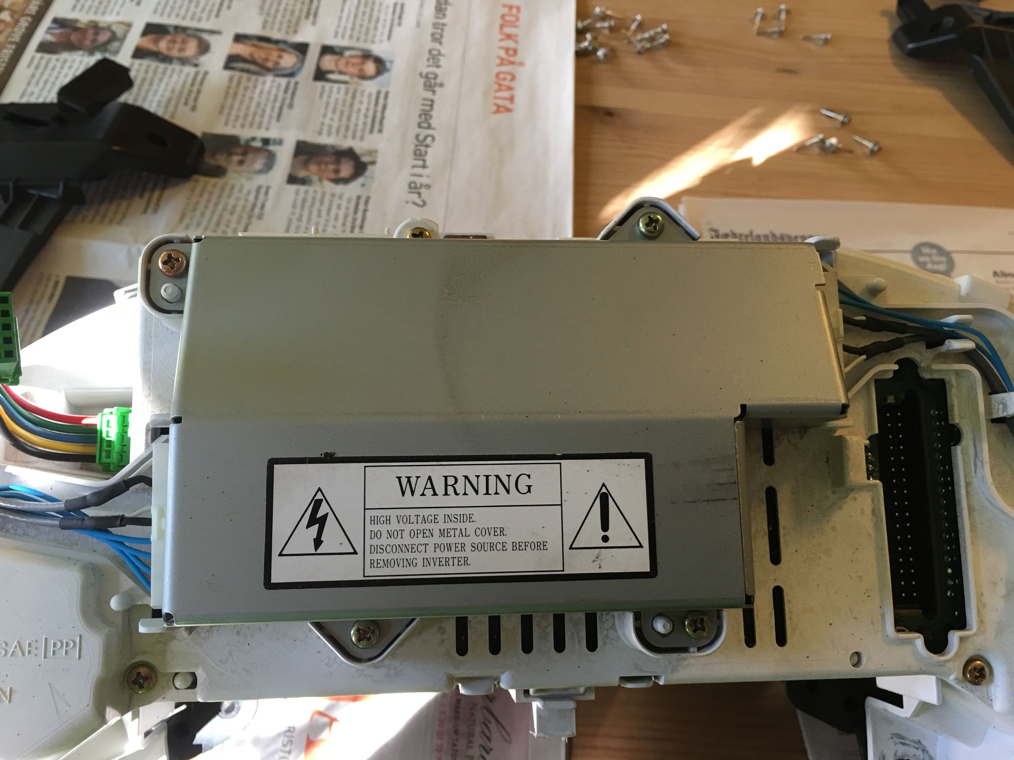

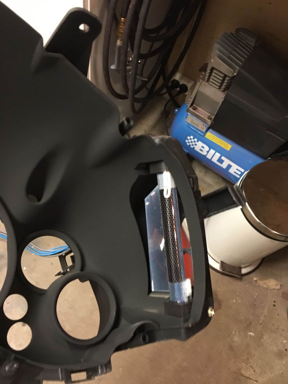

The illumination of the cluster is done with two high voltage UV lamps (one each side of the cluster) .
The powersupply may have gone be bad .
If you have access to an external powersupply it is possible to test the cluster like this
