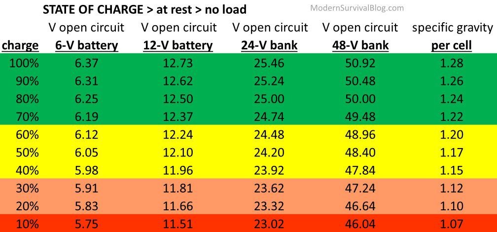

What is the voltage across the battery terminals with the engine running? Should be above 13 volts, probably 13 1/2 to 14 volts when the alternator is charging.
Voltage across the battery terminals NOT running?
With the engine NOT running and a fully charged battery, the voltage across the battery terminals should be about 12.6 volts.

Running has been around 14.2 volts at terminals. Engine off is 12.2 volts, brand new battery (might need some driving to push it up the last fraction of a volt). But battery was on a smart charger as I waited for parts.

12.2 volts is about 55% charge.
