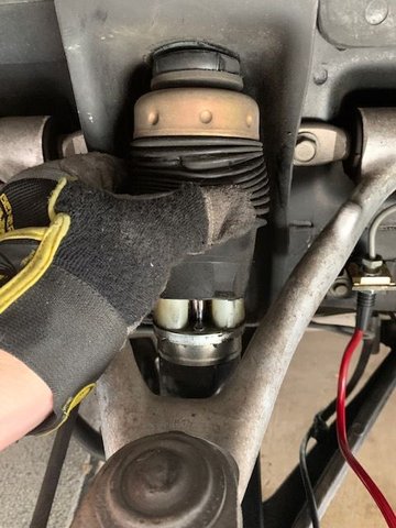

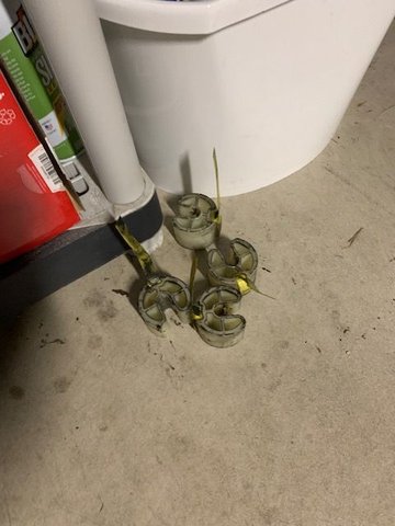

I had the same issue when I bought my 2003 two years ago. Discovered the shipping pucks where never removed when the car was shipped from the factory.

Hilarious, whbrennan. OP, that's worth checking.
