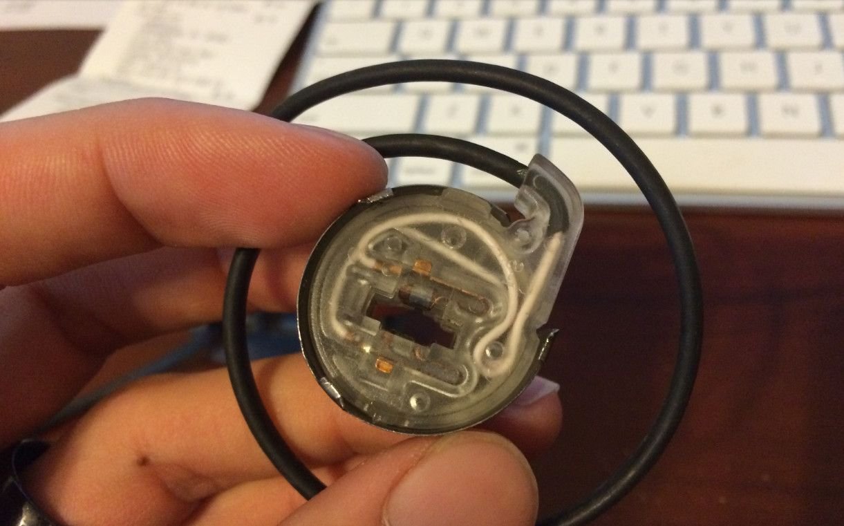

This is how the slipring "reading" the resistorvalue in the ignitionkey looks like from rear .
If the pressure from the slipring getting weaker by the years due to wear it can be a good idea to carefully bend both slipring to get a tighter pressure in the resistorelement i igition key .
Also inspect /clean the slipring surfaces carefully can be a good idea to avoid these " security problems"
Also inspect the slipring wires for damage
